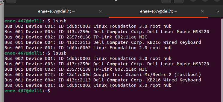

          @Moderator here is a screenshot before and after plugging the usb cable in:
          tomT 1 Reply Last reply Reply Quote 0
          • tomT
            tom admin @claw
            @claw It looks as though the board is booting into fastboot. At this point you should be able to install the voxl2_SDK with ./install.sh

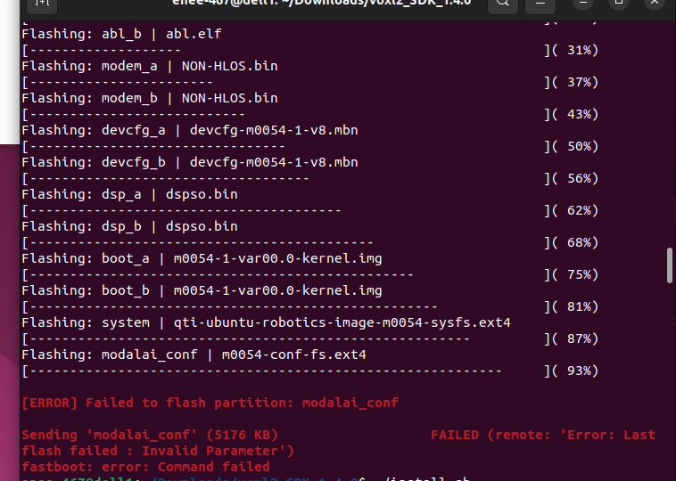

                @tom I tried to install the SDK but it failed.
