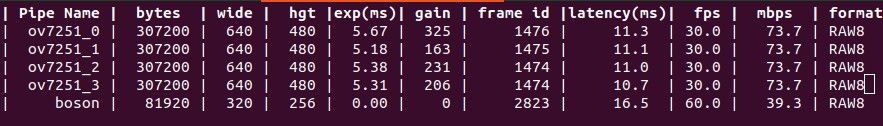

    The setup worked exactly as you described above in the table.
    All 5 AR0144 are running sync'ed, i installed R5 in M0173 in order to patch through the sync line to camera in slot 1 (which also uses the alt slave id 0x20). The camera plugged into slot 1 has the resistor swap to make it 0x20. I have not tested the software SID remap, that will be next.
    I only have Boson320 at the moment, so that's what I tested, but Boson640 will work just as well. Lepton and Boson can run concurrently, so we have 7 cameras there.
    No frame losses, sync works
    output of voxl-inspect-cpu while running voxl-inspect-cam for the 7 streams (no voxl-portal).
    Do you have all the hardware needed to try this? if you just have M0173 without the resistor fix, you can run cam 1 without sync just for initial test.
