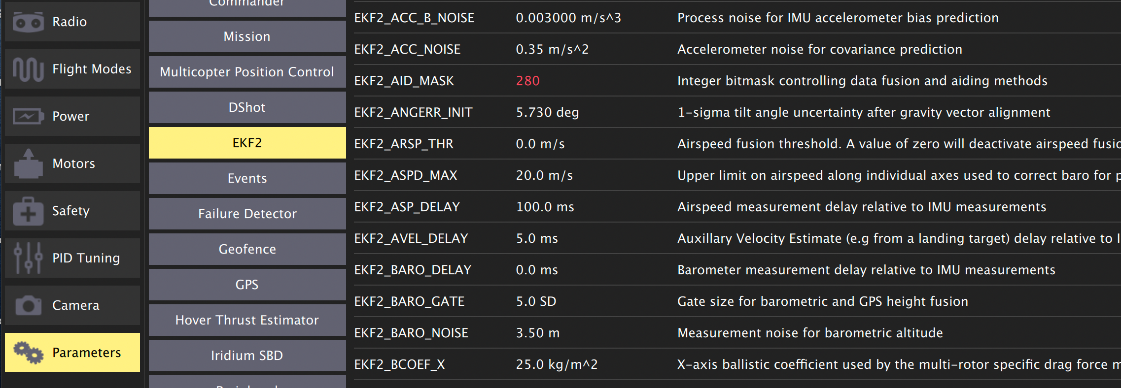

                          I just made a test and uploaded the log to this link: https://review.px4.io/plot_app?log=94b707d4-8deb-4f32-84fe-f102c8d243b1
                          And the value of EKF2_AID_MASK is 280 during the test:

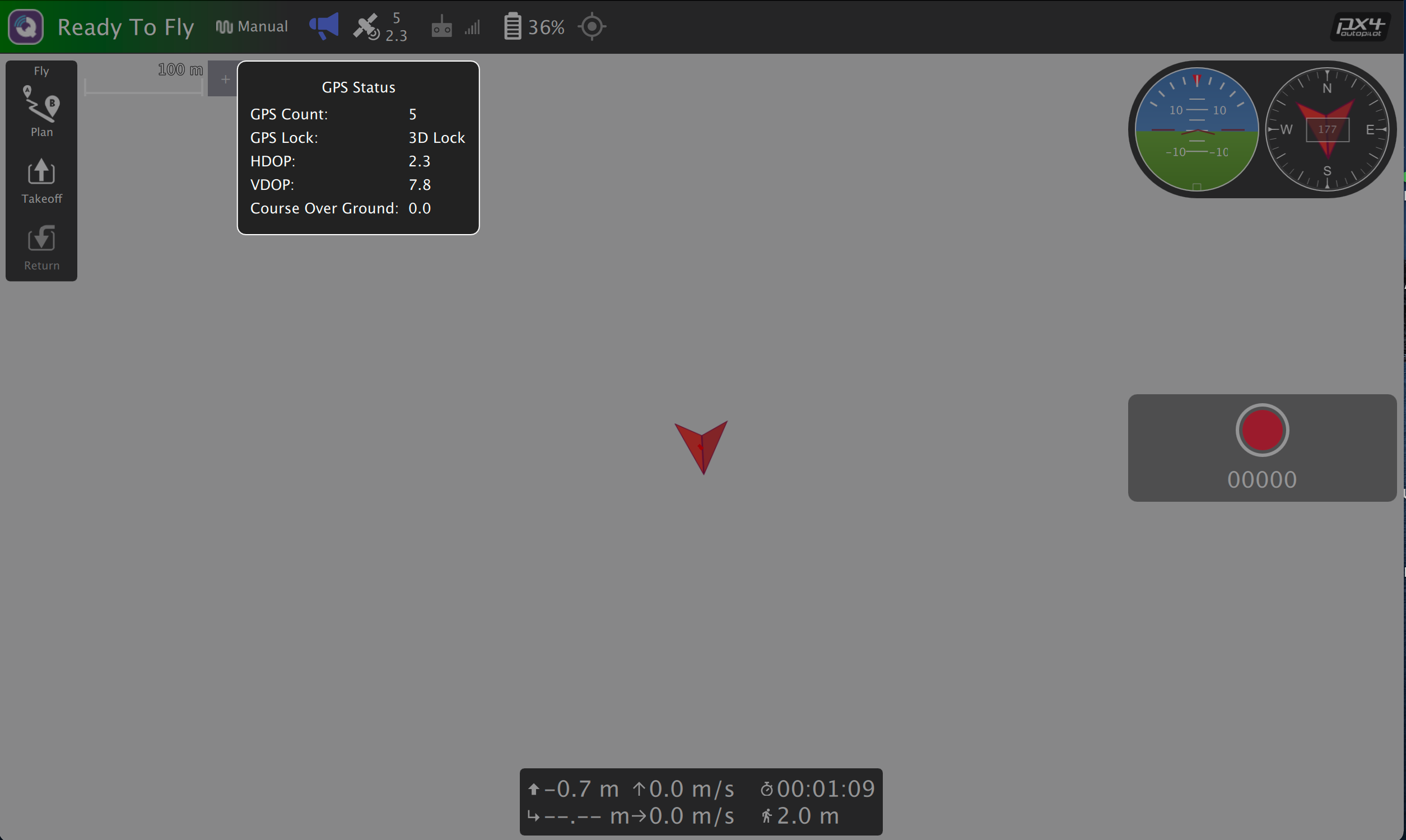

                          For this time, it seems the drone gets a GPS lock (after flying 40-50s), but QGC couldn't show the map.
                          However, it seems the sensor status is still showing that GPS has an error.

                            Great, looks like the GPS is now working 🙂
                            This document is helpful for a few m500 things: https://docs.modalai.com/voxl-m500-getting-started/
                            If you would like to use GPS for position flight, you'll need to update the parameters, especially ekf2_aid_mask, which should be set to 1. You can use the helpers here to load the correct value for outdoor setup: https://gitlab.com/voxl-public/flight-core-px4/px4-parameters/-/tree/master/helpers/m500
                            If you're indoors, it's possible the GPS may get a fix, but still have a large error in vertical or horizontal speed.
