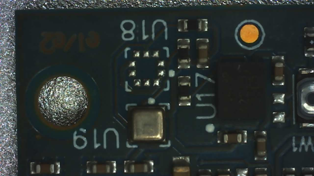

                Could you verify that this issue is due to missing sensor at U18 port c52abe21-3536-4362-8a36-86faf76b4a5c-image.png
                  Alex Kushleyev ModalAI Team @Jetson Nano
                  @Jetson-Nano , the boot issue is not related to the missing U18 (which is a secondary barometer, which was removed from the revised VOXL2 design a while ago (in M0154 revision of the VOXL2 board). The sensor was not used. https://docs.modalai.com/voxl2-onboard-sensors/#barometers
                  I will double check with the team how to proceed in your case.
