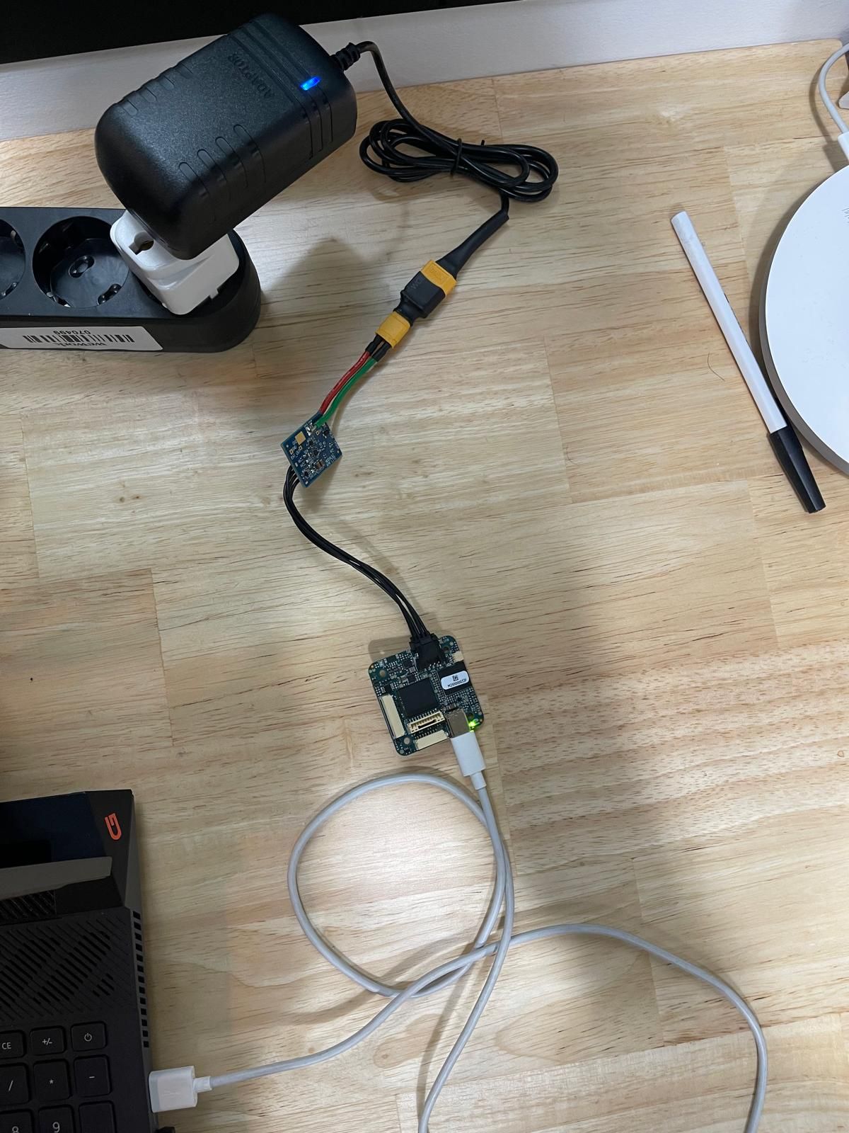

      @Ashish-Kumar Can you post a picture of your hardware setup so I can verify all looks normal?
      Ashish KumarA 1 Reply Last reply

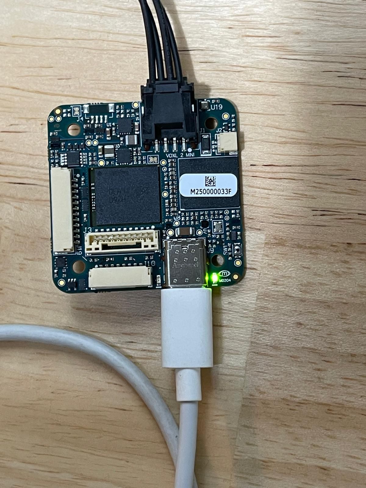

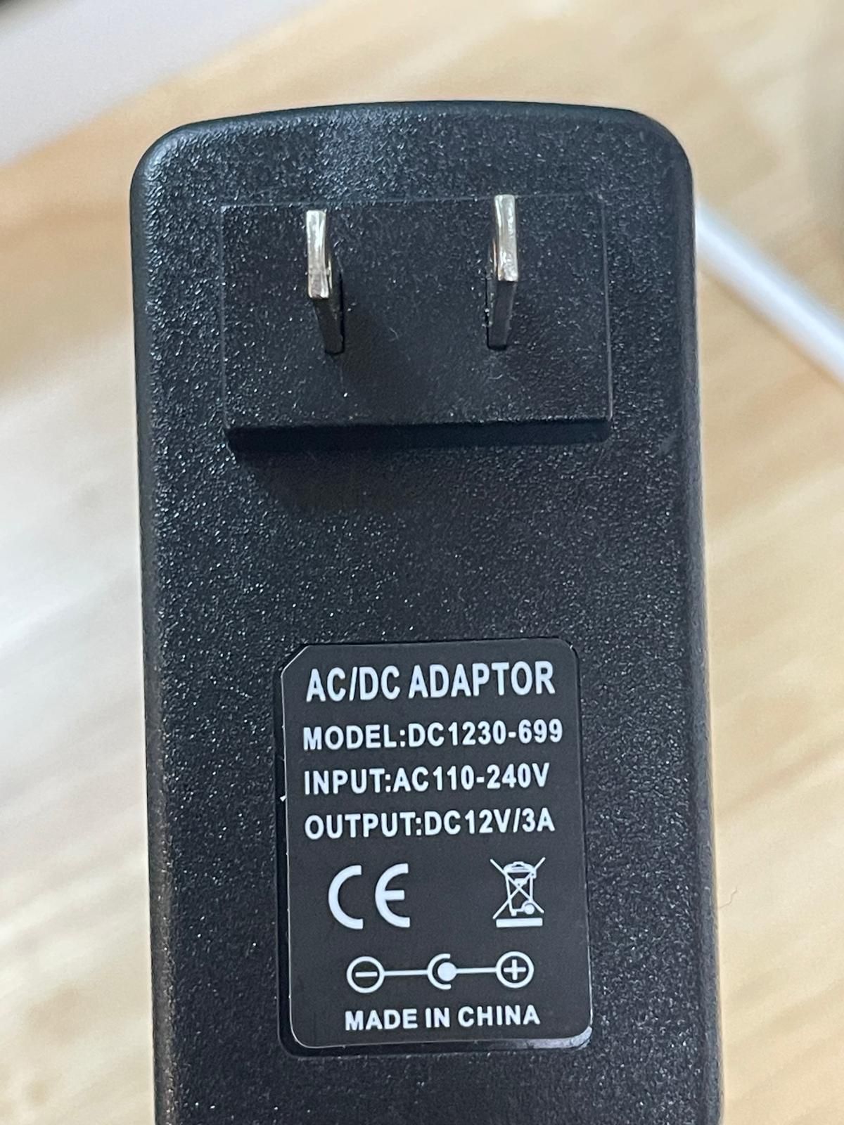

        @tom Thank you for your response. I’ve attached the pictures of your hardware setup for your review.

              @Ashish-Kumar
              With ONLY USB-C, the board will not boot, so that is normal behavior.
              VBAT is always required.
              D1 (Green LED) says the VBAT is present and our local 3.3V is ON.
              With just that LED on, it tells me your board is likely stuck in QDL mode and needs reflashing, so the steps Tom provided will help confirm that.

                  @Ashish-Kumar
                  Few things:
                  1. Please stop trying with only USB-C, that is invalid. Think of this as your smartphone... there is always a battery present (our power module) before you insert a USB-C cable.
                  2. Please remove USB-C, Plug in the power module when it is OFF, then turn the power module ON.., then insert the USB-C cable. Our Hardware is not hot-swappable. Only USB ports can tolerate an active host connection, but all power supplies must be OFF when plugged in, then turned ON.
                  3. Your power module was delivered with clear heatshrink. What happened to it? That would not be a covered RMA since the HW of the power module is now compromised.
                  4. Can you confirm if you have tried multiple USB cables and multiple ports on your PC? (or even another PC?). We often see that fix some folks issues, either a lose cable or bad port... happens more than you would think.
                  After those steps are confirmed, then I think @tom can guide you further.

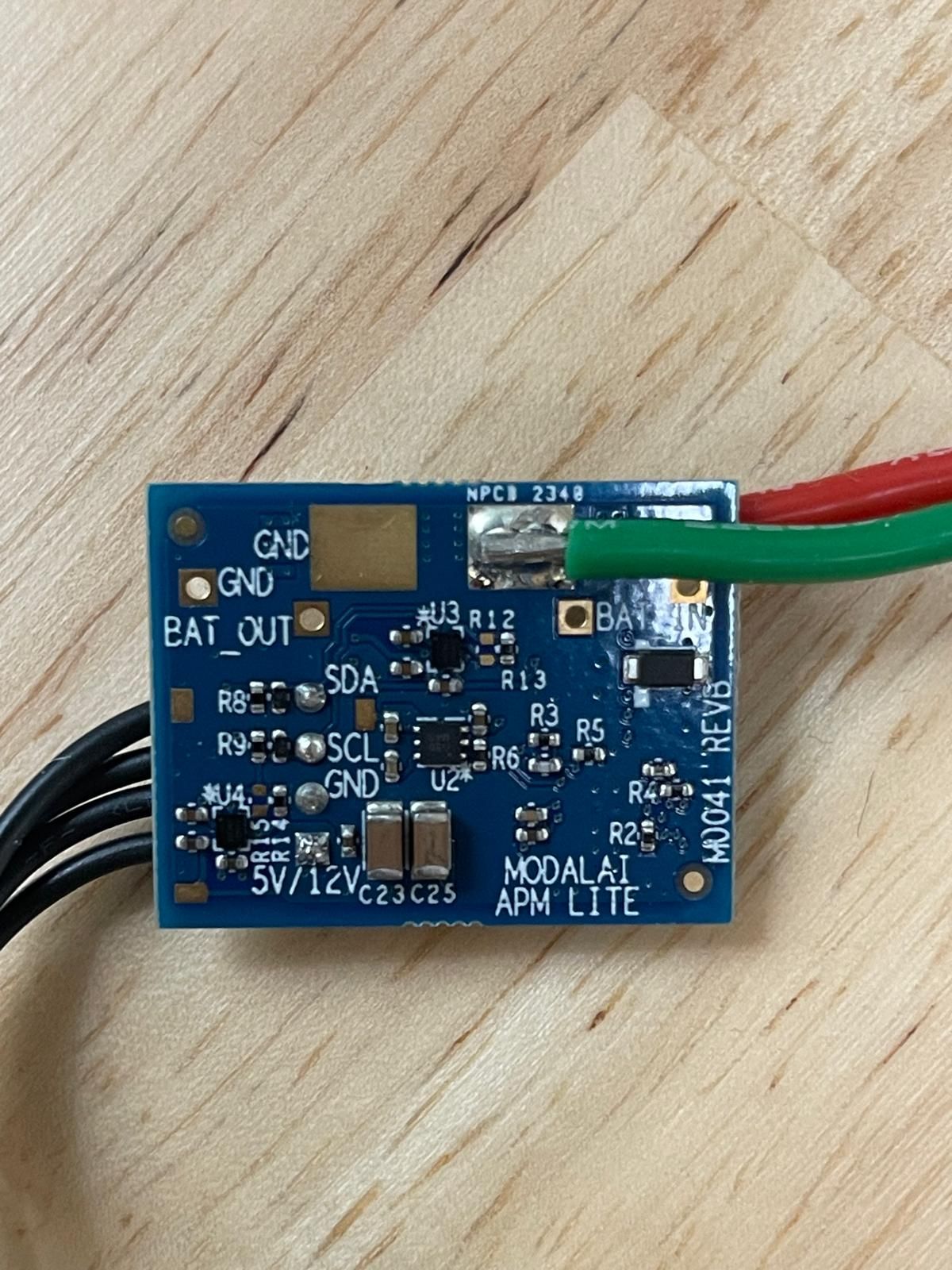

                    @Vinny Thank you for your support.
                    Regarding the power module: I did not modify it. I received it exactly in this condition. I have not opened or altered the module.
                    I have tried all the recommended steps including powering with the module off -> then ON -> then inserting USB-C, as well as using different laptops, different USB cables, and different ports on both Windows and Ubuntu, but the issue still remains the same.
