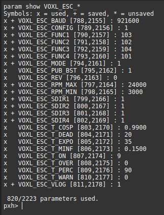

      @Eric-Katzfey Also, there is a parameter called VOXL_ESC_T_ON. How is that set? It determines which button will be used for turtle mode. The code is here: https://github.com/modalai/px4-firmware/blob/ea098200d3c09b7af548bf7be29fda245fad8f17/src/modules/mavlink/mavlink_receiver.cpp#L2083
      Jetson NanoJ Offline
      Jetson Nano
      Veteran
      wrote on last edited by Jetson Nano
      @Eric-Katzfey I am not able to see the option you have mentioned VOXL_ESC_T_ON
      Eric KatzfeyE 1 Reply Last reply
      • Jetson NanoJ Jetson Nano
        Eric KatzfeyE Online
        Eric Katzfey
        @Jetson-Nano said in doodle labs and joystick setup:
        In the Mavlink console what do you see with "param show VOXL_ESC_*"?
        And what about "ver all"?

              @Eric-Katzfey Hey hope you are doing fine, I checked the code and various branches of PX4, I noticed I was able to see the parameter VOXL_ESC_T_ON but the option only showcased button 1 for assignment . what to do if I want to assign another button.
                Eric Katzfey

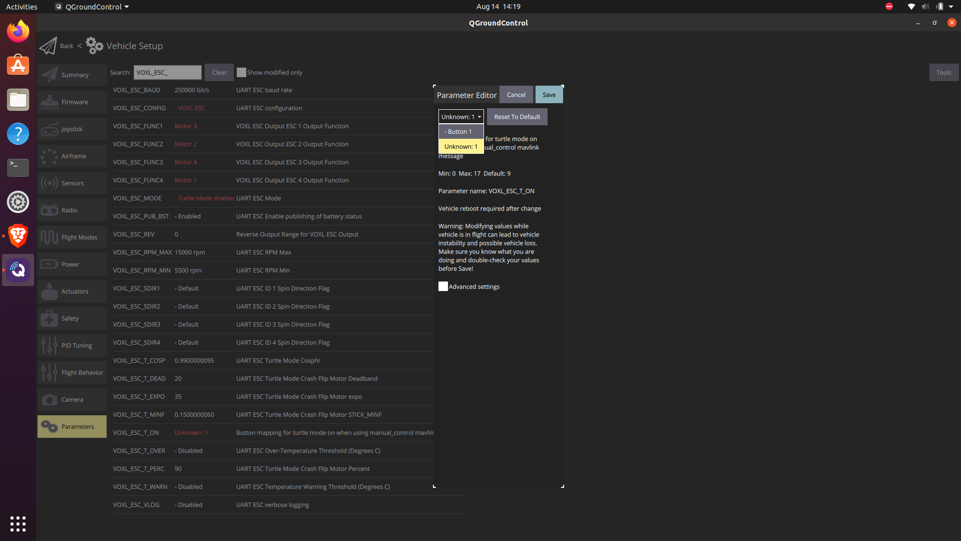

                @Jetson-Nano You set that parameter to match the button you want to use.
                Jetson NanoJ 1 Reply Last reply

                    @Jetson-Nano It's a parameter that you can set to any number you want. In QGC you can look at the joysticks tab and see as you press each button which number it is. Then set the parameter to that number.

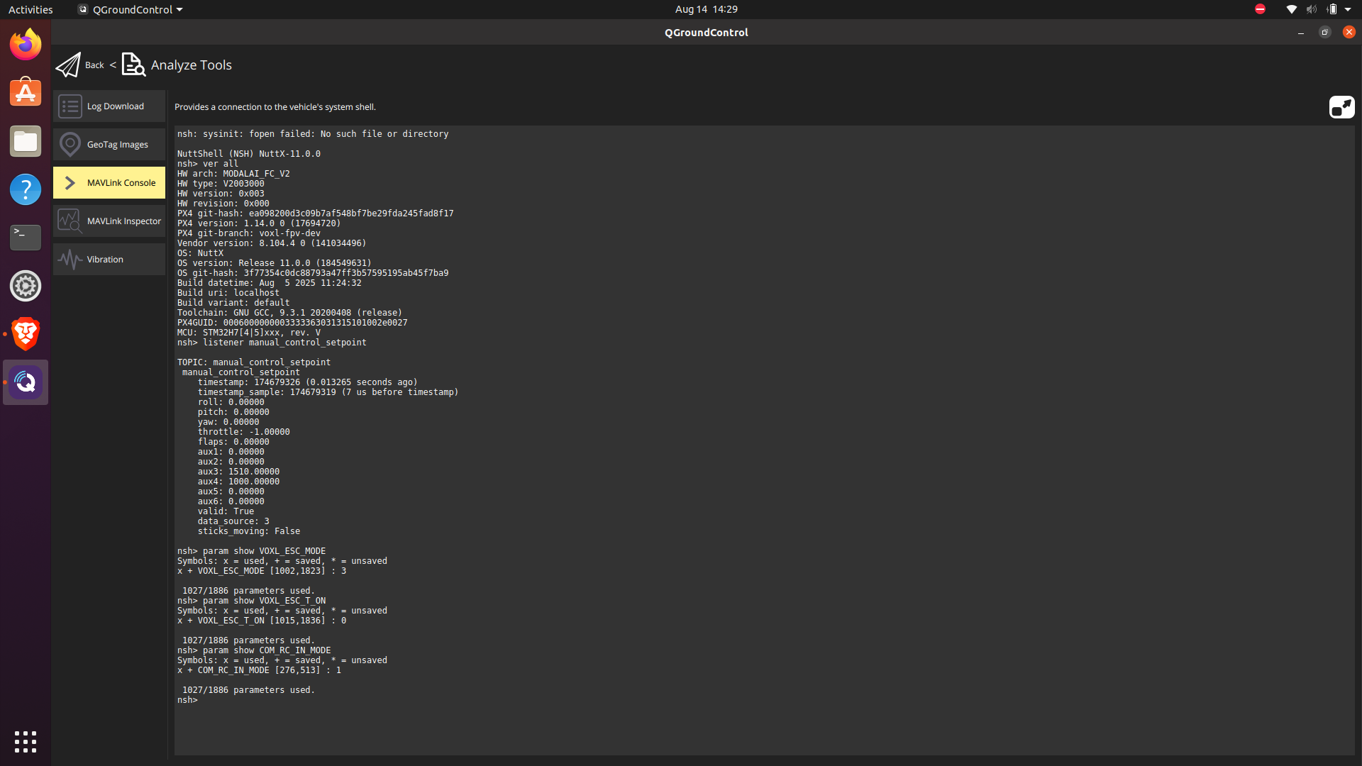

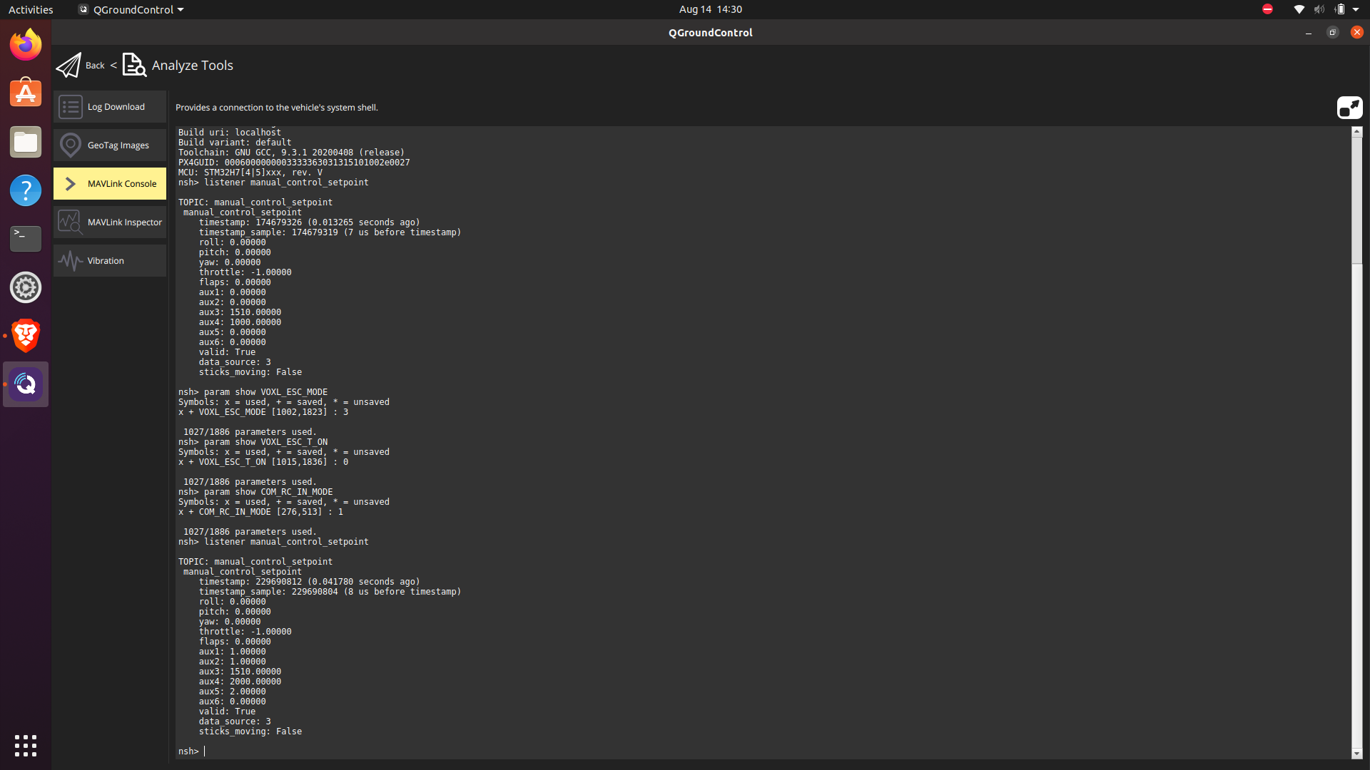

                              @Eric-Katzfey

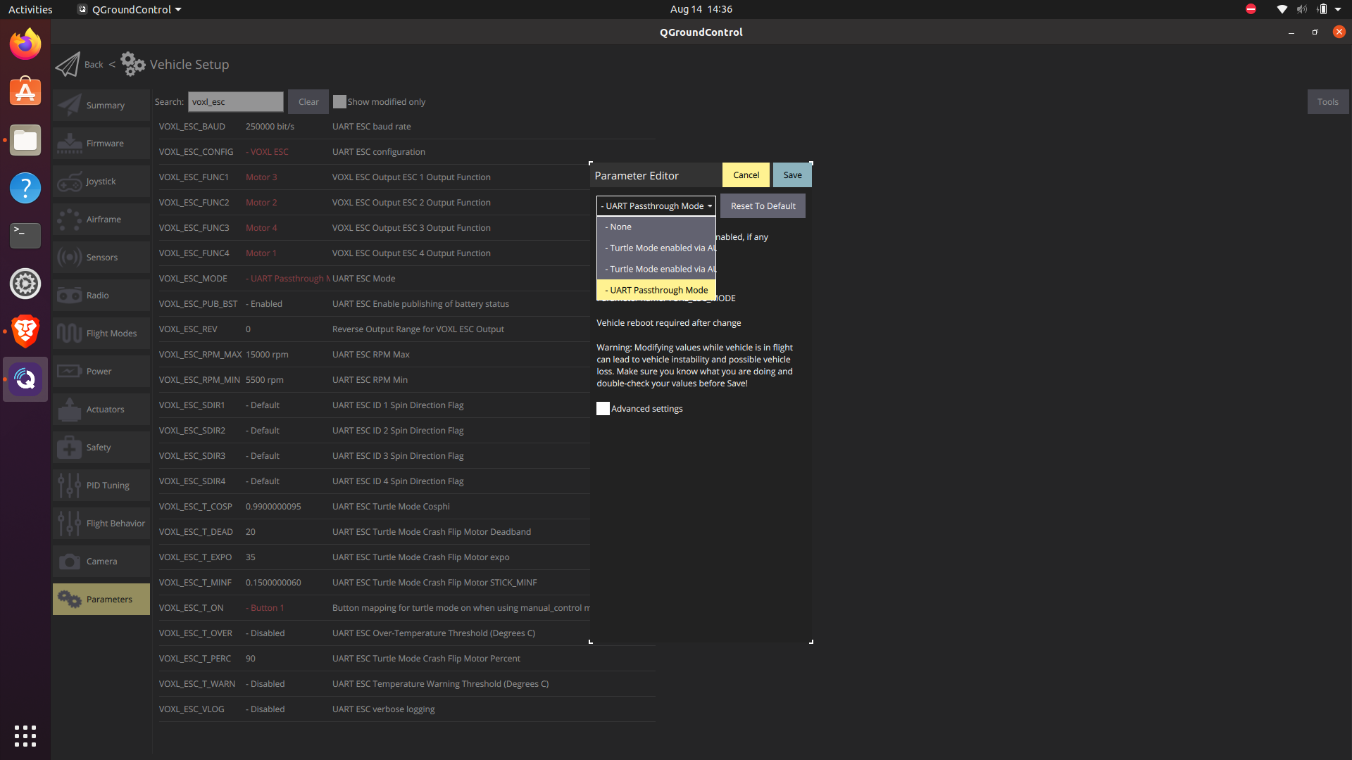

                              I followed the steps you suggested, i am attaching the Screenshots. I tried what you suggested the result is still the same, I am not able to arm the system. I tried with various options for VOXL_ESC_MODE, still the same.
                              I clicked the assigned button here, AUX 1 values are changing but only when i keep the voxl_ESC_MODE to UART passthorugh

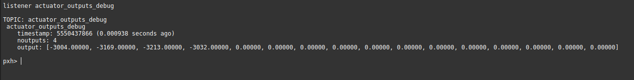

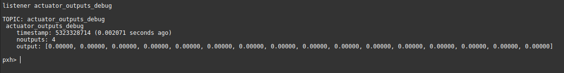

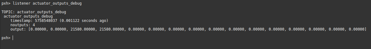

                                #25
                                @Jetson-Nano Here are the steps I am using for testing. Here are my VOXL_ESC parameters:
                                My VOXL_ESC_BAUD is set non-standard because I am using an ESC simulator. I have flight mode set to altitude mode. If I check the ESC commands I see no output:
                                Then I arm and check ESC commands and see values:
                                Then I disarm, press button 9, arm, move both sticks around and see these ESC commands:
                                Notice that most motors are 0 except for 1 or 2 and are of opposite sign than normal. In this case pitch was centered and roll was full right. Hope this helps.
                                Jetson NanoJ 2 Replies Last reply

                                      The major issue still is there, When i try to arm the system by keeping it facing down or in an angle, the drone is not accepting the command and is not arming.
                                      I am attaching screenshot for your reference.
                                      Please help me out here. I am using the px4 firmware version 1.14.0 dev 8.104.4
                                      Since it is working when I keep it straight and arm, I feel there is something wrong in the logic somewhere or in the parameters.

                                        Hey @Eric-Katzfey ,
                                        sorry for the late reply, I tested it out by keeping the drone straight and enabling turtle mode, it is working. I should also press both the turtle mode button and arm button together to get it working.
                                        Eric Katzfey
                                        #29
                                        @Jetson-Nano I'm sure it is related to your parameter settings. Take a look at our parameter settings for FPV drones and compare against what you are using: https://gitlab.com/voxl-public/voxl-sdk/utilities/voxl-px4-params/-/blob/dev/params/v1.14/platforms/D0008_v5.params?ref_type=heads
                                        • Eric KatzfeyE Eric Katzfey
                                          Jetson Nano
                                          Veteran
                                          #30
                                          @Eric-Katzfey Thank you for reverting back, I am able to get the turtle mode working now, The error was due to the safety parameters, once i changed it to the FPV setup, it was working.
                                          Once again thank you for the support. It was really helpful.
