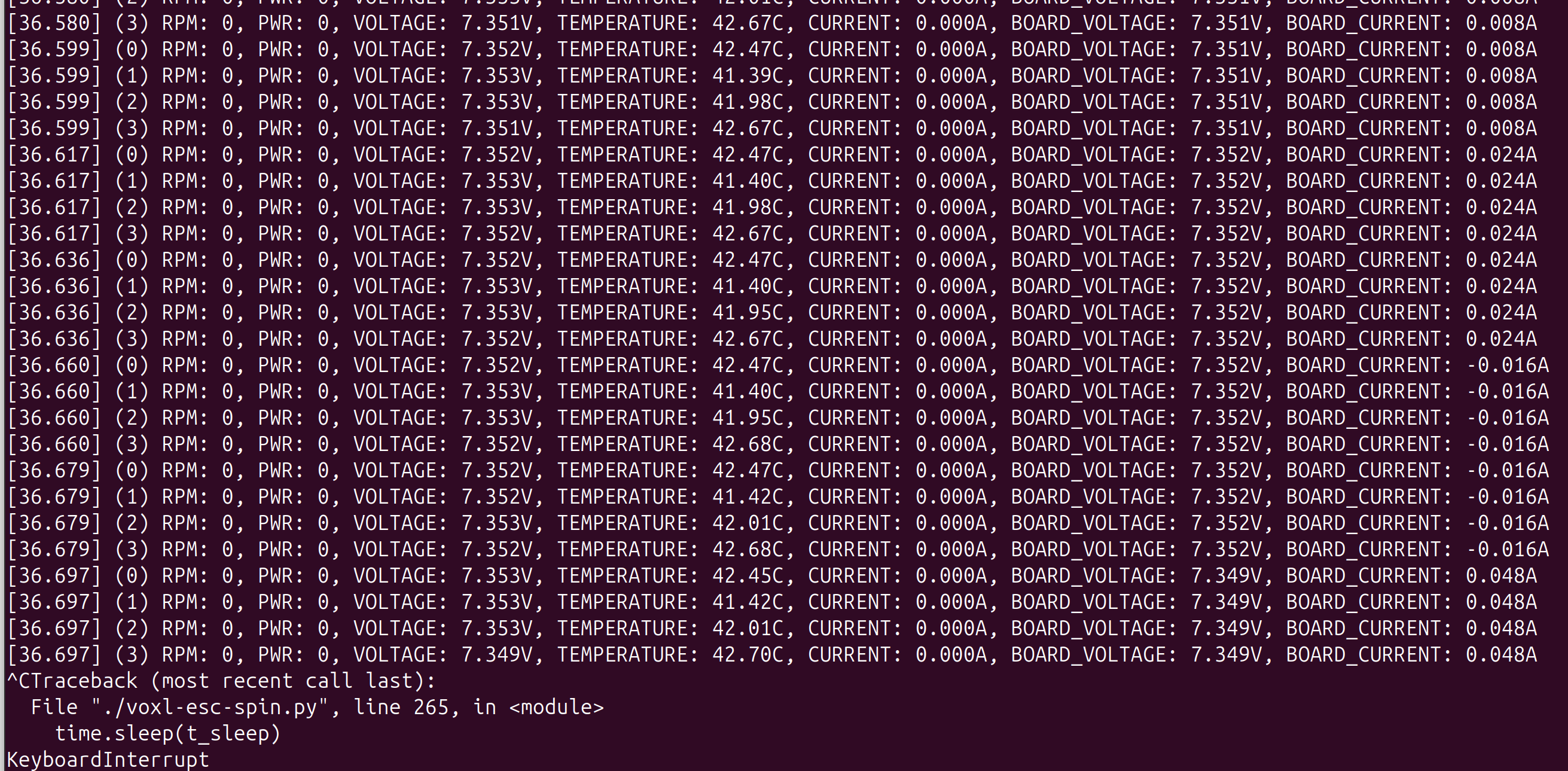

                              @Alex-Kushleyev I followed the steps. The ESC was detected in the scan:
                              and the run command executed as:
                              My power supply is at 7.4V since I intend to power the drone with 2S pack. In idle, the power supply shows ~132mA and during the spin test the power supply showed 135mA - 148mA.
                              • Also the power output is 5V at the ESC when VOXL2 is connected.
                                Alex Kushleyev ModalAI Team @h3robotics
                                @h3robotics , OK great, so far it seems like everything is working properly. The M0129 current sensing is accurate to within few hundred mA (because the range is very large, up to 100A+), so it is OK that it is not quite matching up with the 135mA actual current draw.

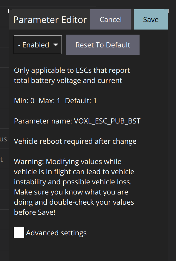

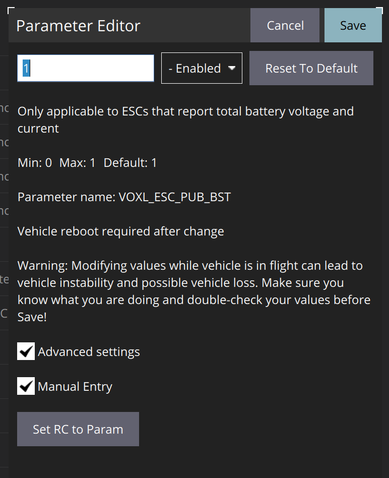

                                      @Eric-Katzfey VOXL_ESC_PUB_BST = Enabled and px4-listener battery_status gives "never published".
                                        @h3robotics , did you set VOXL_ESC_PUB_BST to 1? it should be a 0 or 1, not "Enabled". please double check.
                                        h3roboticsH 1 Reply Last reply Reply Quote 0
                                        • h3roboticsH
                                          h3robotics @Alex Kushleyev

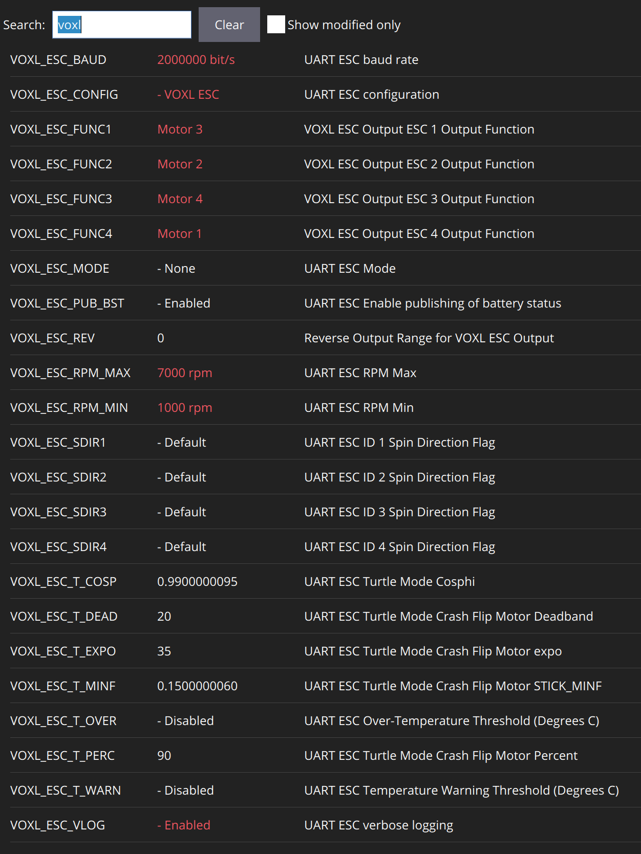

                                          @Alex-Kushleyev No, it was default. I am using the latest QGround Control. Here are some images of the parameters.
                                          All voxl related parameters:
                                          VOXL_ESC_PUB_BST:
                                          I also double checked using manual entry:
                                          Let me know if that helps.
                                            @h3robotics , I see, thanks for clarifying.
                                            Is the ESC detected by PX4? What you can do is stop the px4 service using systemctl stop voxl-px4 and then run the px4 in a terminal : voxl-px4 -d , this will start px4 with an interactive px4 shell. You can also see debug prints from different modules that are starting up. Look for the voxl_esc module, it should say whether it was able to detect the ESC and, if so, then it will print some information about the ESC, such as its type, firmware version, etc.
                                            If the ESC is not detected, then you may have ESC parameters set up for incorrect baud rate (your PX4 params expect 2mbit, but perhaps your ESC is using lower bit rate, so you can update your ESC params to 2mbit). It is possible that your ESC is using 250K baud rate which is what it may ship with, so you can try 250K in PX4 to test that. If your ESC is set up for the lower bit rate, i would suggest updating that to at least 921600, or 1mbit or 2mbit in order to reduce delay and support the throughput for the ESC commands and telemetry.
