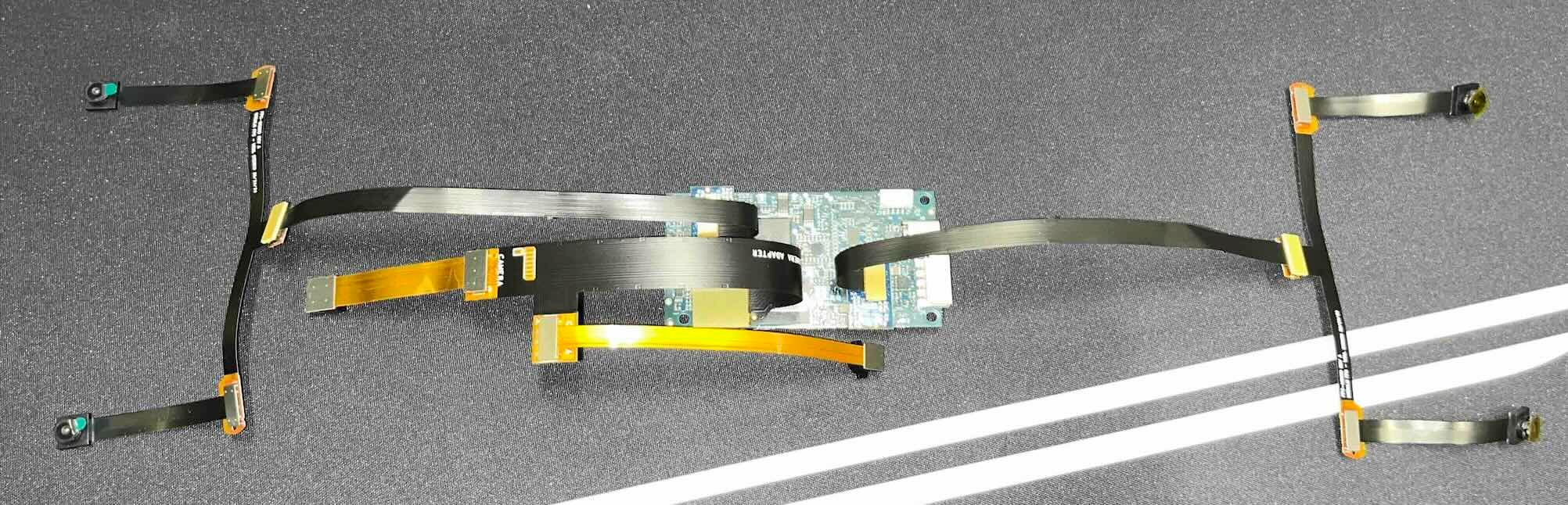

        @robertociuch , ok, got it, so basically two stereo pairs is what we can address first.
        For stereo pairs, i think there is some issues due to additional length of stereo splitter and the flex connected to the ov7251 cameras. So that is why lowering the mipi rate is needed.
        Regarding IMX412, we have some flexibility in modifying the MIPI transfer rate as well, but lowering it may affect maximum resolution / fps (depending on what resolution / fps you need). IMX412 does work with our M0036 extension flex (14.5cm). We can discuss what you need after sorting out the stereo pairs. However, please try your new flex as well to see if it just works out of the box.
        Lets do the following: i can share modified camera drivers for the stereo pairs, so you can test and confirm that it works and then I will discuss internally how to make them available in our standard release. I'll follow up later today or tomorrow morning.

                  @robertociuch
                  I started testing a single stereo pair (front), plugged in to J6 and it works with a single M0036 extension (14.5cm). I tried two different M0036 cables. I am using SDK 1.3.0.
                  In the original post of this thread, i mistakenly thought that the user was trying to connect TWO M0036 extenders back to back and that does not work unless the mipi rate is lowered. But the single M0036 seems to work fine.
                  Can you please provide some more details about your test:
                  • SDK version that you are using
                  • what camera configuration option do you select when setting up camera configs
                  • does the same configuration work with shorter flexes? (M0074)
                  • can you try to enable only one stereo pair at a time (disable all the other cameras in voxl-camera-server.conf) and see if front stereo works and (separately) rear stereo works?
                  • does voxl-camera-server -l detect all the cameras that are physically connected to the board?

                      I tried with only one M0036 extension cable and it works, but as I connect the second pair of cameras with one more M0036 extension it starts to have some issues, the camera server sometimes starts but most of the times it doesn't, if it does I get a mixed preview of the cameras in the voxl portal, for example I want to see a preview of one pair of stereo and instead of seeing left and right cameras I see one of the front and one of the rear, and then it crashes,
                      I already tried to replace the extensions, the cameras and even the voxl with brand new pieces but that configuration doesn't work, the only way is to use the shorter extension cables M0074 on one of the stereo pair (or both), with that extension I never got any type of problem.
                      I am using the SDK 1.3.0
                      The camera preset I am using is the 11 (sentinel)
                      The camera server detects all the cameras, if I disable one of the two stereo pairs it seem to work

                        @robertociuch , I understand. Please hang in there, i will test the dual stereo configuration, each with a single M0036 extension cable. I should get back to you later today.
                          #19
                          @robertociuch , I tested the dual stereo configuration with M0036 14.5cm extensions on each stereo. Stereo pairs plugged into J6 and J8, just like Camera Configuration 11 shows (link), I unplugged all other cameras. Seems to be working fine. I am attaching the voxl-camera-server.conf file with just stereo set up. Also, i am using SDK 1.3.2, however it should be working with older SDKs. If you find that installing the longer flex is an issue, it is possible that the flex itself is problematic. You can test the stereo pairs individually to find if there is a particular cable that is bad.
                          Also, please double check that the following sensormodules (camera drivers) are present in the correct location:
                          voxl2:/$ ls /usr/lib/camera/*combo*
                          /usr/lib/camera/com.qti.sensormodule.ov7251_combo_0.bin  /usr/lib/camera/com.qti.sensormodule.ov7251_combo_4.bin
                          /usr/lib/camera/com.qti.sensormodule.ov7251_combo_1.bin  /usr/lib/camera/com.qti.sensormodule.ov7251_combo_5.bin
