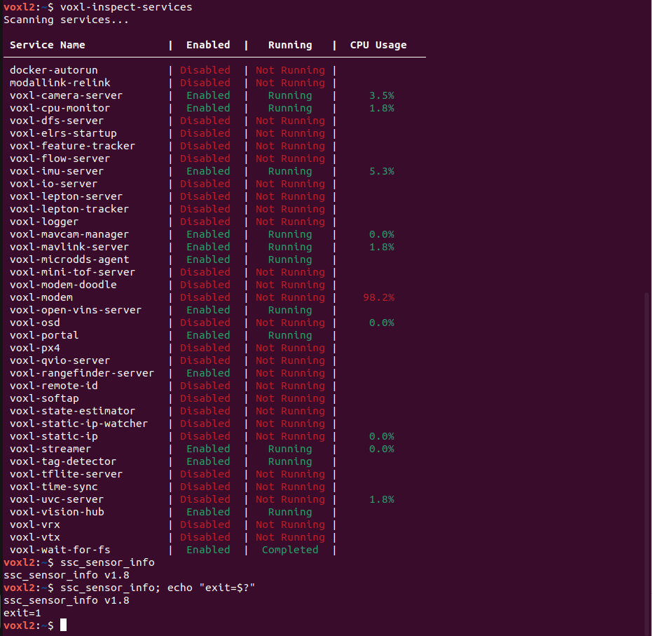

        @Moderator Thank you for your response. I have gone through the documentation several times. Even with that, I can't tell why I get those preflight check fails. Sometimes it clears, most times, I keep getting several warnings. I will go over the documentation again, maybe I am missing something.
        For instance, why do I have a cpu usage when the voxl-modem isnt running? or is that normal

          @taiwohazeez What SDK version are you running? Can you post the output of voxl-version?
          It seems as though some missing CPU stats are causing the values to by shifted by one, the 98.2% is likely from voxl-open-vins-server
