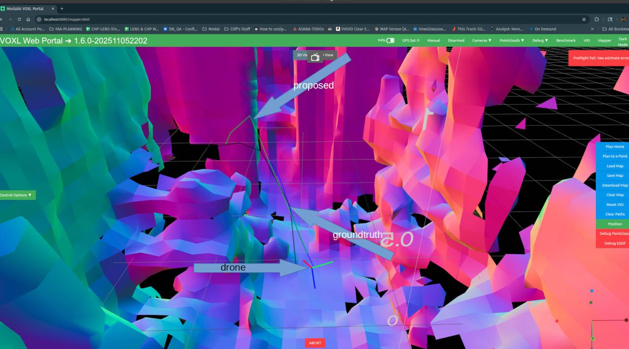

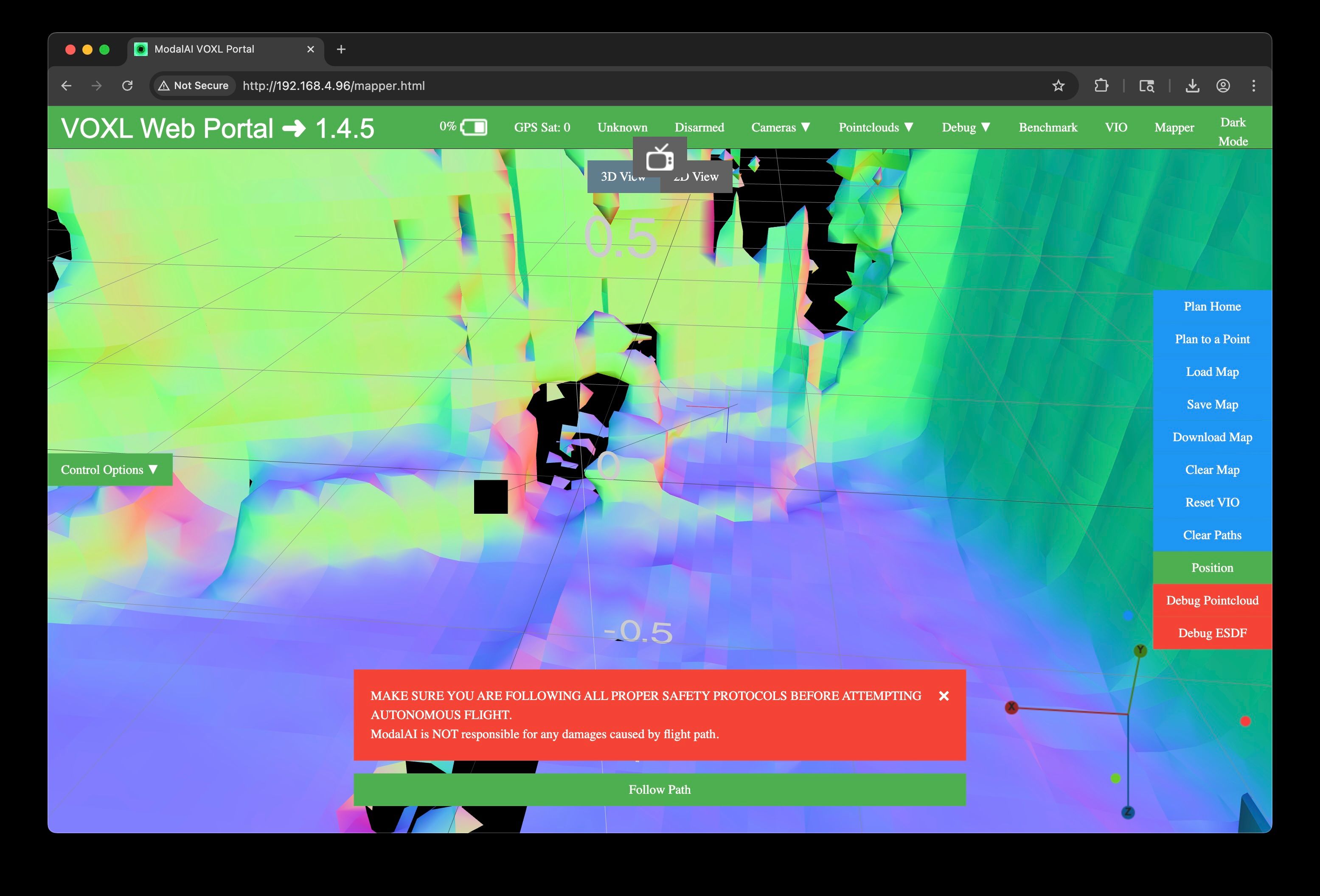

    When using the navigation of the Mapper, after plotting a location like this short route with no obstacles:
    The drone flies up into the ceiling. The position mode works well though it can drift upwards some. The drone can run the figure 8 without any issue. So far, I am not sure what the issue with the navigation once the Mapper create the route. It am afraid the drone with break itself or something else in the room. I can attempt to send videos of the fly if they would be helpful.

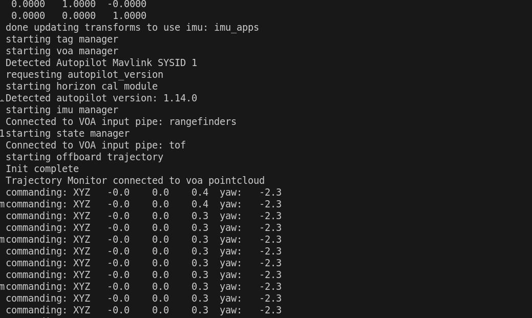

      @tom Thank you for the assistance on the previous topic. Is there a best way to diagnosis the navigation? The path appears fine, but the drone few straight upward into the ceiling before falling and breaking one of main battery clips next to the LED board.

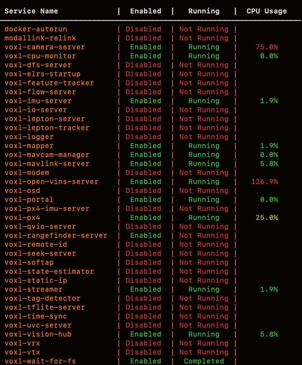

            @greg_s Hi there, can you post these 2 files from your drone:
            /etc/modalai/voxl-vision-hub.conf
            /etc/modalai/voxl-open-vins-server.conf
            One thing from your screenshot is I sort of see the drone's position and the trajectory planned. For example as in this screenshot, the drone's xyz position should be visible (xyz axes) and a trajectory (black & red lines) should be displayed before executing a trajectory. The drone should be moving in realtime hovering in position. If it's static the vio was likely lost.

              Hello @Cliff-Wong,
              Yes, I flew the drone around the room in position mode until the map was generated. I then flipped the remote to offboard with 'trajectory' set. Here are the files below:

                Hi there, looking at the files and review our analytics here since you were flying fine in position mode that says VIO was likely ok (as per you config files).
                We did have a some changes between vision-hub and px4 that make have been incompatible with the 1.4.5 version. Hence you have 2 options:
                option 1: debug & confirm either probem lies in voxl-vision-hub or PX4.
                (a) you need to ssh onto the vehicle, in the remote terminal, run:
                voxl-vision-hub --debug_offboard
                That will display streaming position data, which is the traj commands to PX4. Then you may restart/start voxl-mapper (e.g. systemctl restart voxl-mapper). In the vision-hub streaming output, you'll see a print out like Trajectory Monitor connected to voa pointcloud.
                (b) you can now switch to position mode, fly around in that mode to map as normal, then stop to hover. Draw your simple trajectory in portal and execute. Ensure the draw trajectory is within the space using the mouse and rotating around the area--portal can sometimes make the 'plan point' appear close to the drone, but it is actually very far away so you need to check at different viewing angles. When you execute the plan, the streaming output in the vision-hub display above should reflect the drawn trajectory. In both your example and mine, the Z position output should stay relatively close to the current. If it rises, we have a trajectory calculation problem (drone is doing what it's told). If it rises while the position data is fairly minimal, then PX4 likely has failed (VIO or dropped out of offboard mode). Please try this and report back. We suspect VIO may have failed. Here's a example of the output:Screenshot from 2025-11-20 12-21-29.png
