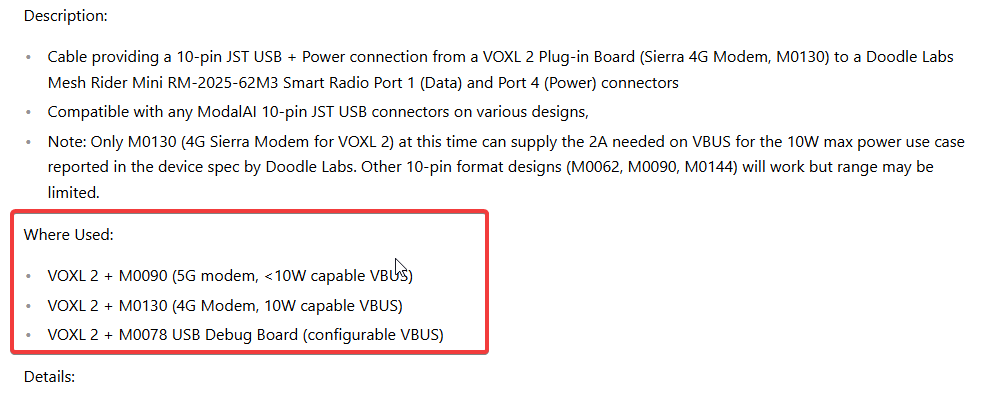

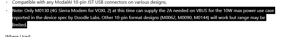

          @will-huang-oksi Take a look here at MCBL-0085: https://docs.modalai.com/cable-datasheets/#mcbl-00085
          The add-on board you're using it not capable of providing enough power for the doodle modem and this may be the cause of your issues.
          tomT 1 Reply Last reply

                Hi @will-huang-oksi
                That board was not designed for 8W support.
                Please use the suggested products for Doodle Labs products. As you see, it creates uncertainty and questions we cannot easily answer without a full investigation and analysis in our labs.

                    Hi @will-huang-oksi
                    Sorry there is not much else I can offer. I'd need to have the HW in my hands to diagnose.
                    I'd start with the basics, Power. It is possible you blew the VBUS protection circuit that feeds J3 VBUS. It is also possible that GPIO_157 which enables VBUS on J3 is not correctly set in SW.
                    However, I still ask you discontinue use of M0151 for Doodle as you will have problems in the future and we cannot continue to support that.
                    Please follow the guidance listed in our cable page for Doodle. Those boards listed do not use the "VBUS" from J3 (rather we power switch the 5V DC Local with proper Hub monitoring), so you can likely recover proper functionality and continue with your efforts.
