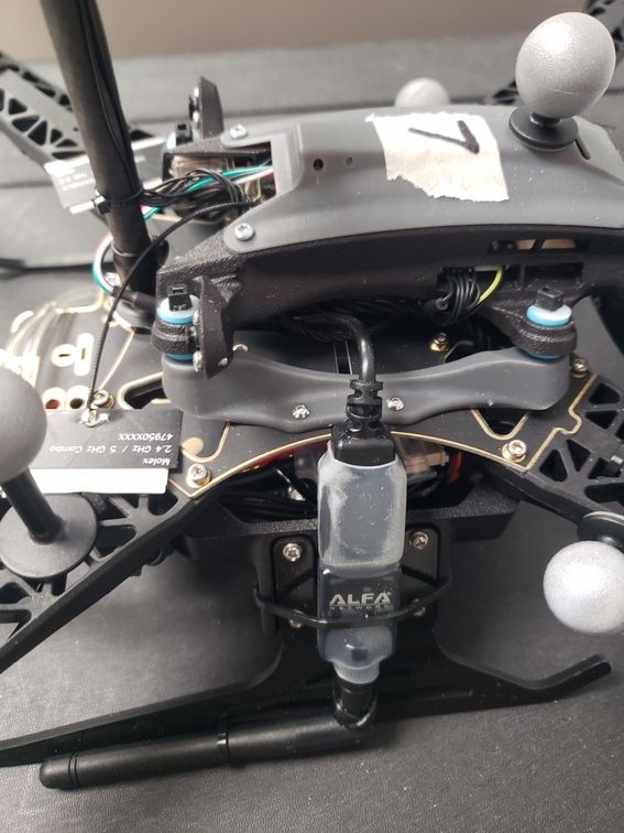

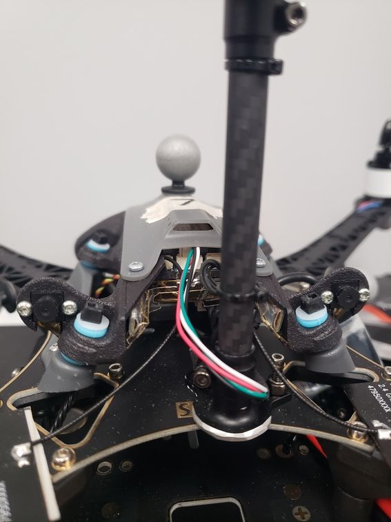

      I have multiple Sentinels with microhard add-on boards and wifi adapters connected to the USB peripheral port on the microhard carrier board (not custom, this is how they were shipped). Wifi is working without issue on 3/4 of the vehicles, but for one of the vehicles the wifi adapter is either never recognized after booting up or it is detected and works for a few minutes but then disconnects and will not reestablish a connection.
      I used the instructions here to configure dhcpcd to set a static ip adress for the wlan0 interface for all the vehicles:
      https://forum.modalai.com/topic/4105/instruction-to-set-a-static-ip-for-wlan0-voxl2
      It works without issue for the other vehicles so I don't think it's part of the problem. I've attached the output of dmesg following a boot experiencing these issues and filtered the output for lines that contain "usb". You can see the wifi adapter is detected around 7 seconds after boot, the microhard interface is detected around 26 seconds after boot, but around 281 s after boot the wifi adapter starts diconnecting and can't be enabled.
      Can me someone help me troubleshoot this? I'm assuming at this point since the configurations are the same on all the other vehicles that this is most likely a hardware issue. How can I confirm whether it is or not?

      [    6.500946] usb 1-1.4: device not accepting address 6, error -71
      [    6.501376] usb 1-1-port4: unable to enumerate USB device
      [    6.921975] usb 1-1.4: new high-speed USB device number 7 using xhci-hcd
      [    7.029686] usb 1-1.4: New USB device found, idVendor=0bda, idProduct=0811, bcdDevice= 2.00
      [    7.029695] usb 1-1.4: New USB device strings: Mfr=1, Product=2, SerialNumber=3
      [    7.029700] usb 1-1.4: Product: 802.11ac WLAN Adapter
      [    7.029705] usb 1-1.4: Manufacturer: Realtek
      [    7.029709] usb 1-1.4: SerialNumber: 00e04c000001
      [    7.274284] usb 1-1.4: 88XXau 00:c0:ca:b5:ab:9c hw_info[107]
      [   26.444557] usb 1-1.2: new high-speed USB device number 8 using xhci-hcd
      [   26.534908] usb 1-1.2: New USB device found, idVendor=1f94, idProduct=3002, bcdDevice= 4.14
      [   26.534925] usb 1-1.2: New USB device strings: Mfr=1, Product=2, SerialNumber=3
      [   26.534934] usb 1-1.2: Product: pMDDL2450AES256
      [   26.534942] usb 1-1.2: Manufacturer: Microhard
      [   26.534951] usb 1-1.2: SerialNumber: 1592348
      [   26.634655] rndis_host 1-1.2:1.0 usb0: register 'rndis_host' at usb-xhci-hcd.0.auto-1.2, RNDIS device, 06:f2:15:a9:a5:b2
      [  281.219466] usb 1-1.4: USB disconnect, device number 7
      [  281.515539] usb 1-1.4: new high-speed USB device number 9 using xhci-hcd
      [  281.605319] usb 1-1.4: New USB device found, idVendor=0bda, idProduct=0811, bcdDevice= 2.00
      [  281.605329] usb 1-1.4: New USB device strings: Mfr=1, Product=2, SerialNumber=3
      [  281.605333] usb 1-1.4: Product: 802.11ac WLAN Adapter
      [  281.605337] usb 1-1.4: Manufacturer: Realtek
      [  281.605341] usb 1-1.4: SerialNumber: 00e04c000001
      [  281.932340] usb 1-1.4: 88XXau 00:c0:ca:b5:ab:9c hw_info[107]
      [  297.859348] usb 1-1.4: USB disconnect, device number 9
      [  298.159693] usb 1-1.4: new high-speed USB device number 10 using xhci-hcd
      [  298.249415] usb 1-1.4: New USB device found, idVendor=0bda, idProduct=0811, bcdDevice= 2.00
      [  298.249426] usb 1-1.4: New USB device strings: Mfr=1, Product=2, SerialNumber=3
      [  298.249432] usb 1-1.4: Product: 802.11ac WLAN Adapter
      [  298.249437] usb 1-1.4: Manufacturer: Realtek
      [  298.249442] usb 1-1.4: SerialNumber: 00e04c000001
      [  298.574671] usb 1-1.4: 88XXau 00:c0:ca:b5:ab:9c hw_info[107]
      [  300.419153] usb 1-1.4: USB disconnect, device number 10
      [  300.684351] usb 1-1.4: new high-speed USB device number 11 using xhci-hcd
      [  301.534222] usb 1-1-port4: Cannot enable. Maybe the USB cable is bad?
      [  301.607787] usb 1-1.4: new high-speed USB device number 12 using xhci-hcd
      [  302.440236] usb 1-1-port4: Cannot enable. Maybe the USB cable is bad?
      [  302.440408] usb 1-1-port4: attempt power cycle
      [  303.580855] usb 1-1-port4: Cannot enable. Maybe the USB cable is bad?
      [  304.428990] usb 1-1-port4: Cannot enable. Maybe the USB cable is bad?
      [  304.430266] usb 1-1-port4: unable to enumerate USB device

        I just disconnected/reconnected the USB to 4-pin JST cable from the microhard carrier board and rebooted the vehicle. Now the wlan0 interface has been up the entire time the vehicle's on, but none of the other devices on the vLAN the wifi adapter is connected to can ping the vehicle over wifi.
        Output from dmesg looks the same except the following output after the microhard interface is found:
        [   26.460342] usb 1-1.2: new high-speed USB device number 4 using xhci-hcd
        [   26.550901] usb 1-1.2: New USB device found, idVendor=1f94, idProduct=3002, bcdDevice= 4.14
        [   26.550915] usb 1-1.2: New USB device strings: Mfr=1, Product=2, SerialNumber=3
        [   26.550922] usb 1-1.2: Product: pMDDL2450AES256
        [   26.550929] usb 1-1.2: Manufacturer: Microhard
        [   26.550935] usb 1-1.2: SerialNumber: 1592348
        [   26.639101] rndis_host 1-1.2:1.0 usb0: register 'rndis_host' at usb-xhci-hcd.0.auto-1.2, RNDIS device, 16:4f:08:e4:e1:09
        [   26.643401] cdc_acm 1-1.2:1.2: ttyACM0: USB ACM device
        [   33.765387] vdd_tof: disabling
        [   33.765393] vdd_hap_boost: disabling
        [   37.240138] hrtimer: interrupt took 112083 ns
        [  101.412343] boot log copy done
        [  114.937520] qcom_rpmh DRV:apps_rsc TCS Busy, retrying RPMH message send: addr=0x41b08
        [  233.747906] perf: interrupt took too long (2778 > 2500), lowering kernel.perf_event_max_sample_rate to 72000
        [  339.990578] perf: interrupt took too long (3473 > 3472), lowering kernel.perf_event_max_sample_rate to 57500
        [  386.060248] perf: interrupt took too long (4425 > 4341), lowering kernel.perf_event_max_sample_rate to 45000
        J 1 Reply Last reply Reply Quote 0
        • J
          jmltt @jmltt
          @jmltt This is still a problem. I reverted the changes for static IP set-up and am just using DHCP so the settings are the same as how the quad was shipped. Still getting cannot enable, usb cable bad? messages after the wifi adapter if recognized on start-up. I'm hoping the the wifi adapter or cabling is just bad and not the port on the carrier board.
          [    2.361738] usbcore: registered new interface driver 8188eu
          [    2.447119] usbcore: registered new interface driver rtl8821cu
          [    2.499469] usbcore: registered new interface driver rtl88XXau
          [    2.912052] usb 1-1: new high-speed USB device number 2 using xhci-hcd
          [    3.048404] usb 1-1: New USB device found, idVendor=0424, idProduct=2514, bcdDevice= b.b3
          [    3.048410] usb 1-1: New USB device strings: Mfr=0, Product=0, SerialNumber=0
          [    4.220352] usb 1-1-port4: Cannot enable. Maybe the USB cable is bad?
          [    5.022237] f_cdev_alloc: port_name:at_usb0 (ffffffe44efe8000) portno:(0)
          [    5.024793] f_cdev_alloc: port_name:at_usb1 (ffffffe44c25f400) portno:(1)
          [    5.068782] usb 1-1-port4: Cannot enable. Maybe the USB cable is bad?
          [    5.069166] usb 1-1-port4: attempt power cycle
          [    6.208341] usb 1-1-port4: Cannot enable. Maybe the USB cable is bad?
          [    6.280130] usb 1-1.4: new high-speed USB device number 6 using xhci-hcd
          [    6.280207] usb 1-1.4: Device not responding to setup address.
          [    6.484149] usb 1-1.4: Device not responding to setup address.
          [    6.688146] usb 1-1.4: device not accepting address 6, error -71
          [    6.688417] usb 1-1-port4: unable to enumerate USB device
          [    7.673010] usb 1-1-port4: Cannot enable. Maybe the USB cable is bad?
          [    8.520477] usb 1-1-port4: Cannot enable. Maybe the USB cable is bad?
          [    8.520664] usb 1-1-port4: attempt power cycle
          [    9.660805] usb 1-1-port4: Cannot enable. Maybe the USB cable is bad?
          [   10.500523] usb 1-1-port4: Cannot enable. Maybe the USB cable is bad?
          [   10.500714] usb 1-1-port4: unable to enumerate USB device
          When I take the lid off the and reseat the JST connector it starts working again. Maybe the problem is the lid clamping down on the wires and slowly pulling the connector out or maybe it's just bad wires.
