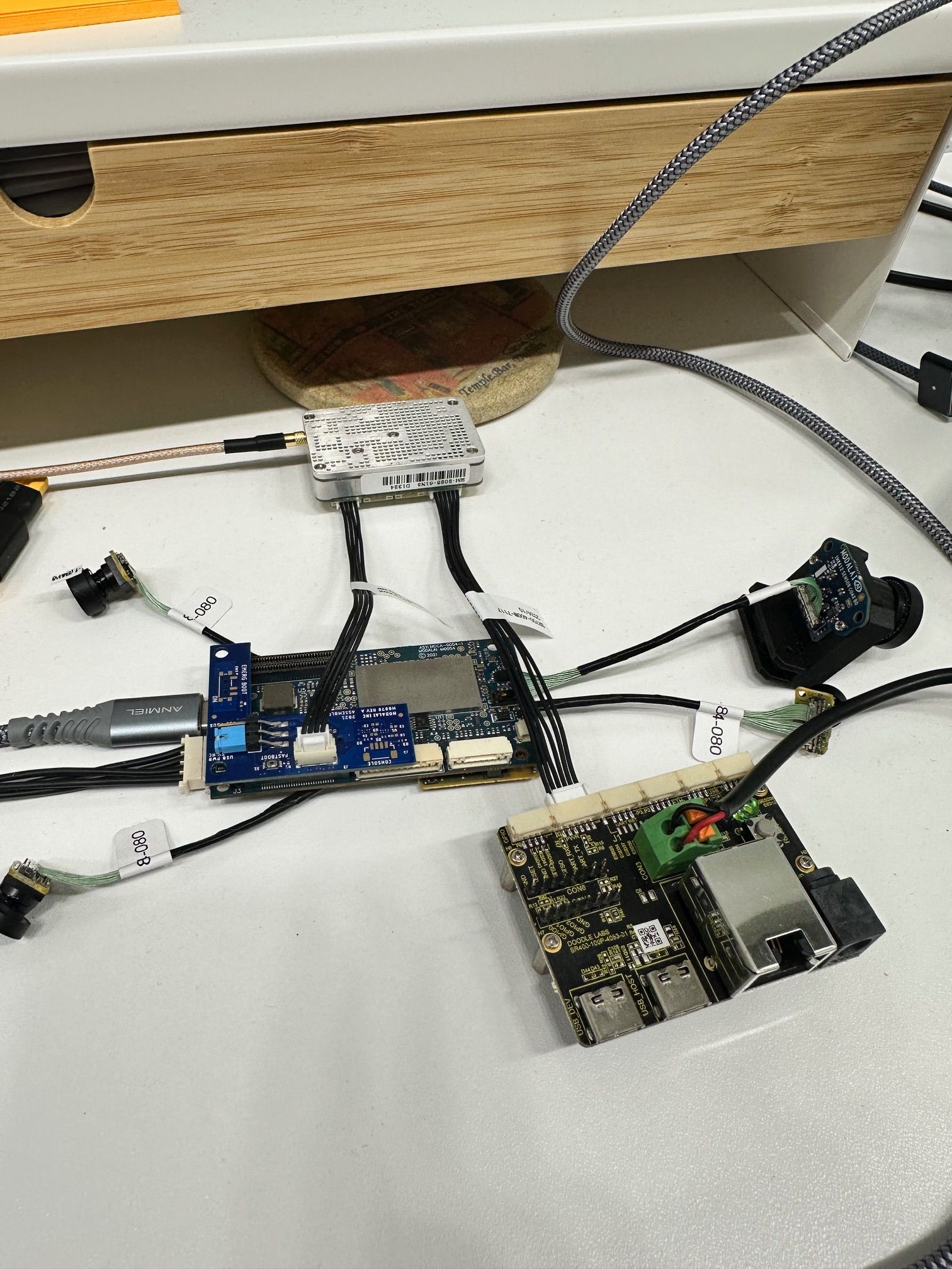

              • A
                AidanGallagher @AidanGallagher
                A 1 Reply Last reply Reply Quote 0
                • A
                  That's my working solution

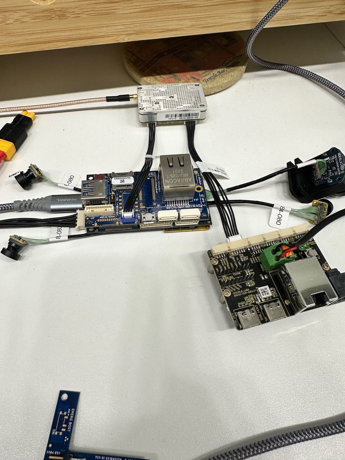

                  • A
                    • A
                      This solution doesn't work
                      tomT 1 Reply Last reply Reply Quote 0
                      • tomT
                        tom admin @AidanGallagher
                        @AidanGallagher With an M0130 USB breakout board
                        M0130: https://www.modalai.com/products/m0130-3?variant=48186331693360
                        You can use this cable:
                        MCBL-00085: https://www.modalai.com/products/mcbl-00085?_pos=2&_sid=0c5d87c5e&_ss=r
                        and get rid of the need for the doodle breakout board
