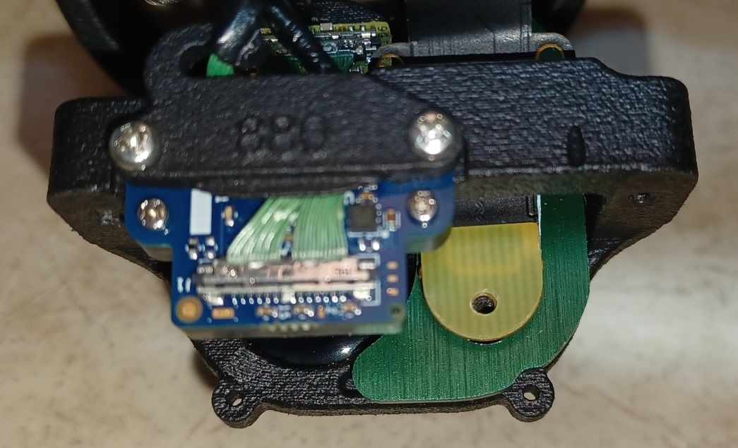

          Please advise - something is really wrong here since I cant see any of my cameras. My Starling 2 has the camera configuration C27 (triple tracking)
          Thanks, Hector

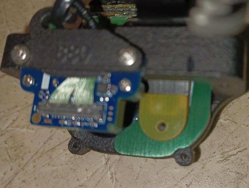

              Thanks. The output of voxl-camera-server -l is shown below, but it seems generic. Several issues remain:
              • voxl-camera-server detected 4 cameras, but my drone has 5
              • when opening voxl portal, zero cameras are detected. Also, the IMU plotter runs but gives empty plots.
              Please let me know what to try next - it does seem like a hardware problem.
              Thanks - Regards, Hector

                                Alex Kushleyev ModalAI Team @Hector Gutierrez
                                @Hector-Gutierrez , can you please send a picture of the TOF sensor connected to M0173? Just to make sure the connections are correct.
                                Hector GutierrezH 1 Reply Last reply Reply Quote 0
                                • Hector GutierrezH
                                  Hector Gutierrez @Alex Kushleyev
                                  @Alex-Kushleyev
                                  Hi Alex - attached are some pictures of the connection. Something odd is happening. The connector engages its socket in two different locations relative to the hole for the screw. In the centered location (where it should be!) the TOF sensor causes a power short and the drone wont boot (see picture with red LED). In the off-center location there is no short and the drone boots, but I only get 4 cameras and the TOF is not visible.
                                  ![centered.jpg](Request Entity Too Large) ![off-center1.jpg](Request Entity Too Large) ![off-center2.jpg](Request Entity Too Large) ![power-short.jpg](Request Entity Too Large)

                                    • Hector GutierrezH
                                      Hector Gutierrez @Hector Gutierrez
                                      @Hector-Gutierrez
                                      Update from my previous post. I install the TOF connector in the centered location and fully attach the screws (including the one that secures the TOF ribbon cable). There is no short, the drone start normally, and I get 4 cameras on VOXL portal, but no TOF. Also voxl-camera-server -l only see 4 cameras. So TOF connection is definitely Ok, but sensor not present.
                                          After installing the TOF connector in the centered location and fully attach all the screws (including the one that secures the TOF ribbon cable), there is no short and the drone starts normally. I get 4 cameras on VOXL portal, but no TOF. Also voxl-camera-server -l only see 4 cameras. So TOF connection seems definitely Ok, but sensor not present. Seems to me like a bad TOF sensor - let me know your thoughts.
                                          • Hector GutierrezH
                                            @Hector-Gutierrez Clarification on the pictures. The top picture is the centered position of the TOF ribbon cable. The bottom picture can be disregarded. The connection is done on the centered position (top picture). Thanks.
