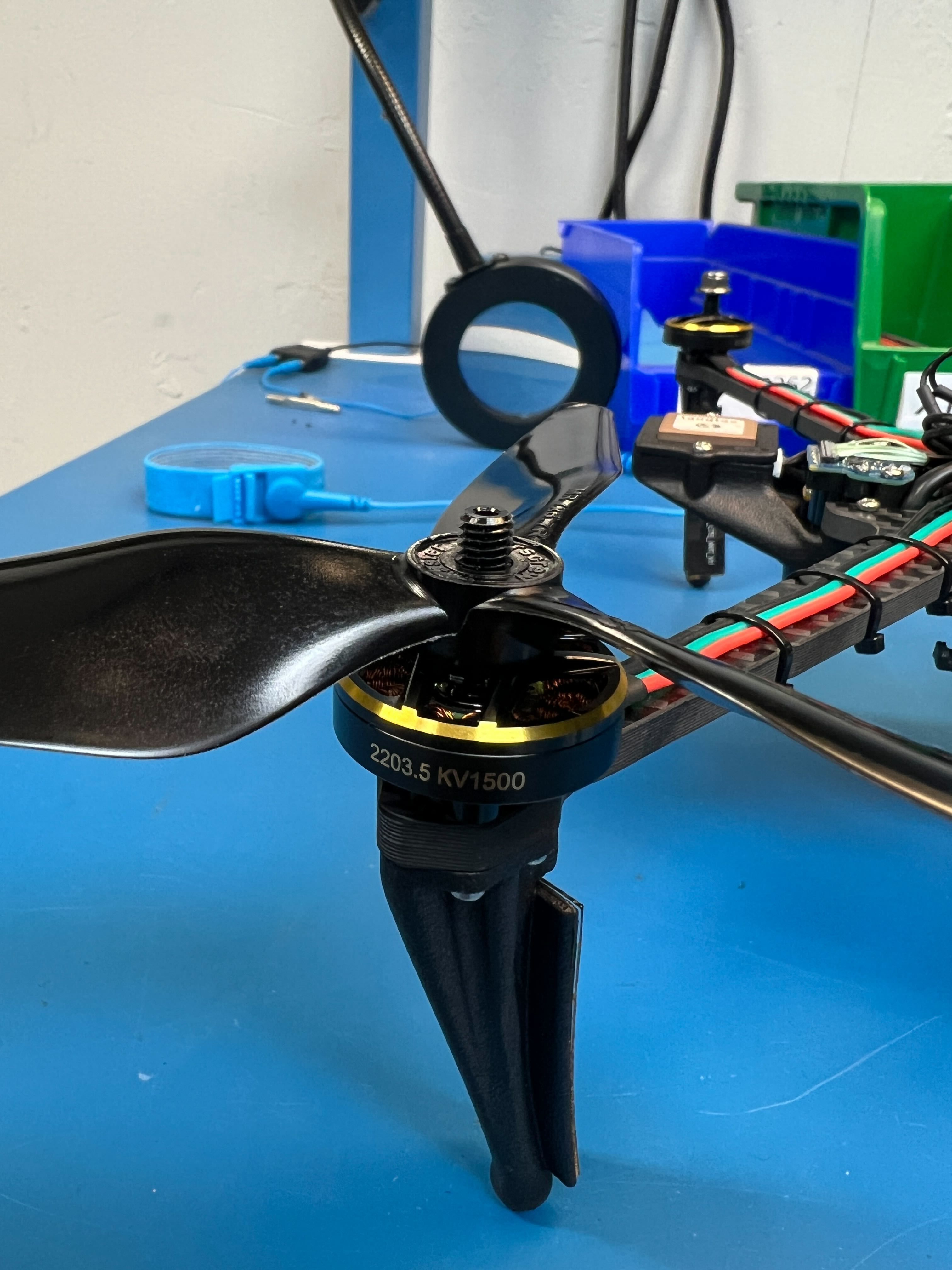

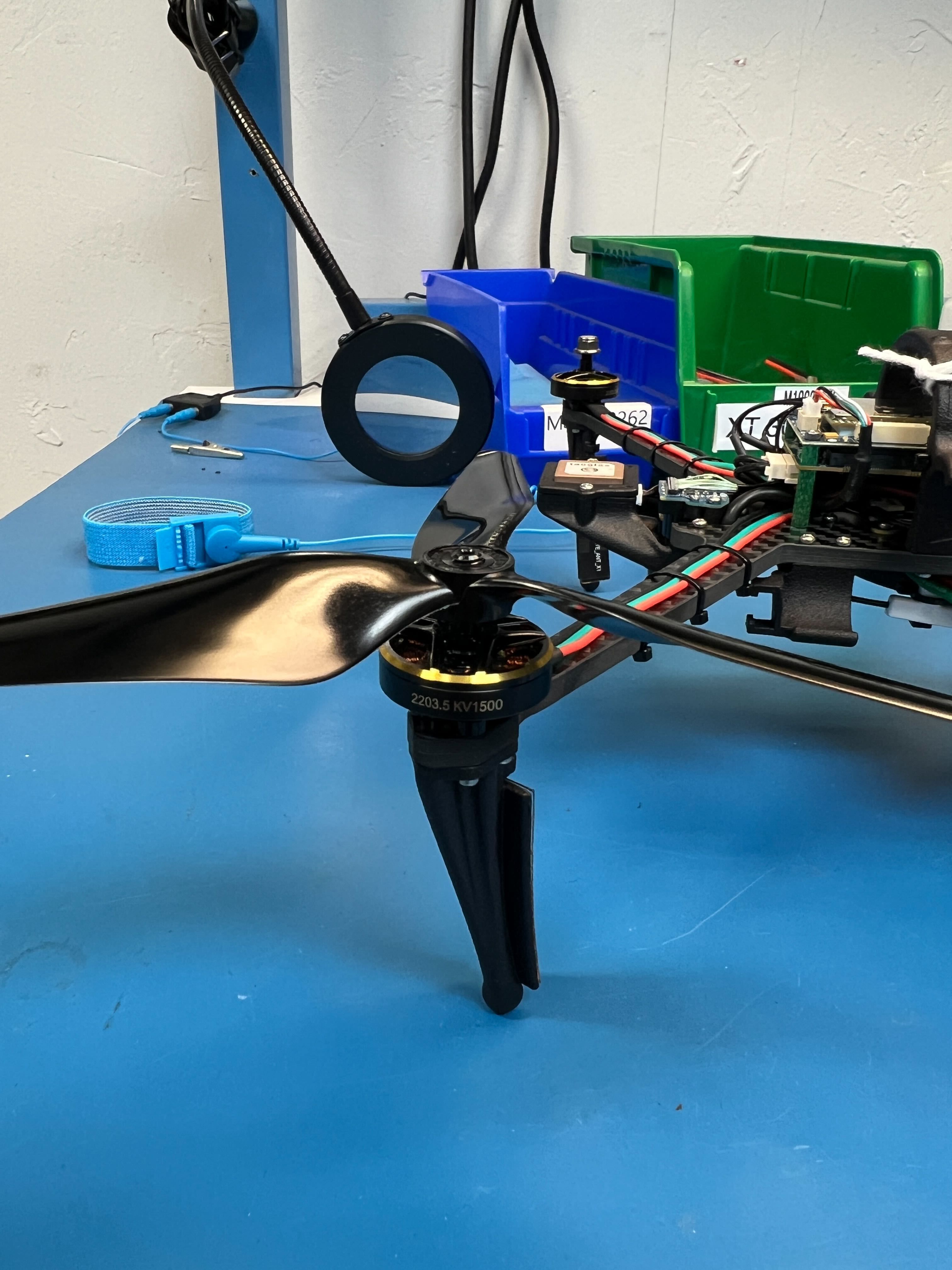

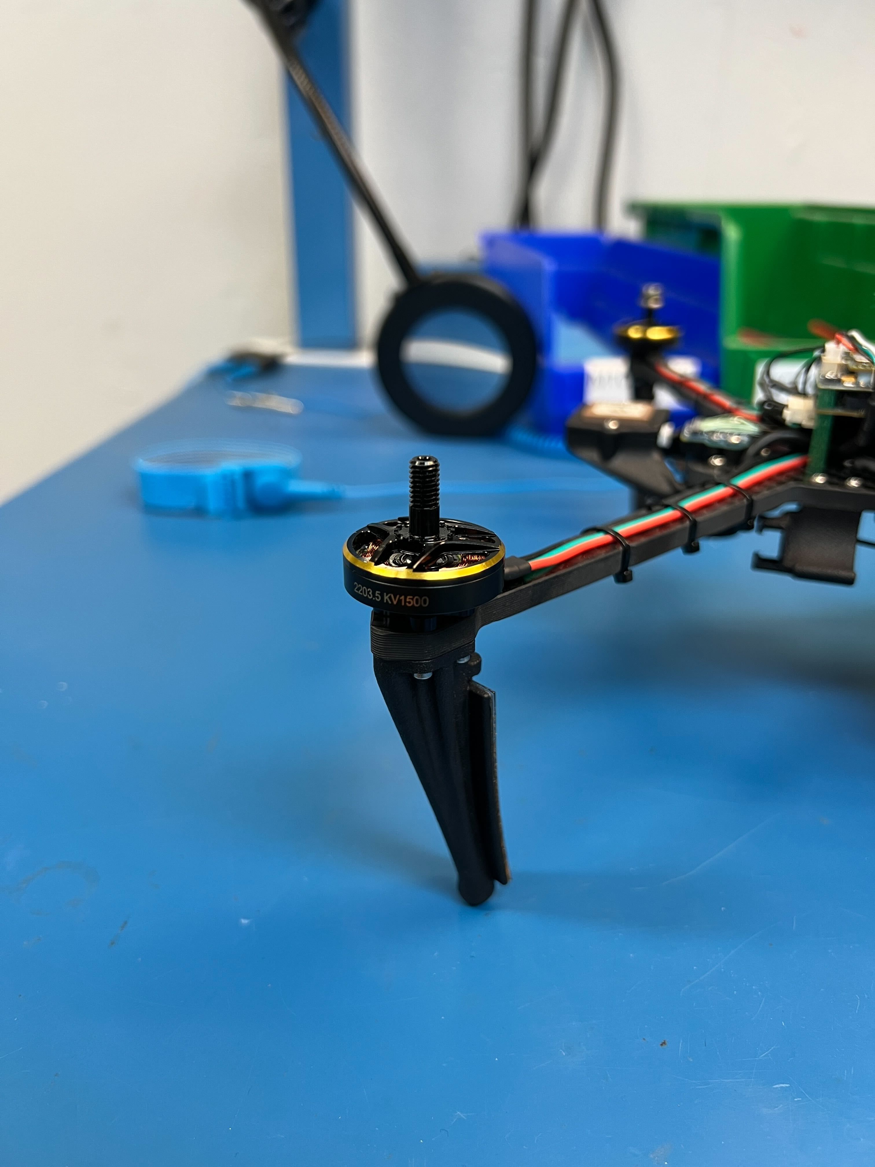

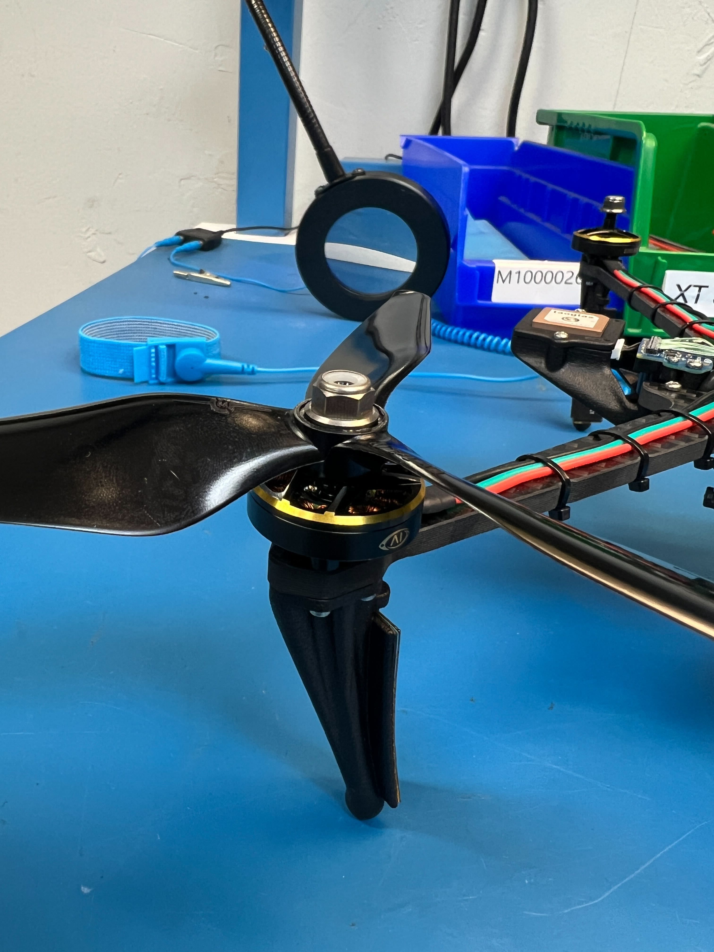

        @Moderator Sorry to hear that the props won't go on correctly. Could you please post a picture of the motor shaft and propellers?
        Do the props fit at all or just really snug?
        Thanks
        • Adrian HidalgoA
          Adrian Hidalgo ModalAI Team
          Typically, with a set of new props, they will have a very snug/tight fit. See pictures below:
