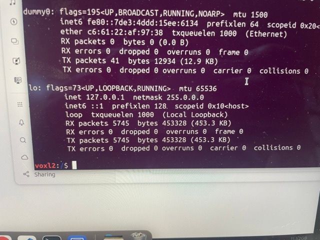

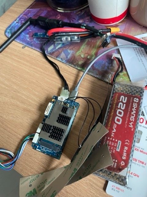

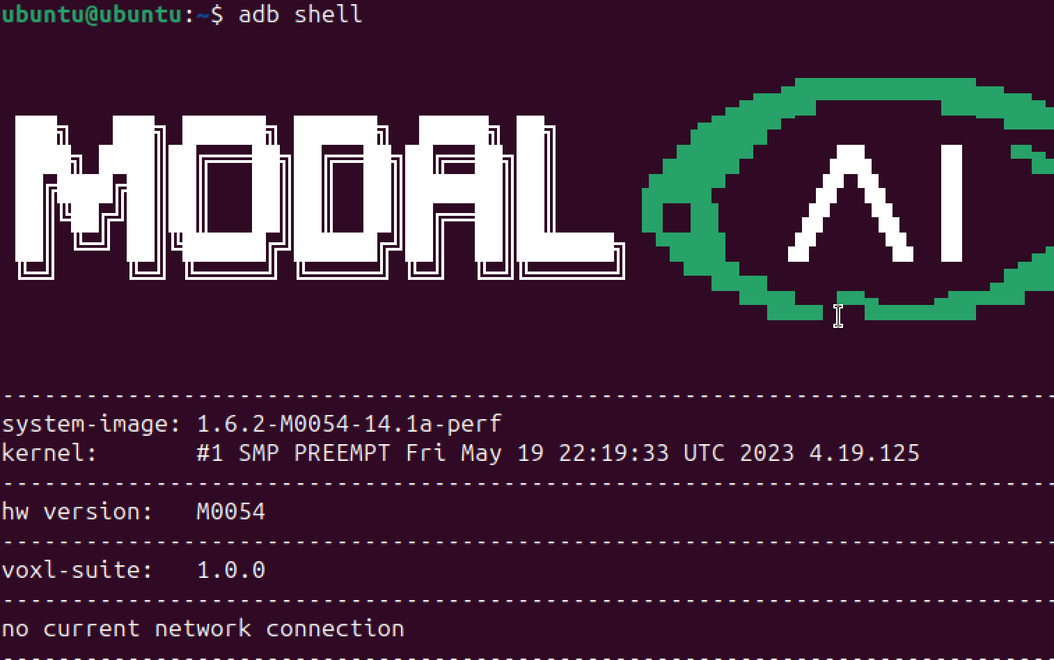

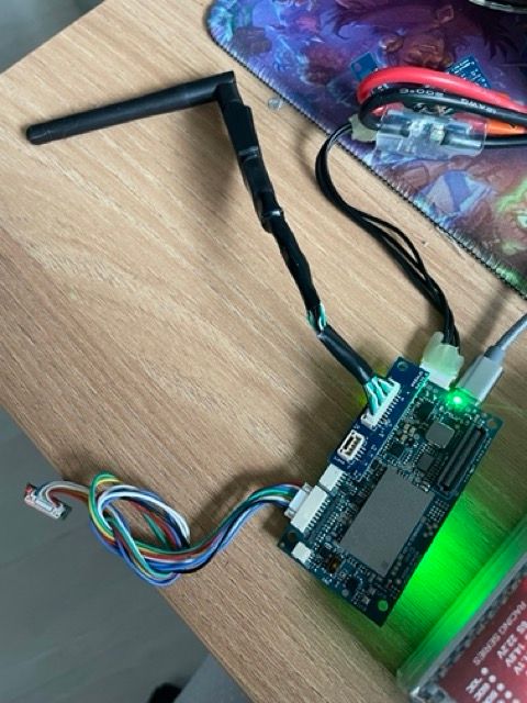

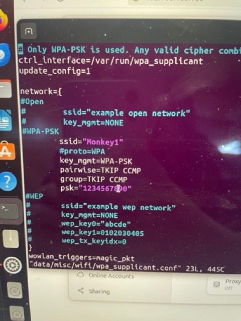

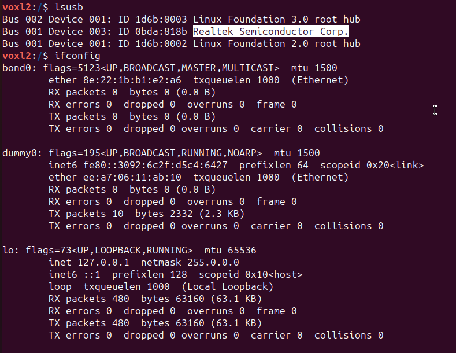

    Hello! I am having some issues trying to connect both wifi and 5G Connector.
    Either way I have issues getting any network connection.
    I tried all the documentations from the site but still have not success. I am getting kinda frustrated at this.
    I will attach a picture of both wifi and 5G Connector images + What images that I get after connecting voxl.
    Kindly asking for help. Thank you

      @Paola-Lim Your SDK is quite old at this point so I would suggest flashing the latest (1.1.3).
      See here for voxl-wifi usage:
      https://docs.modalai.com/voxl-2-wifi-setup/

        HI @Paola-Lim
        Please also provide some physical separation between your two WWAN antennas. When they are that close to each other, they will detune.
        Also make sure they are not sitting up directly against any conductive material such as carbon frames or batteries. Some type of dielectric spacer is required to adhere them to most surfaces.
        You can easily google search the 3M antenna part number with a phrase like "guidelines" to get further input direct from 3M for those specific bands.

          @tom Is the "voxl-suite: 1.0.0" the SDK?
          https://docs.modalai.com/flash-system-image/ <- This is how you upgrade the SDK? Just would like to confirm so I can upgrade it first.

              @Paola-Lim
              You will need to follow directions from this page : https://docs.modalai.com/flash-system-image/#flashing-a-voxl-sdk-release
              Tom suggested getting the SDK 1.1.3, so per instructions you should go to https://developer.modalai.com, log in, then click on Protected Downloads -> VOXL2 Platform Releases and download VOXL2 SDK 1.1.3 and follow the rest of instructions from "flashing voxl sdk" page
