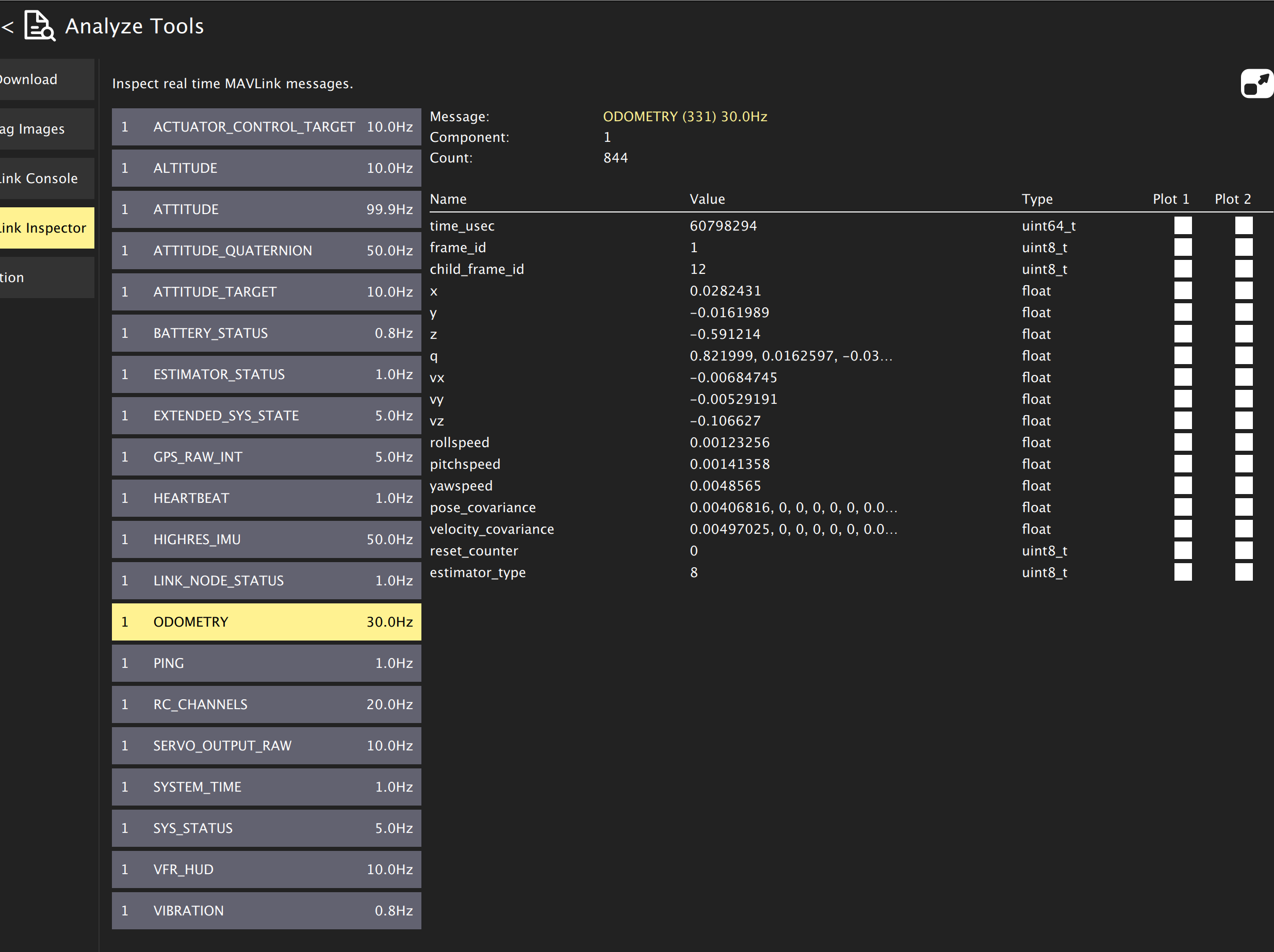

    Currently we are facing some strange issues. When we run "voxl-vision-px4 -o", we are able to see the odometry properly on our terminal.
    But in QgroundControl, when we are connected via usb cable, we only see "z" value in odometry and (x&y are zero). Also, the local position ned x and y are zero as well.
    Now when we connect over IP address of VOXL board to QgroundControl, we are able to see the complete odometry readings (i.e values of x,y&z). However, the local position ned x and y are still zero.
    Ultimately, we are trying to put the drone on the position flight mode, but its continously rejecting the position mode. We have made sure that our PX4 params are correct.
    Here's the voxl-vision-px4.conf file that we have set. And this exact configuration has worked for us in the past.

      With respect to the above post, I would also like to add this issue as well. I have attached a screenshot for the same.qgc_issue.png
      @Chad-Sweet @modaltb @ModalAI-Updates

                    @modaltb no data is missing. I had just cropped the image to show you the just the important part. Here's the full image.

                      Sorry, I meant the Serial/MAVLink setup, which may affect this:
                      Then in MAVLink inspector, you see more data:

                        Actually, you want to select LOCAL_POSITION_NED to see the VIO data, I didn't have this until I loaded the https://gitlab.com/voxl-public/flight-core-px4/px4-parameters/-/blob/master/helpers/ekf2_indoor_vio.params

                          @modaltb We have already loaded the ekf2_indoor_vio.params.
                          Also I'm getting all these data that you just shared. I'm getting the local position ned, but the x and y are zero. Again the point to be noted here is that (also mentioned in the original post), tha I'm connected via USB cable to qgc. When I'm just over the wifi, I get the right odometry but the x and y of local position ned is still 0 one.png two.png three.png
