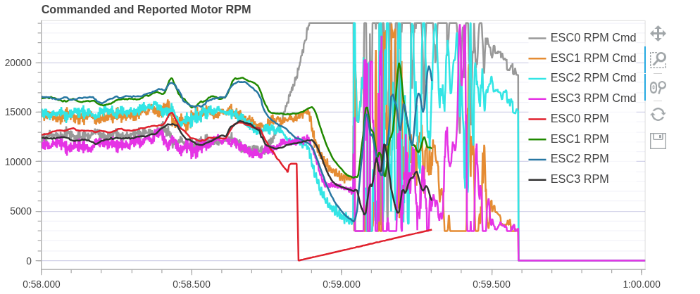

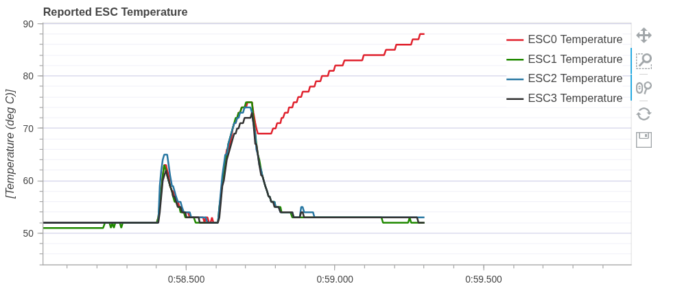

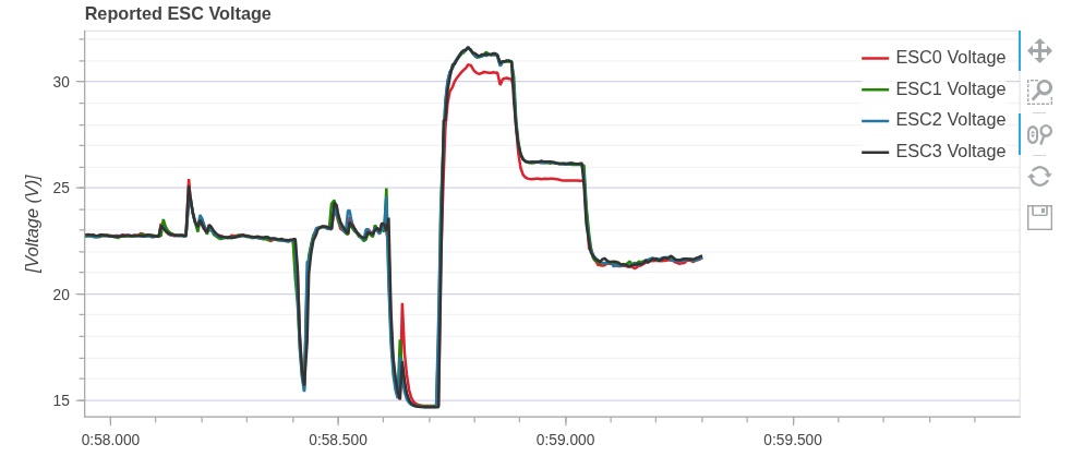

                    I looked at the log you shared. There is something strange going on with the voltage sensing on all 4 ESCs at the same time.
                    Voltage Plot

                    ESC Temperature Plot

                    • Since you said that you are using a 6S Li-Ion, it should not be possible for voltage to go up to 30+ volts.
                    • Voltage sensing and Temperature sensing are exhibiting very unusual spikes - i have never seen this before.
                    • the ESC temp before the crash is around 52C, so that is not an issue at all
                    • Looking at the RPM plot, i see RPM (actual) humps at around t=58.750s, which is where the measured voltage is reported dipping. Connecting the two pieces information, i am guessing that the actual battery voltage stayed the same, and the ESC measured (incorrectly) wrong voltage, and RPM controller tried to compensate, driving the actual rpm higher (since the battery voltage was still pretty high).

                    • it seems that multiple ADC channels on the ESC are affected (voltage, temperature measurements). A possible reason for this is the ESC MCU power supply (3.3V) is not constant. This could happen if 3.3V regulator on the ESC is overloaded by something (else) or the main 5V switching regulator is overloaded and drops out, causing a dropout on 3.3V.
                    • All 4 ESC channels are responding almost identically (before one motor stops), which would mean that a software bug is very unlikely. This is a hardware issue that is somehow affecting the ADC (and probably other components) of the ESC.
                    Please double check your system design to make sure that the ESC power supplies are not affected.

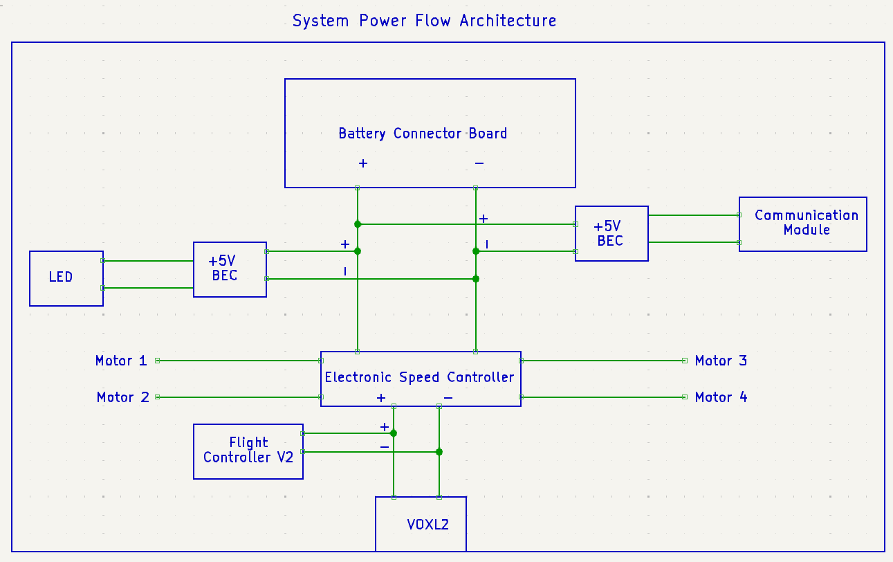

                      Please find attached the system architecture diagram (power flow) of our platform for your review.
                      We would appreciate it if you could review the architecture and advise whether there are any potential concerns related to the power distribution, grounding scheme, wiring, connectors, ESC installation, or any other aspect that could contribute to the behavior we observed with the VOXL FPV ESC.

                      At present, the third-party ESC continues to function correctly, and we have not observed any of the symptoms previously encountered with the VOXL FPV ESC. Motor operation, flight stability, and overall system performance remain normal.
                      This observation is particularly important because the remainder of the system configuration has remained largely unchanged, including:
                      VOXL2
                      Flight Controller V2
                      Power distribution architecture
                      Motors
                      Propellers
                      Battery configuration
                      Airframe and enclosure
                      Given that the issue is not reproducible with the third-party ESC, we are trying to better understand whether there may be any specific factors related to the VOXL FPV ESC installation, operation, thermal conditions, configuration, or hardware that could have contributed to the failures we observed.
                      For reference, the ESC installation includes:
                      An aluminum heatsink mounted beneath the ESC
                      Thermal interface material between the ESC and heatsink
                      Nylon spacers providing electrical isolation
                      A dedicated 3D-printed mounting structure preventing contact with the aluminum enclosure
                      Based on the current mechanical arrangement, we do not believe there is any direct electrical contact between the ESC and the enclosure.
                      We would greatly appreciate your guidance on any additional troubleshooting procedures that you would recommend for the VOXL FPV ESC, including:

                        Can you please clarify the following - in your original post, you mentioned that the third party ESC also had issues, however in the post above you said no issues. I am quoting your notes from above:
                        Scenario 3 – Third-Party ESC Evaluation
                        To further isolate the issue, we replaced the VOXL FPV ESC with a NeutronRC X-CLASS 4IN1 ESC V2 (3–8S, 70A) configured using the DShot protocol.
                        During testing, we observed the following:
                        ESC temperature increased rapidly, reaching approximately 80°C to 90°C within two minutes of flight.
                        One motor would subsequently stop during flight.
                        The aircraft would lose stability and crash.
                        I just wanted to clarify what actually happened and then we can investigate further. Than, you for providing the diagram, i think it looks OK.
                        I have never seen this behavior where the ESC reports incorrect voltage and these short spikes in temperature. This may point to a hardware issue on the ESC board, but i do not actually know where it might be or what would cause it. Have you visually inspected the FPV ESC that has this issue to see if any components appear damaged or anything looks unusual?
