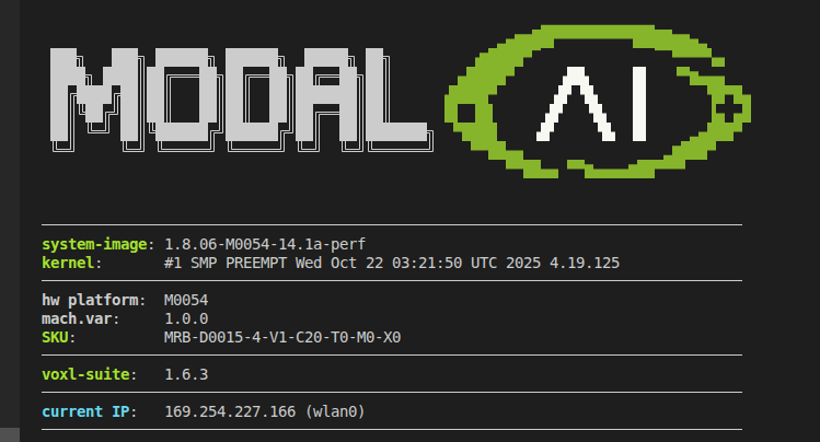

    Hello Modal AI team,
    I just flashed my Voxl2 with the newest SDK 1.6.3. The issue is I cannot seem to get station mode working with voxl-wifi. Is this a common bug or am I missing something here? Here is my system info from the abd shell "intro" for reference.
    M 1 Reply Last reply

      @Matt69 For further clarification, my understanding is that a 169.XXX.XXX.XXX IP address indicates off nominal wifi performance. Please advise.

        Hi @Matt69 ,
        Yes, the shown ip address is a self-assigned address which happens if there is no ip address assigned by a DHCP server.
        What wifi module are you using?
        Does output of iwconfig wlan0 show that you are connected to your Access Point?

                                @SKA , please check the output of syslog, it may contain a hint as to why wlan0 has a static ip, maybe dhcpcd is not working properly.
                                  Also, here is output of tail -n 100 /var/log/syslog:

                                  @Alex-Kushleyev When I run tail -n 100 /var/log/syslog, I don't see any messages coming from m0104 dhcpcd or m0104 wpa_supplicant
                                  edit: I turned the USB VBUS off and on, and saw this pop up on syslog:

                                    @SKA , can you also please check journalctl -u dhcpcd to see if there is anything interesting there?

                                      @Alex-Kushleyev Here's what I see! I wonder if this is the problem:
                                      /etc/network/interfaces: No such file or directory

                                        #19
                                        @SKA ,
                                        I have the same same error, but wifi is working (/etc/network/interfaces: No such file or directory).
                                        I also see that your dhcp client is able to get an ip address 10.10.10.116 for wlan0, which is strange that you don't see that ip address in ifconfig..
                                          @SKA ,
                                          #20
                                          can you please check output of ifconfig ? i wonder if wlan0 is not the primary interface for some reason
                                          S 1 Reply Last reply
