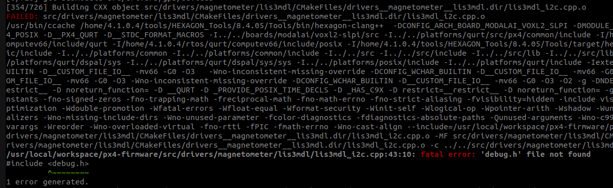

            • Alex MayA
              Alex May @Eric Katzfey
              @Eric-Katzfey Thanks for the information on the magnetometer. We have integrated a different magnetometer and it seems to work. We will work on building the original mag into the image.

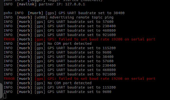

              For the GPS, I just did what you suggested and here is the output.
              Eric KatzfeyE 2 Replies Last reply Reply Quote 0
              • Eric KatzfeyE
                Eric Katzfey ModalAI Team @Alex May
                @Alex-May It really looks like there is no communication going on between the GPS and the VOXL 2. Can you attach an oscilloscope to the rx and tx lines to look for activity? Usually the M10 units come up and start sending NMEA strings at 9600 so you would be able to detect that on the scope.
                Alex MayA 1 Reply Last reply Reply Quote 0

                    INFO [qshell] Send cmd: 'voxl_esc start'
                    INFO [muorb] [uORB] Marking DeviceNode(qshell_req) as advertised in process_remote_topic
                    INFO [muorb] [qshell] qshell gotten: voxl_esc start
                    INFO [muorb] [qshell] arg0 = 'voxl_esc'
                    INFO [muorb] [qshell] arg1 = 'start'
                    INFO [uORB] Advertising remote topic actuator_outputs
                    INFO [muorb] [voxl_esc] Starting VOXL ESC driver
                    INFO [muorb] [voxl_esc] Params: VOXL_ESC_CONFIG: 1
                    INFO [muorb] [voxl_esc] Params: VOXL_ESC_MODE: 0
                    INFO [muorb] [voxl_esc] Params: VOXL_ESC_BAUD: 250000
                    INFO [muorb] [voxl_esc] Params: VOXL_ESC_FUNC1: 104
                    INFO [muorb] [voxl_esc] Params: VOXL_ESC_FUNC2: 101
                    INFO [muorb] [voxl_esc] Params: VOXL_ESC_FUNC3: 103
                    INFO [muorb] [voxl_esc] Params: VOXL_ESC_FUNC4: 102
                    INFO [muorb] [voxl_esc] Params: VOXL_ESC_SDIR1: 1
                    INFO [muorb] [voxl_esc] Params: VOXL_ESC_SDIR2: 1
                    INFO [muorb] [voxl_esc] Params: VOXL_ESC_SDIR3: 1
                    INFO [muorb] [voxl_esc] Params: VOXL_ESC_SDIR4: 1
                    INFO [muorb] [voxl_esc] Params: VOXL_ESC_RPM_MIN: 1500
                    INFO [muorb] [voxl_esc] Params: VOXL_ESC_RPM_MAX: 12000
                    INFO [muorb] [voxl_esc] Params: VOXL_ESC_T_PERC: 90
                    INFO [muorb] [voxl_esc] Params: VOXL_ESC_T_DEAD: 20
                    INFO [muorb] [voxl_esc] Params: VOXL_ESC_T_EXPO: 35
                    INFO [muorb] [voxl_esc] Params: VOXL_ESC_T_MINF: 0.150000
                    INFO [muorb] [voxl_esc] Params: VOXL_ESC_T_COSP: 0.990000
                    INFO [muorb] [voxl_esc] Params: VOXL_ESC_VLOG: 1
                    INFO [muorb] [voxl_esc] Params: VOXL_ESC_PUB_BST: 1
                    INFO [muorb] [voxl_esc] Params: VOXL_ESC_T_WARN: 0
                    INFO [muorb] [voxl_esc] Params: VOXL_ESC_T_OVER: 0
                    INFO [muorb] [voxl_esc] Params: GPIO_CTL_CH: 0
                    INFO [muorb] [qshell] Ok executing command: voxl_esc start
                    INFO [muorb] [voxl_esc] Opening UART ESC device 2, baud rate 250000
                    INFO [muorb] [voxl_esc] Successfully opened UART ESC device
                    INFO [muorb] [voxl_esc] Detecting ESCs...
                    INFO [muorb] [voxl_esc] ESC ID : 0
                    INFO [muorb] [voxl_esc] Board Type : 42: ModalAi 4-in-1 ESC (M0138-1)
                    INFO [muorb] [voxl_esc] Unique ID : 0x2030303355465715004A0021
                    INFO [qshell] qshell return value timestamp: 211799981, local time: 211806814
                    INFO [muorb] [voxl_esc] Firmware : version 39, hash e4f576a0
                    INFO [muorb] [voxl_esc] Bootloader : version 184, hash e1c038de
                    INFO [muorb] [voxl_esc] Reply time : 2538us
                    INFO [muorb] [voxl_esc] VOXL_ESC:
                    INFO [muorb] [voxl_esc] ESC ID : 1
                    INFO [muorb] [voxl_esc] Unique ID : 0x2030303355465715003B001E
                    INFO [muorb] [voxl_esc] Reply time : 3147us
                    INFO [muorb] [voxl_esc] ESC ID : 2
                    Starting CRSF RC driver
                    INFO [muorb] [voxl_esc] Unique ID : 0x20303033554657150048001F
                    INFO [muorb] [voxl_esc] Reply time : 3800us
                    INFO [muorb] [voxl_esc] ESC ID : 3
                    INFO [muorb] [voxl_esc] Unique ID : 0x2030303355465715002E0020
                    INFO [muorb] [voxl_esc] Reply time : 3141us
                    INFO [muorb] [voxl_esc] Use extened rpm packet : 1
                    INFO [muorb] [voxl_esc] All ESCs successfully detected
                    INFO [qshell] Send cmd: 'crsf_rc start -d 7'
                    INFO [muorb] [qshell] qshell gotten: crsf_rc start -d 7
                    INFO [muorb] [qshell] arg0 = 'crsf_rc'
                    INFO [muorb] [qshell] arg2 = '-d'
                    INFO [muorb] [qshell] arg3 = '7'
                    INFO [muorb] [qshell] Ok executing command: crsf_rc start -d 7
                    INFO [muorb] [crsf_rc] Crsf serial opened sucessfully
                    INFO [muorb] [crsf_rc] Crsf serial is single wire. Telemetry disabled
                    INFO [uORB] Advertising remote topic input_rc
                    INFO [qshell] qshell return value timestamp: 211853575, local time: 211856609
                    INFO [uORB] Advertising remote topic actuator_outputs_debug
                    INFO [uORB] Advertising remote topic esc_status
                    INFO [qshell] Send cmd: 'voxlpm start -X -b 2'
                    INFO [muorb] [qshell] qshell gotten: voxlpm start -X -b 2
                    INFO [muorb] [qshell] arg0 = 'voxlpm'
                    INFO [muorb] [qshell] arg2 = '-X'
                    INFO [muorb] [qshell] arg3 = '-b'
                    INFO [muorb] [qshell] arg4 = '2'
                    INFO [muorb] [drivers__device] *** I2C Device ID 0xd24411 13779985
                    INFO [muorb] [drivers__device] Set up I2C bus mutex for bus 2
                    INFO [muorb] [drivers__device] Set i2c address 0x6a, fd 5
                    INFO [muorb] [drivers__device] Set i2c address 0x44, fd 5
                    ERROR [muorb] [drivers__device] i2c probe failed
                    INFO [muorb] [SPI_I2C] PX4_qshell: no instance started (no device on bus?)
                    ERROR [muorb] [qshell] Failed to execute command: voxlpm start -X -b 2
                    INFO [qshell] cmd returned with: -1
                    INFO [qshell] qshell return value timestamp: 211911245, local time: 211914428
                    ERROR [qshell] Command failed
                    INFO [qshell] Send cmd: 'sensors start'
                    INFO [muorb] [qshell] qshell gotten: sensors start
                    INFO [muorb] [qshell] arg0 = 'sensors'
                    INFO [uORB] Advertising remote topic sensor_selection
                    INFO [uORB] Advertising remote topic sensors_status_imu
                    INFO [uORB] Advertising remote topic vehicle_acceleration
                    INFO [uORB] Advertising remote topic vehicle_angular_velocity
                    INFO [uORB] Advertising remote topic sensor_combined
                    INFO [uORB] Advertising remote topic battery_status
                    INFO [uORB] Advertising remote topic vehicle_air_data
                    INFO [uORB] Advertising remote topic vehicle_gps_position
                    INFO [uORB] Advertising remote topic vehicle_magnetometer
                    INFO [uORB] Advertising remote topic sensor_preflight_mag
                    INFO [uORB] Advertising remote topic sensors_status_mag
                    INFO [uORB] Advertising remote topic vehicle_imu
                    INFO [uORB] Advertising remote topic vehicle_imu_status
                    INFO [muorb] [qshell] Ok executing command: sensors start
                    INFO [qshell] qshell return value timestamp: 212095544, local time: 212100016
                    INFO [uORB] Advertising remote topic sensors_status_baro
                    INFO [qshell] Send cmd: 'ekf2 start'
                    INFO [muorb] [qshell] qshell gotten: ekf2 start
                    INFO [muorb] [qshell] arg0 = 'ekf2'
                    INFO [uORB] Advertising remote topic vehicle_attitude
                    INFO [uORB] Advertising remote topic vehicle_local_position
                    INFO [uORB] Advertising remote topic estimator_event_flags
                    INFO [uORB] Advertising remote topic estimator_innovation_test_ratios
                    INFO [uORB] Advertising remote topic estimator_innovation_variances
                    INFO [uORB] Advertising remote topic estimator_innovations
                    INFO [uORB] Advertising remote topic estimator_sensor_bias
                    INFO [uORB] Advertising remote topic estimator_states
                    INFO [uORB] Advertising remote topic estimator_status_flags
                    INFO [muorb] [qshell] Ok executing command: ekf2 start
                    INFO [uORB] Advertising remote topic ekf2_timestamps
                    INFO [uORB] Advertising remote topic vehicle_odometry
                    INFO [uORB] Advertising remote topic estimator_aid_src_fake_pos
                    INFO [uORB] Advertising remote topic estimator_aid_src_fake_hgt
                    INFO [uORB] Advertising remote topic estimator_aid_src_mag_heading
                    INFO [uORB] Advertising remote topic estimator_aid_src_gravity
                    INFO [qshell] qshell return value timestamp: 212264482, local time: 212270715
                    INFO [qshell] Send cmd: 'mc_pos_control start'
                    INFO [muorb] [qshell] qshell gotten: mc_pos_control start
                    INFO [muorb] [qshell] arg0 = 'mc_pos_control'
                    INFO [uORB] Advertising remote topic takeoff_status
                    INFO [muorb] [qshell] Ok executing command: mc_pos_control start
                    INFO [qshell] qshell return value timestamp: 212351878, local time: 212353666
                    INFO [qshell] Send cmd: 'mc_att_control start'
                    INFO [muorb] [qshell] qshell gotten: mc_att_control start
                    INFO [muorb] [qshell] arg0 = 'mc_att_control'
                    INFO [uORB] Advertising remote topic estimator_aid_src_baro_hgt
                    INFO [muorb] [qshell] Ok executing command: mc_att_control start
                    INFO [qshell] qshell return value timestamp: 212387868, local time: 212389654
                    INFO [qshell] Send cmd: 'mc_rate_control start'
                    INFO [muorb] [qshell] qshell gotten: mc_rate_control start
                    INFO [muorb] [qshell] arg0 = 'mc_rate_control'
                    INFO [uORB] Advertising remote topic rate_ctrl_status
                    INFO [muorb] [qshell] Ok executing command: mc_rate_control start
                    INFO [qshell] qshell return value timestamp: 212448566, local time: 212452284
                    INFO [qshell] Send cmd: 'mc_hover_thrust_estimator start'
                    INFO [muorb] [qshell] qshell gotten: mc_hover_thrust_estimator start
                    INFO [muorb] [qshell] arg0 = 'mc_hover_thrust_estimator'
                    INFO [muorb] [qshell] Ok executing command: mc_hover_thrust_estimator start
                    INFO [qshell] qshell return value timestamp: 212509852, local time: 212513050
                    INFO [qshell] Send cmd: 'mc_autotune_attitude_control start'
                    INFO [muorb] [qshell] qshell gotten: mc_autotune_attitude_control start
                    INFO [muorb] [qshell] arg0 = 'mc_autotune_attitude_control'
                    INFO [uORB] Advertising remote topic autotune_attitude_control_status
                    INFO [muorb] [qshell] Ok executing command: mc_autotune_attitude_control start
                    INFO [qshell] qshell return value timestamp: 212547374, local time: 212549706
                    INFO [qshell] Send cmd: 'land_detector start multicopter'
                    INFO [muorb] [qshell] qshell gotten: land_detector start multicopter
                    INFO [muorb] [qshell] arg0 = 'land_detector'
                    INFO [muorb] [qshell] arg2 = 'multicopter'
                    INFO [muorb] [qshell] Ok executing command: land_detector start multicopter
                    INFO [qshell] qshell return value timestamp: 212585335, local time: 212585998
                    INFO [uORB] Advertising remote topic vehicle_land_detected
                    INFO [qshell] Send cmd: 'manual_control start'
                    INFO [muorb] [qshell] qshell gotten: manual_control start
                    INFO [muorb] [qshell] arg0 = 'manual_control'
                    INFO [muorb] [qshell] Ok executing command: manual_control start
                    INFO [uORB] Advertising remote topic manual_control_setpoint
                    INFO [qshell] qshell return value timestamp: 212623416, local time: 212626408
                    INFO [qshell] Send cmd: 'control_allocator start'
                    INFO [muorb] [qshell] qshell gotten: control_allocator start
                    INFO [muorb] [qshell] arg0 = 'control_allocator'
                    INFO [uORB] Advertising remote topic control_allocator_status
                    INFO [uORB] Marking DeviceNode(control_allocator_status) as advertised in process_remote_topic
                    INFO [uORB] Advertising remote topic actuator_motors
                    INFO [uORB] Advertising remote topic actuator_servos
                    INFO [uORB] Advertising remote topic actuator_servos_trim
                    INFO [muorb] [qshell] Ok executing command: control_allocator start
                    INFO [qshell] qshell return value timestamp: 212776930, local time: 212779497
                    INFO [qshell] Send cmd: 'load_mon start'
                    INFO [muorb] [qshell] qshell gotten: load_mon start
                    INFO [muorb] [qshell] arg0 = 'load_mon'
                    INFO [muorb] [qshell] Ok executing command: load_mon start
                    INFO [uORB] Advertising remote topic cpuload
                    INFO [qshell] qshell return value timestamp: 212826033, local time: 212827740
                    INFO [qshell] Send cmd: 'rc_update start'
                    INFO [muorb] [qshell] qshell gotten: rc_update start
                    INFO [muorb] [qshell] arg0 = 'rc_update'
                    INFO [muorb] [qshell] Ok executing command: rc_update start
                    INFO [uORB] Advertising remote topic rc_channels
                    INFO [qshell] qshell return value timestamp: 212954650, local time: 212958731
                    INFO [qshell] Send cmd: 'commander start'
                    INFO [muorb] [ekf2] resetQuatStateYaw called: -0.968698 (0.090000)
                    INFO [muorb] [qshell] qshell gotten: commander start
                    INFO [muorb] [qshell] arg0 = 'commander'
                    INFO [muorb] [tasks] Creating pthread commander
                    INFO [muorb] [tasks] Successfully created px4 task PX4_commander with tid 2097640
                    INFO [uORB] Advertising remote topic led_control
                    INFO [muorb] [commander] LED: open /dev/led0 failed (22)
                    INFO [muorb] [qshell] Ok executing command: commander start
                    INFO [uORB] Advertising remote topic tune_control
                    INFO [qshell] qshell return value timestamp: 213091743, local time: 213094449
                    INFO [uORB] Advertising remote topic event
                    INFO [uORB] Advertising remote topic health_report
                    INFO [uORB] Advertising remote topic failsafe_flags
                    INFO [uORB] Advertising remote topic actuator_armed
                    INFO [uORB] Advertising remote topic vehicle_control_mode
                    INFO [uORB] Advertising remote topic vehicle_status
                    INFO [uORB] Advertising remote topic failure_detector_status
                    INFO [uORB] Advertising remote topic vehicle_thrust_setpoint
                    INFO [uORB] Advertising remote topic vehicle_torque_setpoint
                    INFO [uORB] Advertising remote topic vehicle_attitude_setpoint
                    INFO [uORB] Advertising remote topic vehicle_rates_setpoint
                    INFO [qshell] Send cmd: 'flight_mode_manager start'
                    INFO [muorb] [qshell] qshell gotten: flight_mode_manager start
                    INFO [muorb] [qshell] arg0 = 'flight_mode_manager'
                    INFO [uORB] Advertising remote topic vehicle_command
                    INFO [muorb] [qshell] Ok executing command: flight_mode_manager start
                    INFO [qshell] qshell return value timestamp: 213156797, local time: 213159088
                    INFO [dataman] data manager file '/data/px4/dataman' size is 7866640 bytes
                    INFO [muorb] [uORB] Advertising remote topic transponder_report
                    INFO [muorb] [uORB] Advertising remote topic rtl_time_estimate
                    INFO [muorb] [uORB] Advertising remote topic position_setpoint_triplet
                    INFO [mavlink] mode: Onboard, data rate: 100000 B/s on udp port 14556 remote port 14557
                    INFO [muorb] [uORB] Advertising remote topic telemetry_status
                    INFO [mavlink] partner IP: 127.0.0.1
                    INFO [muorb] [uORB] Advertising remote topic offboard_control_mode
                    INFO [muorb] [uORB] Advertising remote topic obstacle_distance
                    INFO [muorb] [uORB] Advertising remote topic timesync_status
                    INFO [uORB] Advertising remote topic actuator_controls_status_0
                    INFO [mavlink] mode: Normal, data rate: 100000 B/s on udp port 14558 remote port 14559
                    INFO [muorb] [uORB] Marking DeviceNode(telemetry_status) as advertised in process_remote_topic
                    INFO [mavlink] MAVLink only on localhost (set param MAV_{i}_BROADCAST = 1 to enable network)
                    INFO [px4] Startup script returned successfully
                    pxh> INFO [logger] logger started (mode=all)
                    INFO [muorb] [gps] GPS UART baudrate set to 9600
                    INFO [muorb] [gps] GPS UART baudrate set to 38400
                    INFO [muorb] [uORB] Advertising remote topic ping
                    INFO [muorb] [gps] GPS UART baudrate set to 57600
                    INFO [muorb] [gps] GPS UART baudrate set to 230400
                    INFO [muorb] [gps] GPS UART baudrate set to 460800
                    INFO [muorb] [gps] GPS UART baudrate set to 921600
                    ERROR [muorb] [gps] GPS: failed to set baud rate 19200 on serial port
                    INFO [uORB] Advertising remote topic mavlink_log
                    INFO [muorb] [health_and_arming_checks] Preflight Fail: Strong magnetic interference
                    INFO [muorb] [health_and_arming_checks] Preflight Fail: Yaw estimate error
                    INFO [muorb] [gps] No COM port detected
                    INFO [muorb] [gps] GPS UART baudrate set to 115200
                    • Alex MayA
                      @Eric-Katzfey I don't believe we have a scope available for at least a few more days. But I do have other M10 GPS units I could try.
                      • P
                        psafi
                        @Eric-Katzfey I am Alex's co-worker and helping with the building the magnetometer's driver into PX4.
                        I am following instructions outlined here: https://gitlab.com/voxl-public/rb5-flight/rb5-flight-px4-build-docker#install-qualcomm-package-manager
                        I am having hard time downloading the hexagon SDK from qualcomm. I see v3.1 is available on your website. Am I going to need 4.X or I can use 3.1
                        Eric KatzfeyE 1 Reply Last reply Reply Quote 0
                        • Eric KatzfeyE
                          Eric Katzfey ModalAI Team @psafi
                          @psafi Yes, unfortunately it is a real pain to get the SDK from Qualcomm and you need that version.
                          P 1 Reply Last reply Reply Quote 0
                          • P
                            psafi @Eric Katzfey
                            This post is deleted!
                            • P
                              psafi @Eric Katzfey
                              @Eric-Katzfey I am able to build voxl-px4 now.
                              I am following instructions outlined here to add this magnetometer:
                              https://forum.modalai.com/post/16770
                              I am adding following line:
                              CONFIG_DRIVERS_MAGNETOMETER_LIS3MDL=y
                              to this file:
                              https://github.com/modalai/px4-firmware/blob/voxl-dev/boards/modalai/voxl2-slpi/default.px4board
                              when I attempt to build px4 I get the following error from the driver module:
                              • Eric KatzfeyE
                                @psafi Looks like it will compile if you comment out the #include <debug.h> lines in both lis3mdl_i2c.cpp and lis3mdl_spi.cpp
                                • Eric KatzfeyE
                                  @psafi Those should only be there on the Nuttx platform.
                                  • P
                                    psafi @Eric Katzfey
                                    @Eric-Katzfey I did that and was able to build and install new px4. Thank you!
