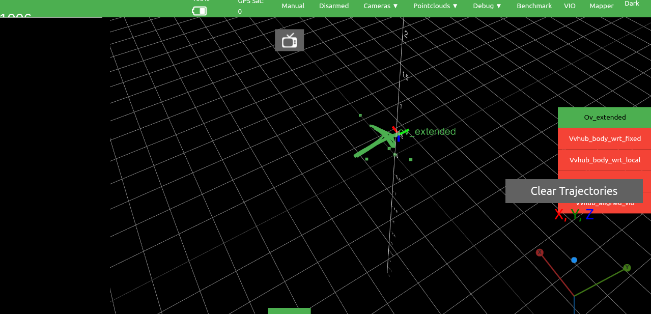

                Checking the above and before your next test flight, perform a hand test as follows:
                1. startup voxl portal & connect to the drone (web browser w/ip addr of the drone as the url--wifi must be running)
                2. goto the "vio" tab in portal
                3. pick up the drone and move it back and forth, then left and right. You should get something close to a "plus" trajectory in the portal screen (see attached). If it "flies away" then good chance calibration (imu, or camera, extrinsics) is off. If it stays frozen/unresponsive then there's a SDK configuration error.
                4. If you can repeat what is shown in the image, that confirms VIO is working properly and likely the above NOAID issue..
                if you're still having issues on take off, then you can modify in /etc/modalai/voxl-open-vins-server.conf and try the blind takeoff option by setting "en_vio_always_on": false, but note VIO will not report any movements (vio position will report as if frozen) until you arm the drone.
                B 2 Replies Last reply Reply Quote 1

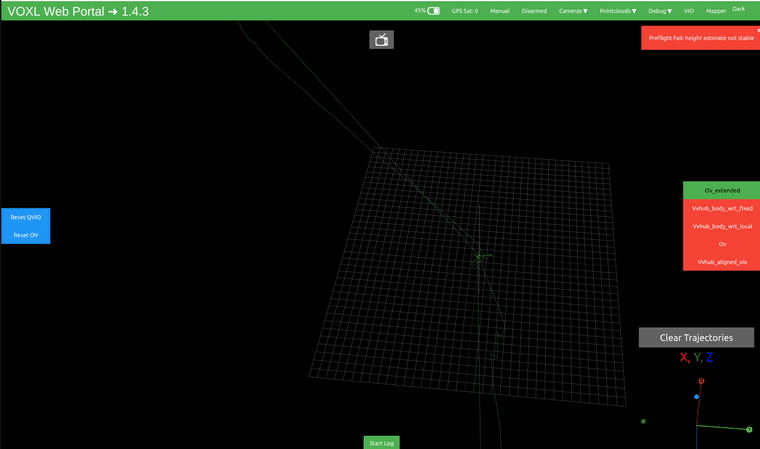

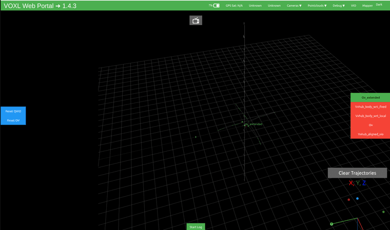

                  Also I tried moving the drone inside the drone cage and was able to get a trajectory similar to yours initially:
                  However, the results are inconsistent. Sometimes the trajectory is inaccurate, and the drone drifts away in the portal view:
                  Could this be related to calibration issues, or is VIO inherently unreliable in some cases? Could the drift be due to a lack of visual features in the environment?
