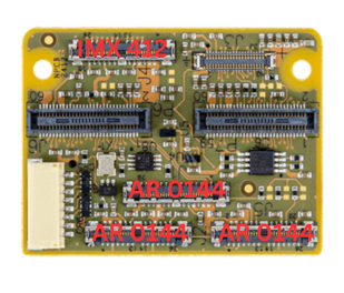

    Hi everyone,
    I'm working with a VOXL2 setup using the microcoax adapter (MDK-M0173-1-00), and I have three AR0144 and IMX412 cameras connected. (same connection used on starling2, without ToF sensor - image attached)
    I need to flip the IMX412 camera image upside down, but I haven't found a way to do this via the voxl-camera-server.conf file. In the past, I've managed this using the "imx412-flip" drivers found under /usr/share/modalai/chi-cdk, but the problem is that my IMX412 camera is assigned to ID 1, and there is no driver for that ID
    Is there a way to solve this problem?
    Thanks in advance for any help

      @robertociuch ,
      I just built the sensormodules for ID 1 and 5. Please test it out. A while ago we did not have hires camera support in these camera slots, so the sensormodules were not built. Please let me know if that works for you.
      https://storage.googleapis.com/modalai_public/temp/imx412_test_bins/20250430/com.qti.sensormodule.imx412_flip_1.bin
      https://storage.googleapis.com/modalai_public/temp/imx412_test_bins/20250430/com.qti.sensormodule.imx412_flip_5.bin

        robertociuch
        @Alex-Kushleyev
        Hi Alex, it works fine
        thank you very much!
