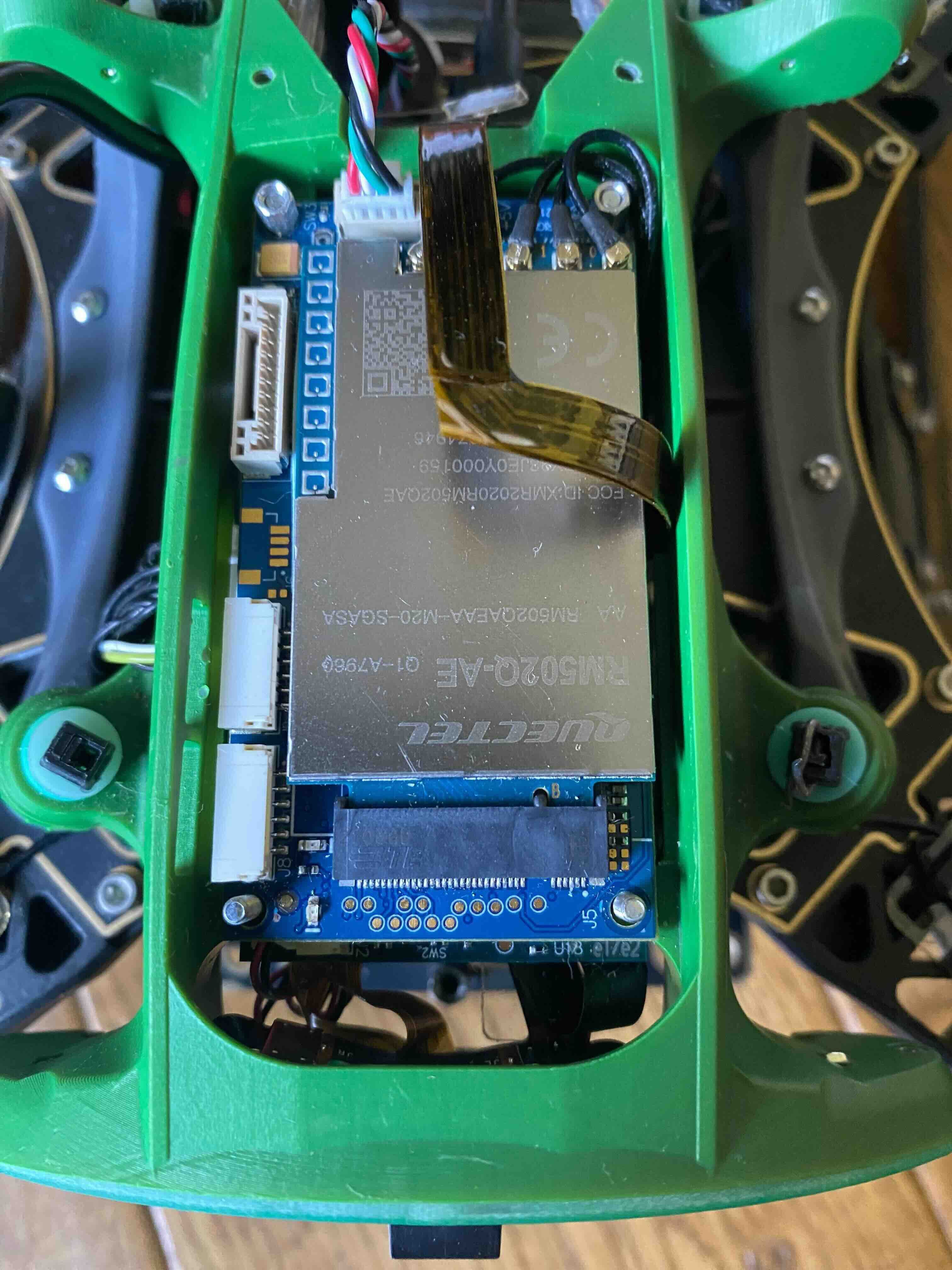

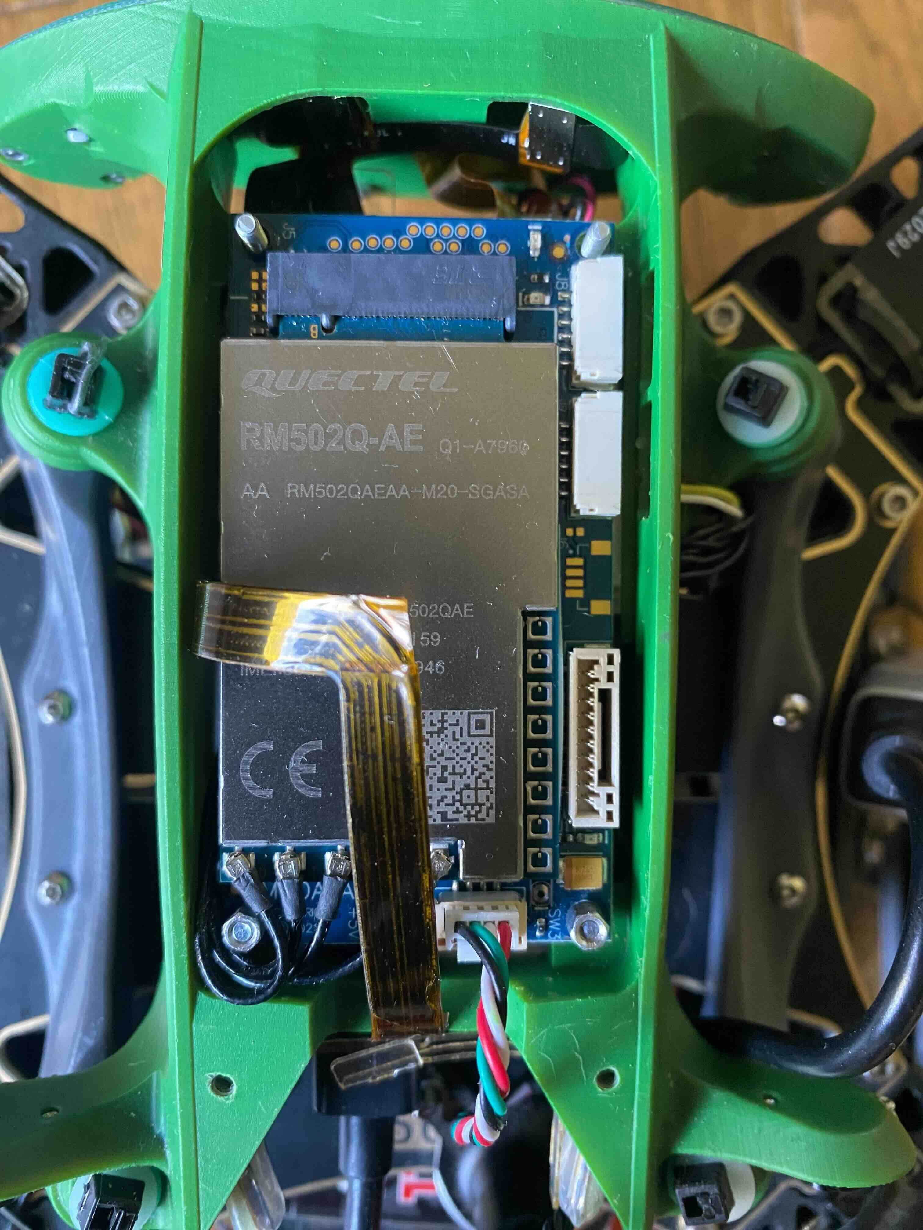

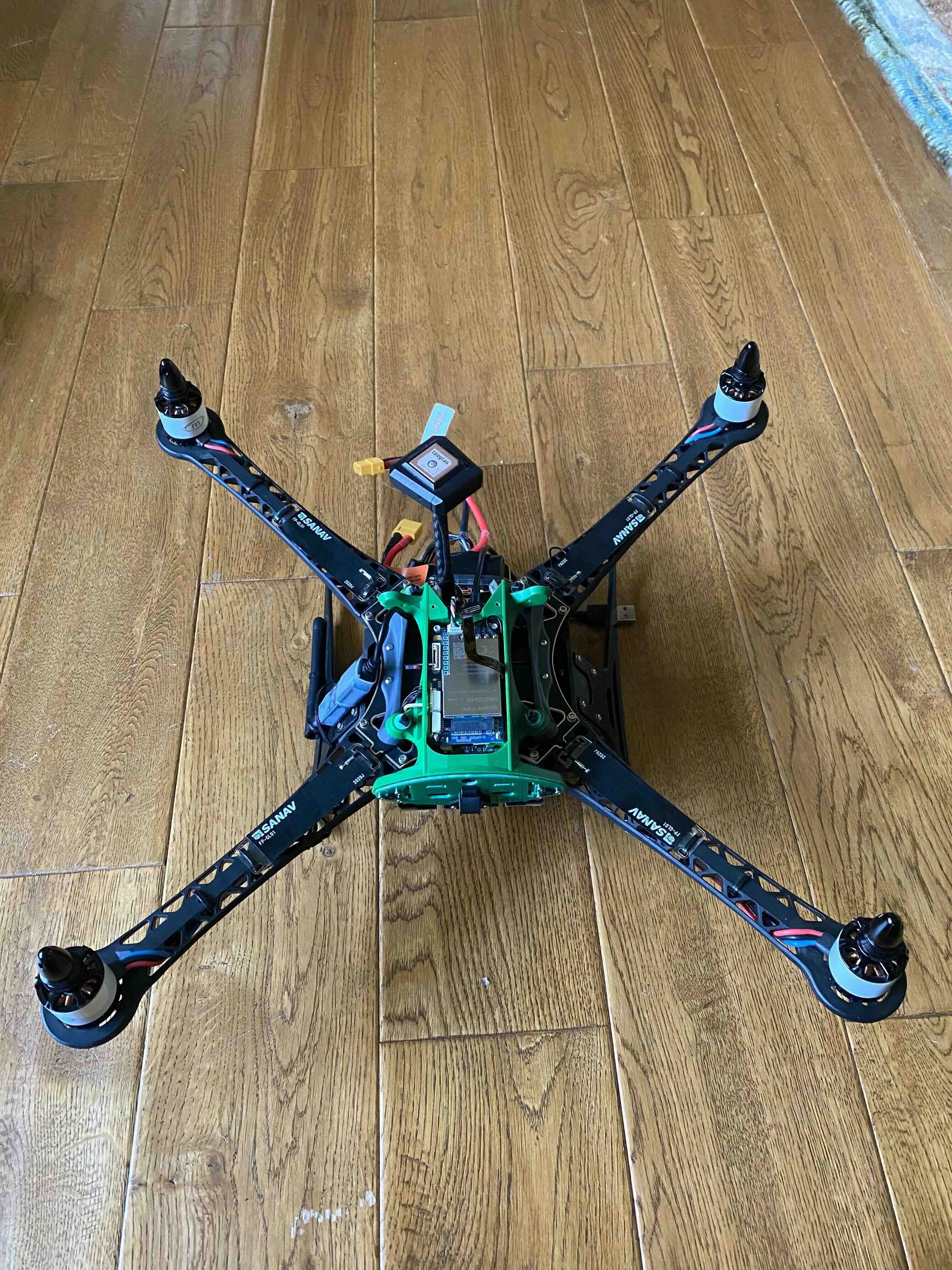

              • tomT
                tom admin @Jerry Lin
                @Jerry-Lin Yeah it doesn't seem as though the quectel modem is being detected at all. Can you post a picture of your setup as a sanity check?
                • Jerry LinJ
                  Jerry Lin
                  Sure,
                  I didn't touch anything except for opening the cover, unscrewing the nuts and inserting the SIM card.
                  • tomT
                    @Jerry-Lin Are you sure that the add-on board is fully seated onto the VOXL 2? There are two connectors that need to be fully seated
                    Jerry LinJ 1 Reply Last reply Reply Quote 0
                        @Jerry-Lin If you looks at the diagram here: https://docs.modalai.com/5G-Modem-datasheet/#block-diagrams
                        both J4 and J2 need to fully inserted into J5 and J3 of VOXL 2, seen here: https://docs.modalai.com/voxl2-connectors/#connector-callouts
                        • Jerry LinJ
                          Jerry Lin
                          Super cool, after all unscrewed and the modem taken out, I saw the connectors. Knowing how they connect, I pressed hard to make sure fully seated and the qmidevice_detect failed went away with the WiFi working!!!

                            For future note, please re-install the nut hardware on these screws or the boards can become separated again leading to more failures.
                            Please be careful to ensure they do not contact any of the circuit components on the PCB.
                            • tomT
                              @Jerry-Lin Awesome seems as though the hardware is working as expected now. I can't tell you what the correct APN is for your network, it very much depends on your plan, provider, etc. It's possible you need a SIM card specifically for IOT devices from your carrier
