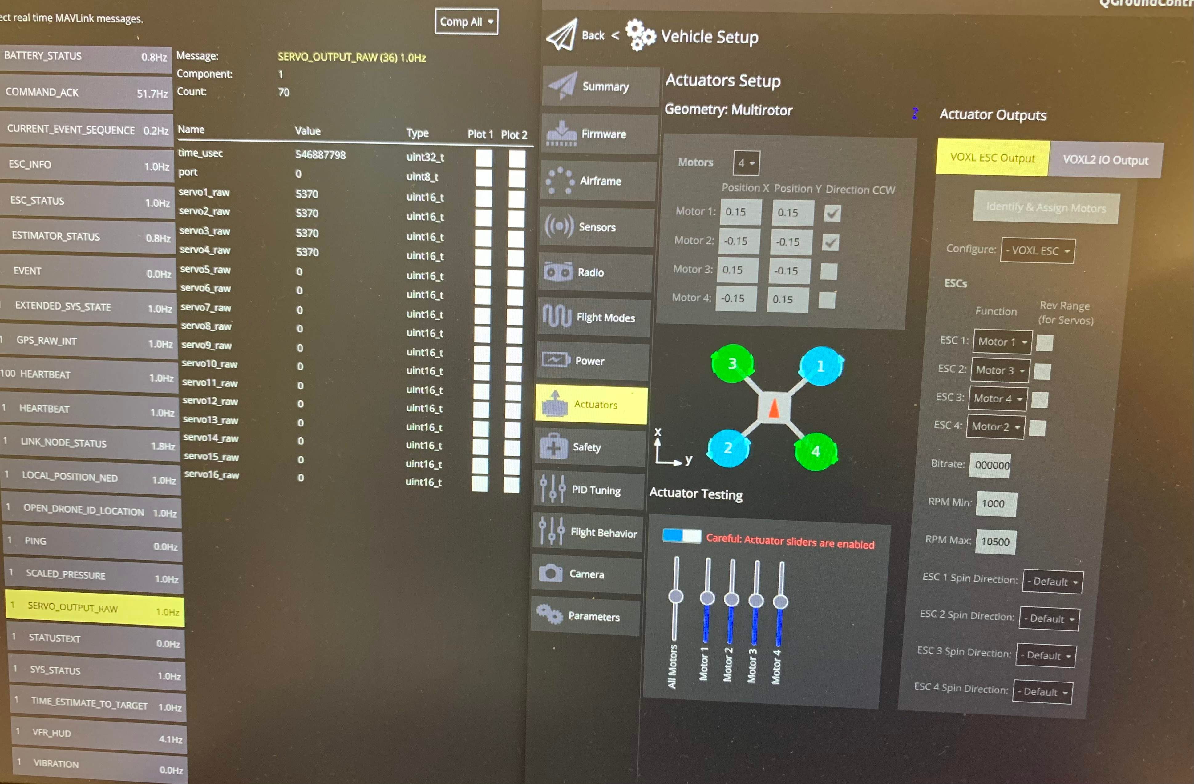

    I am working on two "Qualcomm Flight RB5 5G Platform Drones Reference Design - Qualcomm Flight RB5 5G Drone w/o Modem", bought in march of 2022. They were no used until now. While setting them up I encountered some errors.
    First of all I flashed both drones with the appropriate VOXL SDK as mentioned on the guide. After installing Qgroundcontrol I was conducting pre-flight tests and encountered problems with both drones:
    -For the first drone, the LED on the GPS module is flashing red however no error is being detected on Qgroundcontrol and all VOXL services are working fine. I suspect this might be due to not having a RC remote and being unable to manually arm the drone but I am not sure. I am also getting a missing parameter message: "missing params: 1:SDLOG_MOD". Other than that the drone seems to be working fine.
    -For the second drone however, it also exhibits the same problems as the first drone but it also has a motor failure. One of the motors is not responsive and exhibits no rotation at all when tests are conducted but no error arises on Qgroundcontrol. As shown in the attached images, while running a motor test one of the ESC's has an output of 0 in all parameters, but the servo output channel shows that they are all operating. Again as shown there is no error count or message displayed.
    K 1 Reply Last reply

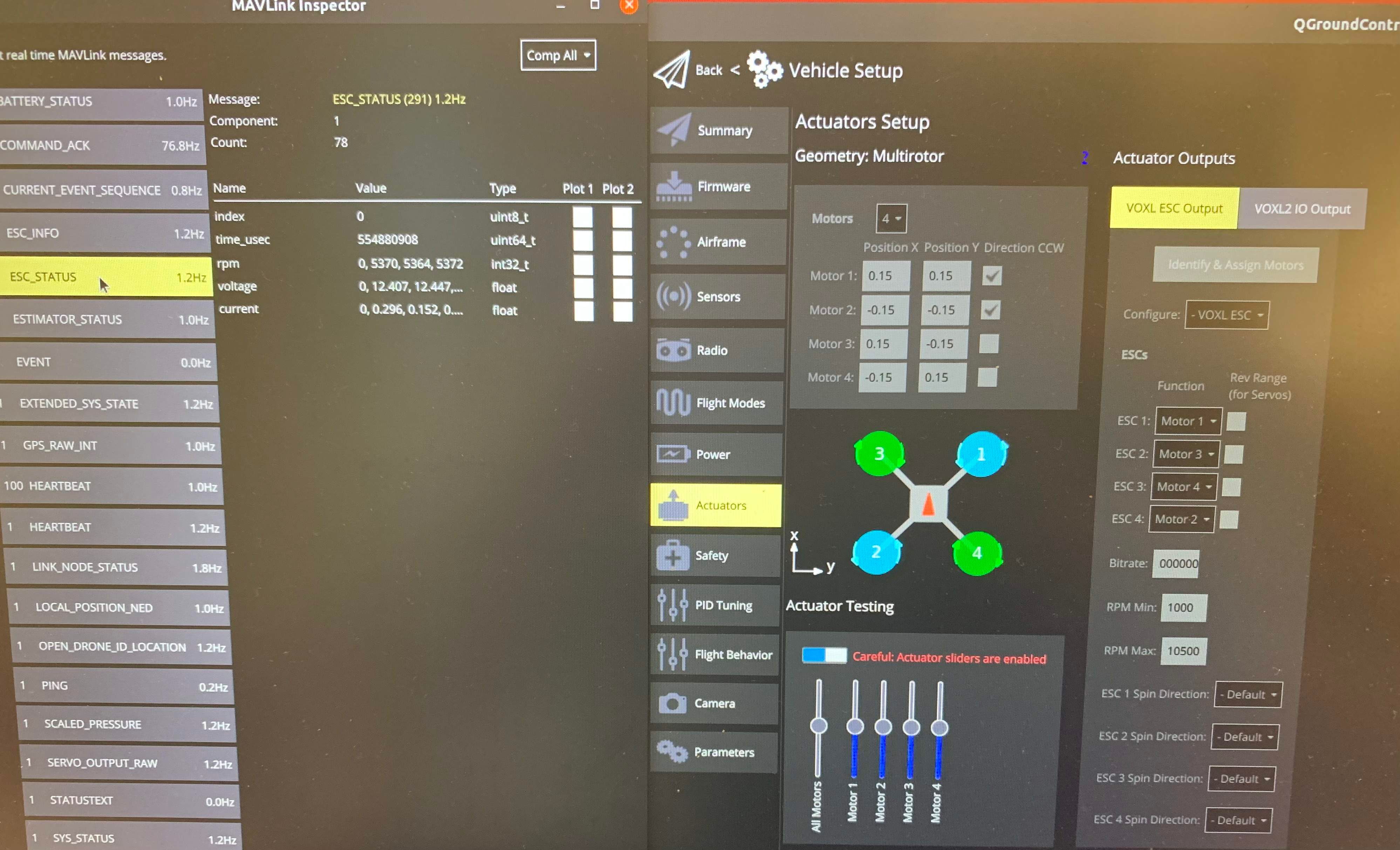

      This is the image showing no error count for the ESC's.
      ModeratorM 1 Reply Last reply
      • K kham
        ModeratorM Offline
        ModeratorM Offline
        Moderator
        @kham that software is really old. can you please start by upgrading the software? https://docs.modalai.com/Qualcomm-Flight-RB5-voxl-sdk-upgrade-guide/

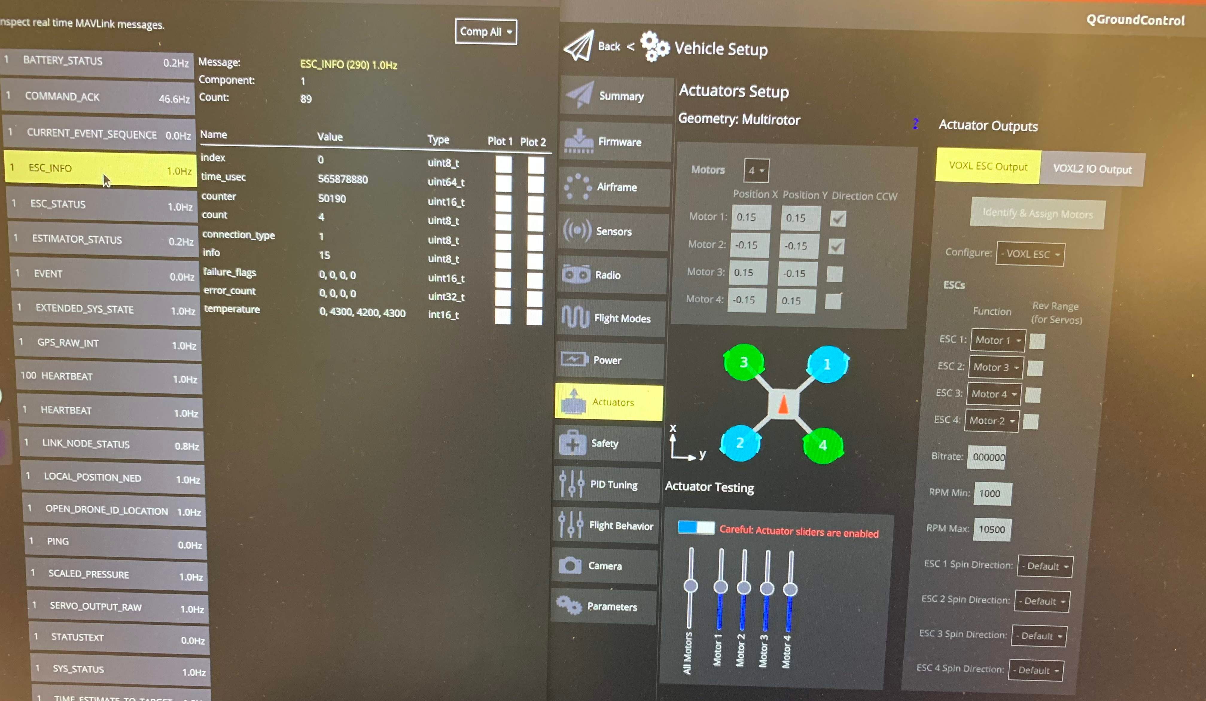

            @kham , can you please let us know which version of px4 you are using?
            voxl-version | grep voxl-px4
            Also in your plot above, i see the ESC reports temperatures as [0, 4300, 4200, 4300], for some reason the first ESC is not reporting temperature, there may be a configuration error of the ESC.
            Please try the following:
            #stop px4
            systemctl stop voxl-px4
            #scan for ESCs
            cd /usr/share/modalai/voxl-esc-tools/
            ./voxl-esc-scan.py
            And let me know what the ESC scan outputs. Thanks!

              @Alex-Kushleyev Screenshot from 2024-03-14 14-01-56.png Screenshot from 2024-03-14 13-56-50.png
              I ran the scan and it seems that one of the ESC's is not appearing on the scan.
