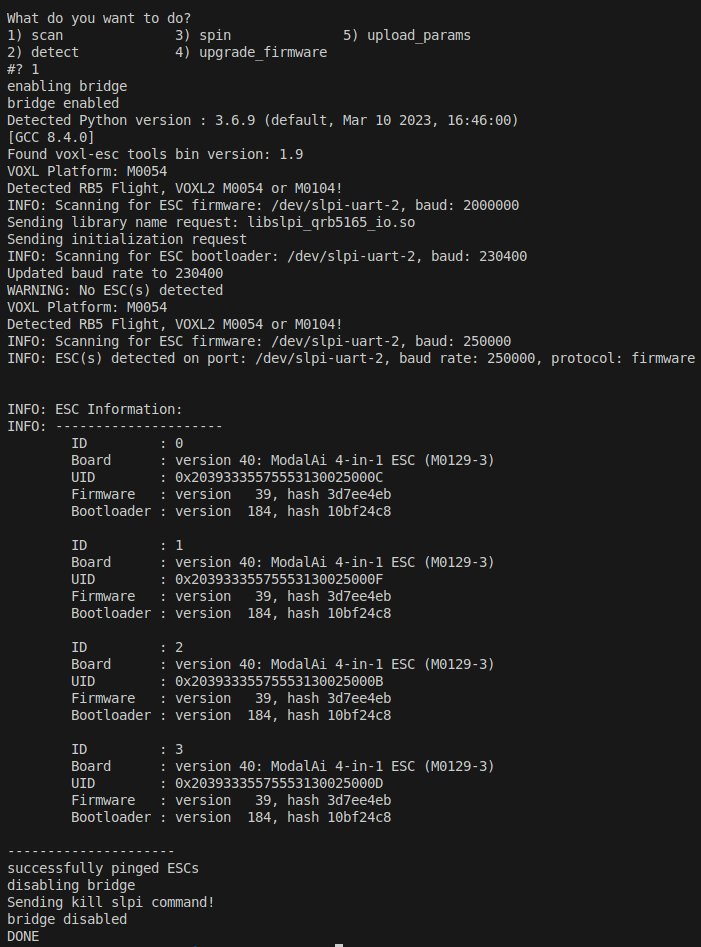

      Hello @Alex-Kushleyev and @Moderator ,
      Thank you for the response!!!
      As Alex pointed out, the baud rate seems to be the issue preventing the motors from spinning through the Actuator Testing feature in QGC. I have another ESC configured with a 2M baud rate, and it works as expected with Actuator Testing.
      My question now is: how can I update the baud rate on the ESC?
      In QGC, the baud rate is already set to 2M.
      In https://gitlab.com/voxl-public/voxl-sdk/utilities/voxl-esc/-/tree/master/voxl-esc-tools,
      I came across the command:
      ./voxl-esc-upload-params.py --params-file ../params/esc_params_modalai_4_in_1.xml
      However, I wasn’t able to locate this XML file on the VOXL.
      Here's what I found in the VOXL:
      In the repo I found is esc_params_modalai_4_in_1_revb_mn1804_2400kv_gemfan5040.xml
      Should I upload this xml to /usr/share/modalai/voxl-esc-params/boards/, rename it to esc_params_modalai_4_in_1.xml, and use the python command above?
      I also tried to manually change the baud rate to 2M in those XML files but it gets overwritten after a reboot.
      Could you please provide more detailed instructions on how to properly update the ESC baud rate?
      Thank you.

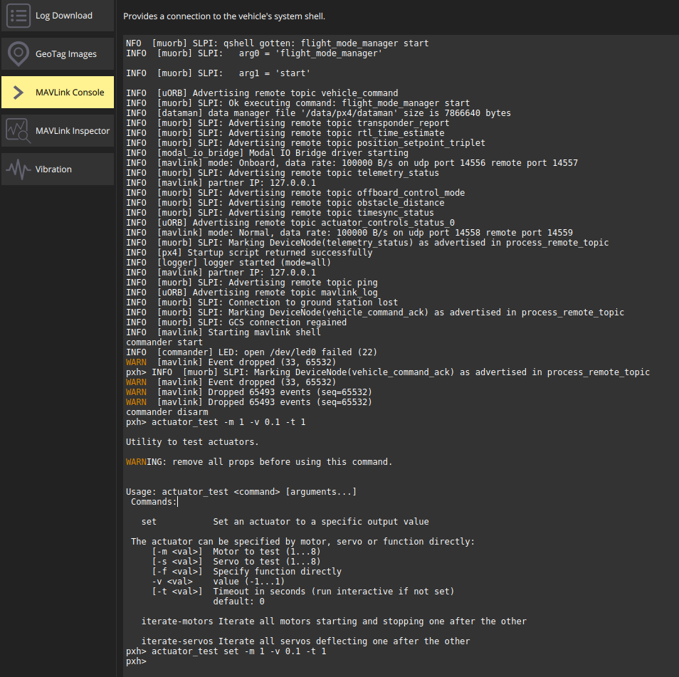

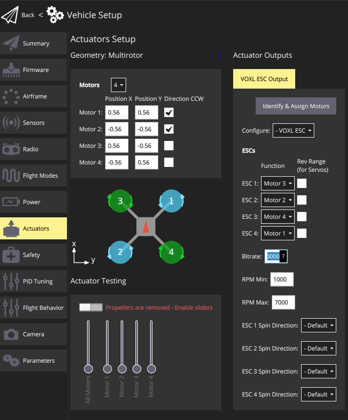

    • ESC Mini 4-in-1 M0129 is not controllable through QGC
      To whom it may concern,
      My VOXL2 Flight Deck is currently running the following SDK version:
      The ESC Mini 4-in-1 is using the following firmware version:
      I am able to successfully spin the motors using the command:
      voxl-esc 3) spin
      However, I am unable to spin the motors in QGroundControl using the Actuator Testing feature.
      Could you advise if there are any steps I might have missed?
      Additionally, I have connected the VOXL2 to a QGC instance running on an Ubuntu machine within the same network.
      I noticed that the ESC PWM Minimum and Maximum Calibration in QGC requires a USB connection.
      I attempted to connect the VOXL2 to the Ubuntu machine via the USB-C port labeled "U" in the VOXL2 datasheet, but it did not establish a connection.
      Could you clarify which port should be used for this USB connection to ensure proper calibration support in QGC?
      Thank you for your assistance and please let me know if you need more details.
      posted in Ask your questions right here!

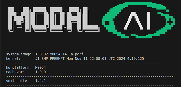

      Hello ModalAI Team,
      Here is the HW and SDK info
      • ModalAI Flight Deck M0054
      • VOXL system image 1.8.02-M0054-14.1a-perf
      • VOXL suite 1.4.1
      Thank you.

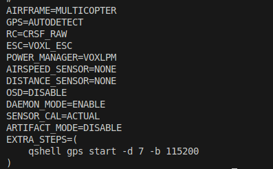

      @Eric-Katzfey
      From other discussion,
      I add
      qshell gps start -d 7 -b 115200
      and get the GPS now.
      Here is my setting and please let me know if any questions.
      Thank you for your precious time on this matter.
      AIRFRAME=MULTICOPTER
      GPS=AUTODETECT
      RC=CRSF_RAW
      ESC=VOXL_ESC
      POWER_MANAGER=VOXLPM
      AIRSPEED_SENSOR=NONE
      DISTANCE_SENSOR=NONE
      OSD=DISABLE
      DAEMON_MODE=ENABLE
      SENSOR_CAL=ACTUAL
      ARTIFACT_MODE=DISABLE
      EXTRA_STEPS=(

      NOW the remaining issue I have is no GPS fix.
      The output from voxl-inspect-gps is
      dt(ms) |fix type|Sats|Latitude(deg)|Longitude(deg)| Alt(m) |Vel(m/s)|HorErr(m)|AltErr(m)|
      124.9 | NO GPS | 0 | 0.0000000 | 0.0000000 | -17.0 | 0.00 | 4294967.295 | 3794659.840 |^C
      In voxl-px4.conf
      I tried GPS=AUTODETECT and GPS=MRO, but none of them works.
      I connect Taoglas GPS "Classic" M9N w/IST8308 - M10034 to the J19 port.
      Here is the full configuration in the voxl-px4.conf
      GPS=AUTODETECT
      RC=CRSF_RAW
      ESC=VOXL_ESC
      OSD=DISABLE
      DAEMON_MODE=ENABLE
      SENSOR_CAL=ACTUAL
      EXTRA_STEPS=()
      Also there is no output from
      cat /dev/ttyHS0
      cat /dev/ttyHS1
      cat /dev/ttyHS2
      cat /dev/ttyHS3
