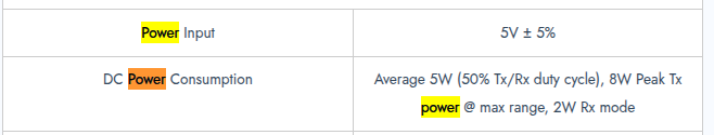

      Hello @Vinny
      After checking with my coworkers, we confirmed that the Doodle Nano radio receives 5 V power through its connection to the ModalAI ESC, not as I previously described. Sorry for the earlier confusion.
      Does this clarification help you suggest the next step we can take for verification?
      We also refreshed the SDK on the VOXL2, but the issue persists, so we can likely rule out software as a potential root cause.
      Looking forward to hearing from you. Please let me know if any further questions.

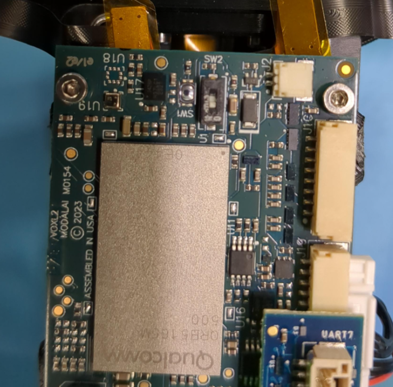

    • RE: Malfunction the J connector on VOXL 2 investigation
      Hello @Vinny
      thank you for the response.
      I understand and appreciate your point about the incorrect power configuration,
      and we will definitely work on addressing that.
      However,
      the same board with the same Doodle Nano works properly on other VOXL2 units.
      This suggests that even with the incorrect power, the Doodle Nano remains functional and can still communicate with other Doodle Nano devices.
      For this reason, we’d like to investigate whether the J port itself is still functioning.
      Could you suggest any methods we can use in our lab to verify if the J port on this particular VOXL2 is operational?
      Or besides the power configuration part, any other spec you would recommend we investigate?
      posted in Ask your questions right here!

      @tom
      Thank you for the quick response.
      However,
      it doesn't explain why the same board with the same doodle lab nano radio works with the VOXL 2 previously ( just suddenly doesn't work anymore ) and work with other VOXL 2.
      And
      we are using
      https://techlibrary.doodlelabs.com/doodle-labs-nano-oem-mesh-rider-radio-24002482-mhz
      It doesn't require that much power
      please let me know if any misunderstanding, any suggestion, or any command/method we can use to verify the J port
      Thank you.

    • Malfunction the J connector on VOXL 2 investigation
      To whom it may concern,
      Is there a command or diagnostic procedure to verify the operational status of the J port on a VOXL2?
      Details:
      We have integrated a board that includes a radio device with the VOXL2 via the J port. Initially, the VOXL2 detected the connection and the interface appeared as eth0. However, this VOXL2 has since stopped recognizing the connection. When the same board and radio device are tested with a different VOXL2, the connection is detected normally, which suggests the problem is isolated to this particular unit.
      Could you advise on tools, commands, or logs that can be used to determine whether the J port hardware or the associated network interface on this VOXL2 is functioning correctly?
      Please let me know if you need more details or questions
      Thank you.
