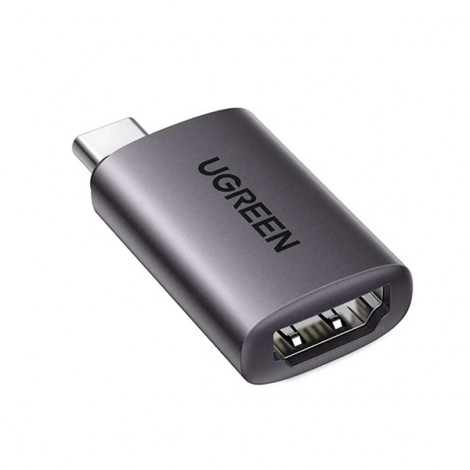

  • Please review on required add-on's with VOXL2 for CAN, HDMI, S-BUS and PWM
    H Huynh Gremsy
    @J-B-Song Hello J.B Song, Did you connect HDMI via USB-C on VOXL2? Did you use this image
    Hope your reply soon, thanks so much.
