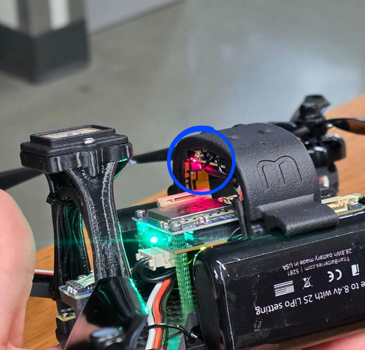

    • A red light on the top portion of the drone flashes continuously. I initially thought this indicated that the drone was not connected to the controller. However, the light continues flashing even after the Commando 8 controller is connected and the drone can be controlled successfully. What does this flashing red light indicate, and what steps should I take to diagnose or resolve it? A picture is attached below:

          I am able to download the log from the site along with all of the parameter settings. The accelerometer bias is clear in the log. Can you try to recalibrate the IMU with air flow on the unit to keep it from getting too hot? The yaw estimate error is not active during the log. However, to remove the interaction with VIO, try setting EKF2_EV_CTRL to 0 and see if that clears that occasional error. If it does then that helps narrow the issue to the VIO input versus the magnetometer / IMU input. Is the red light on the GPS unit or the RC receiver?

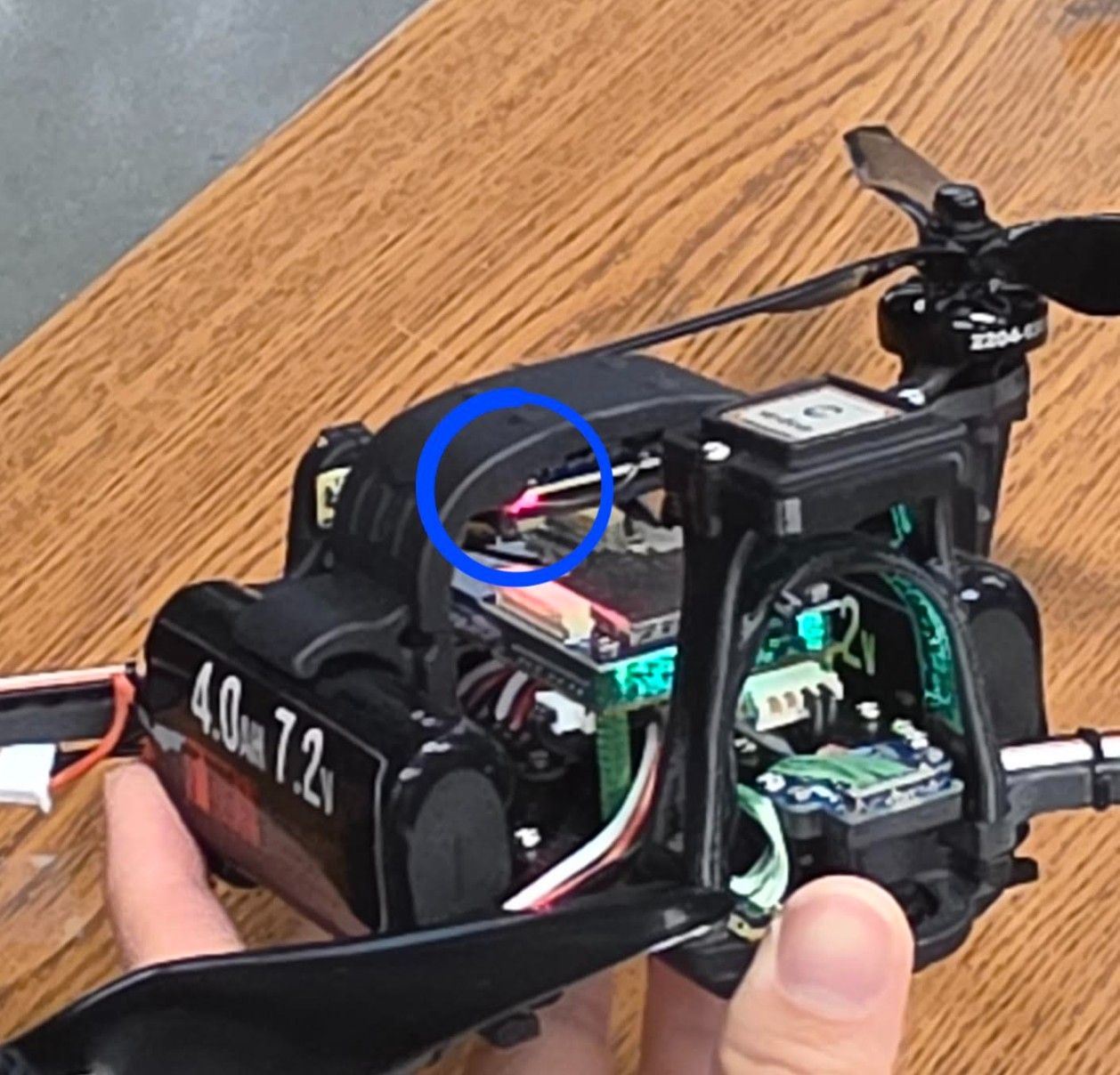

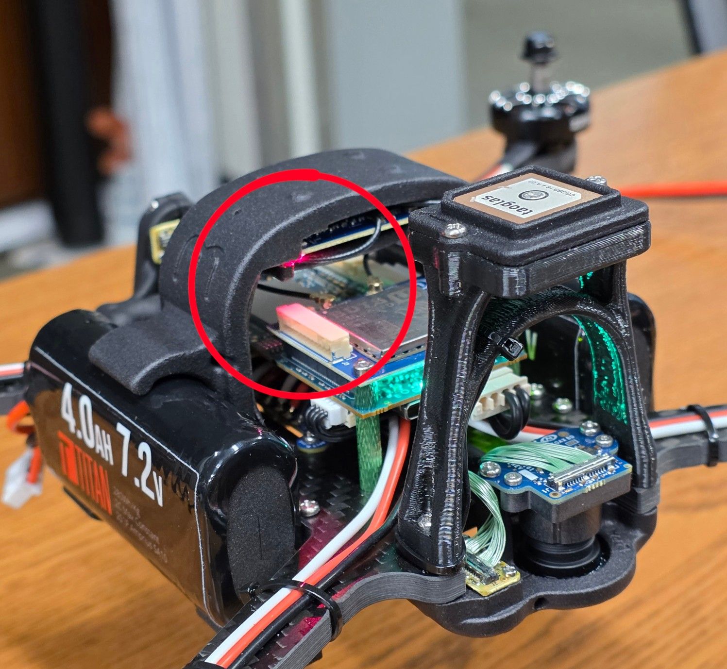

            The error intermittently still appears even when I recalibrate the IMU with airflow on the unit. I will try setting EKF2_EV_CTRL to 0 and report back. I am not sure which component contains the flashing red light, since I could not find a labeled diagram of the drone’s parts. I attached additional photos that hopefully make its location clearer:

              That red light is for the M0184 ELRS receiver. A constant slow blink from the light means it is disconnected. It will turn solid with a connection. Other LED states are documented here.
