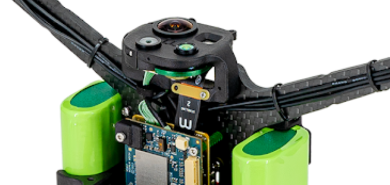

    For the starling 2 max C28 config, is it possible I could add the tof sensor that you sell to it without sending it back in?
    How is this typically mounted? The flex cable on the tof sensor seems pretty short. Is there an extension cable?
    Thank you,
    John
    • J jbiscan21
      Thank you,
      John

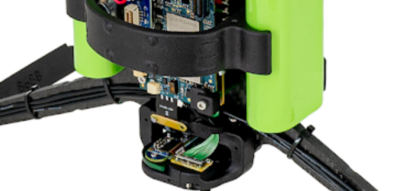

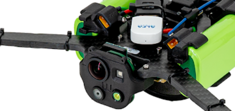

      @jbiscan21 , yes you can add the TOF sensor to Starling 2 Max, but you will also need a new front plastic mount that will hold the hires and tracking cameras as well as the new TOF sensor.
      You can order the mount (which will be a drop in replacement for the original camera mount) with the TOF sensor. If you do want to proceed with the TOF sensor + plastics order, we will need to double check that all the necessary screws are included. You would need to send an email for a custom order to start this off and mention this thread and that we need to include mounting hardware. https://www.modalai.com/pages/contact-us
      (related post : https://forum.modalai.com/topic/5157/c29-configuration)
      See more detailed pictures.
      R Timothy ZinwotaT 2 Replies Last reply

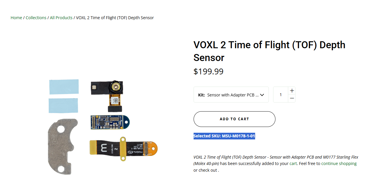

                    @Alex-Kushleyev We are trying to purchase the TOF sensor for our Starling 2 max c28 configuration. The sales department asked to make a post on the forum for technical information which I did here
                    Can you confirm if we can also reference this post to make the purchase for our drone with the required parts included? We'd like to place an order as soon as possible.
                    Thank you,
                    Timothy Zinwota
