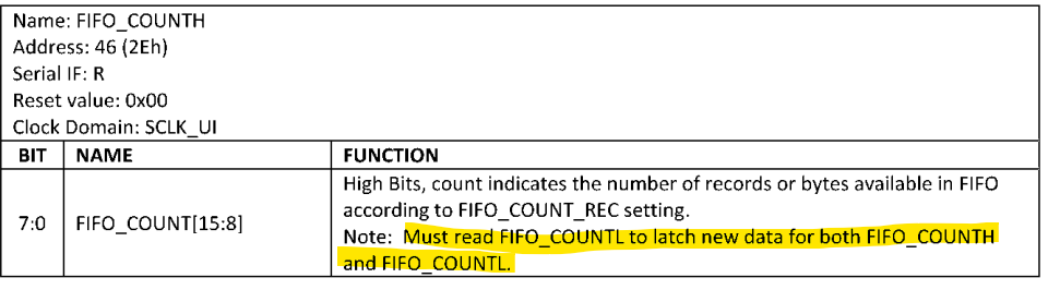

    Bug 1: Incorrect FIFO_COUNT Latching Sequence (Race Condition)
    Location: src/drivers/icm42688.c (inside read_imu_fifo)
    The current implementation reads fifo_count starting from FIFO_COUNTH (0x2E).
        // first read how many bytes are available using the fifo_count register
        ret = voxl_spi_read_reg_word(bus, count_address, &fifo_count);
    but acording to IMU document we must read FIFO_COUNTL to latch the data

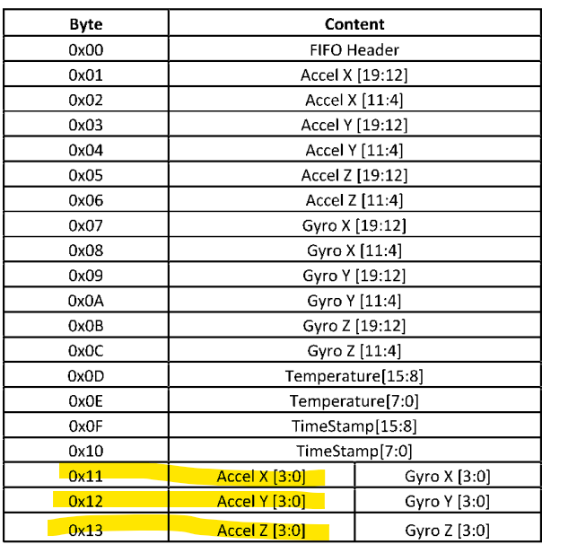

    Bug 2: Index Mismatch in 20-bit HiRes Packet Parsing
    Location: fifo_read function under #ifdef HIRES_FIFO
    Technical Detail:
    When parsing Packet 4 (20-byte), the code maps the extension bits (lower 4 bits) incorrectly for the accelerometer.
    		ax32 = ((int32_t)ax16 << 4) | ((base[11] & 0xF0) >> 4);
    		ay32 = ((int32_t)ay16 << 4) | ((base[12] & 0xF0) >> 4);
    		az32 = ((int32_t)az16 << 4) | ((base[13] & 0xF0) >> 4);
    It uses byte indices 11, 12, and 13, but these correspond to Gyro Z and Temperature data. The correct indices are 17, 18, and 19.
      Technical Detail:

        @Igor ,
        You are absolutely correct about the incorrect parsing of the accel data. This is a typo and it was not detected because the effect of it is very small (4 LSB of the 20-bit number). The accelerometer noise in flight will dominate and these bytes will have no effect. We will fix this bug.
        Regarding the order of the reading of FIFO_COUNT, we looked at many other sources, including the reference code from TDK and all the implementations read the FIFO_COUNTH first, so we suspect that the documentation has a typo (which makes sense, otherwise the implementation would have to have separate transactions for reading the H and L parts).

          @Igor ,
