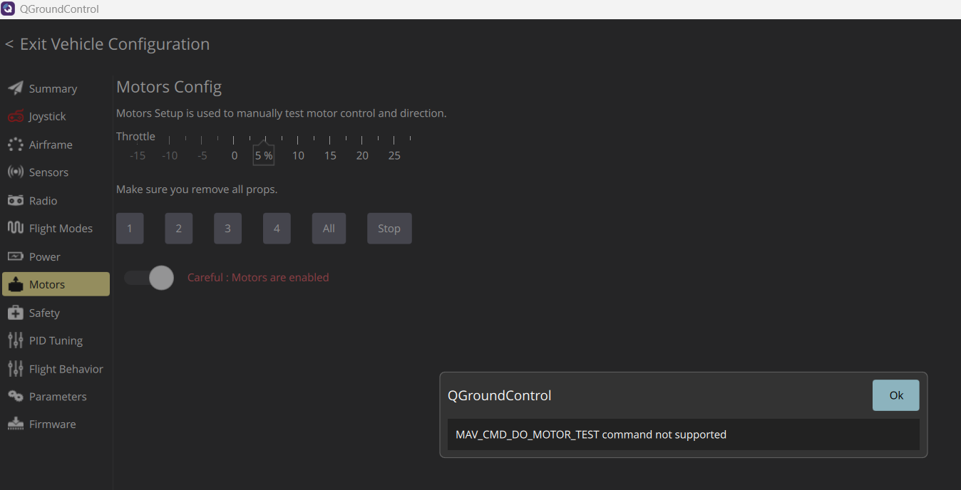

          @Eric-Katzfey Thanks, just tried that, but got this error: 2026-02-11 11_25_32-Clipboard.png

            @Myles-Levine You should see an actuators tab. Do you have our standard VOXL SDK loaded on the drone?

            • Myles LevineM
              Myles Levine @Eric Katzfey
              @Eric-Katzfey How do I check?

              • Myles LevineM
                Myles Levine @Myles Levine
                @Myles-Levine Nevermind, I got it working through the voxl interface instead of Qgroundcontrol. Thank you.
