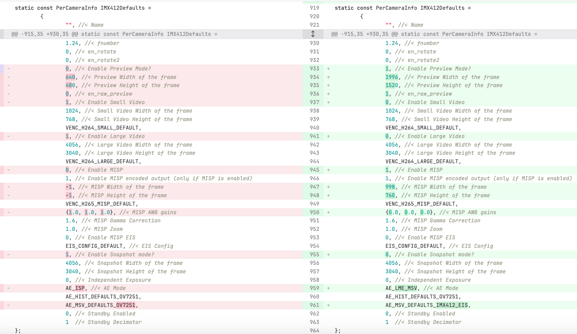

              I know you talked about some resolution advice above, but I'm a little bit confused on the specifics on where to put those numbers. You had suggested 1996x1520 for a 5.5ms readout time. Do these numbers go into the Preview Width config fields? Here is the entire diff of the config settings I have been using for my testing:
              The other values I have a question about in that diff is The MISP width / height fields, I chose 998x760 which is half of the Preview Width resolution you suggested. I did this because I wasn't sure of any compute bottle necks that would pop up if I fed a 1996x1520 image into QVIO. Do you think 998x760 is good or maybe I should pick a like 0.75 downsample so something like 1497x1140 for the MISP width/height.

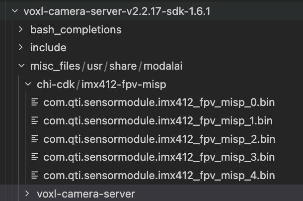

              Camera Driver files to use and how to version control and deploy those
              Could you confirm that the binary files in https://storage.googleapis.com/modalai_public/temp/imx412_test_bins/20250919/imx412_fpv_eis_20250919_drivers.zip are still the latest and the recommended binaries to use? Could you also advise on how to version control these files and deploy them to the voxl2 when the camera server .deb is deployed? I want to keep all files related to bringing up the camera in the voxl-camera-server debian if possible. I see some binaries files being stored in this path:
              So if I understand the process correctly, those files will end up in /usr/share/modalai/chi-cdk/imx412-fps-misp. Is that where the voxl-configure-cameras C looks for them? Also, do I have to do anything with the com.qti.sensor.imx412_fpv.so file in the zip link that you sent, or do I just ignore that file?
              My end desired behavior is that when I install the voxl camera server .deb, I don't have to worry about also copying binary files over to the voxl, or moving any files around on the voxl, or having to remember to run voxl-configure-cameras C. So maybe the path forward there is to have all files deployed into the right places by the .deb install and then in the postinst script auto run voxl-configure-cameras C? What do you think?
              Aspect ratio concerns and their affect on field of view and camera calibration
              Is the aspect ratio you suggested (1996x1520) the actual aspect ratio of the sensor? Or does the sensor support multiple aspect ratios, or is there something more complex going on I don't understand here? I just want to make sure that we're using as much FoV as the sensor supports. That should be the goal for VIO feature detection and for streaming right, maximize field of view?
