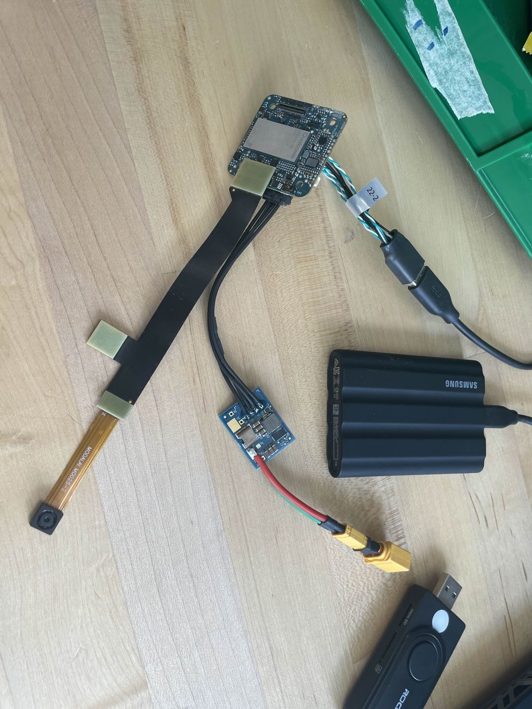

          Hi @jonathankampia
          Can you please post some pics of your setups?
          I cannot tell exactly how you are using J3, and which version of VOXL 2 Mini do you have? M0104 or the new rounded corner M0204 with fixed SS lines?
          Do you have a spec of the SSD you are trying to use? What other 5V peripherals are you using. We could be pulling too much current, since V2 Mini only has 900mA TOTAL 5V support so other 5V peripherals will eat into that budget.

            @Vinny We have the M0204, good to know that the usb3 SS lines are fixed. As I am just doing bench testing, the only other device I have plugged in is the IMX214 hires camera (which I am trying to log frames of).
            Spec wise I have been testing with a Samsung T7 shield connected over USBC, their docs weren't super clear but it seems like it consumes maximum 7.5W at 5V, so that could be the issue. With USB3.2 connection they claim it can reach 1GBps writespeed, and we are under 1/10th of that in requirement (we require about 93MBps).
            I could splice in auxiliary 5V power to see if that helps.
