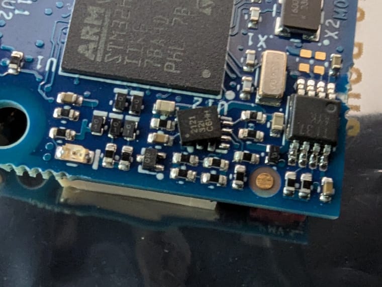

I've had almost the exact same thing happen but I think ours got hot enough to desolder a part (see pictures). Feels like a manufacturing issue. Is there a way to send it in for an RMA/replacement/etc?
Here is more info:
We have a FC2.
The FC2 is brand new (purchased within the last couple months).
We did the following:
- connected the USB cable '10' to J3.
- connect a known working micro-usb cable to my laptop running QGC.
- didn't here the usual windows 'new usb device sound'
This was the first time we connected this board. We didn't see any LED's turn on within a second or two so we picked it up by the corners and noticed it was VERY hot.
We quickly disconnected everything.
We inspected the board and found a component on the bottom looks like it shifted off it's solder pads. See attached picture. We didn't inspect the board before hadn
What could have caused this? Especially given a few others have had this.
Here is more info:
We have a FC2.
Hi @Martin-Lukac
Well that's not good. Your board will not work with that chip busted off like that.
Please use our RMA process and we'll get this assessed for for you:
https://www.modalai.com/pages/rma -

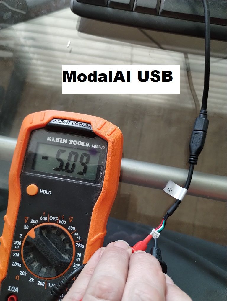

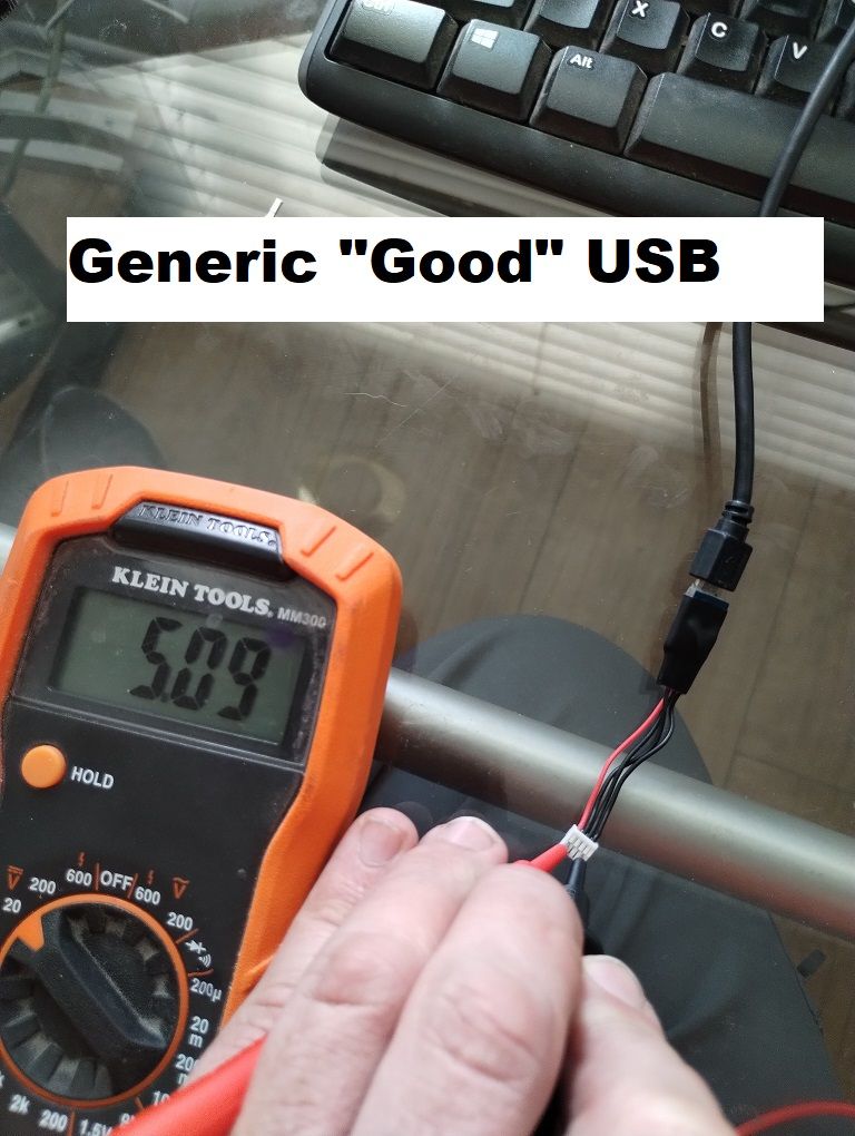

@Vinny I hate to say this, but I believe you have a batch of defective USB cables. I was running into the same issue as @VictorG and @Michael-Mortensen , so I broke out the multimeter and confirmed that 5V and GND are swapped (note the negative 5V instead of +5V). I grabbed another generic USB cable that I had on-hand and the FCv2 powered up and connected to QGC fine.

Hi @hula
Interesting. I will investigate. The cable appears as it should according to our tech docs and every batch is sample tested but I will inspect further and respond tomorrow.

Hi @hula

VinnyHi @hula
YOU ARE CORRECT!
I found a whole bag of mis-wired MCBL-00010's in our inventory.
I'll work with our @Moderator to figure out a plan.

Hi @hula
YOU ARE CORRECT!
We will likely need to setup an email where any customer can let us know if they have offending cables and we will send replacements promptly. -

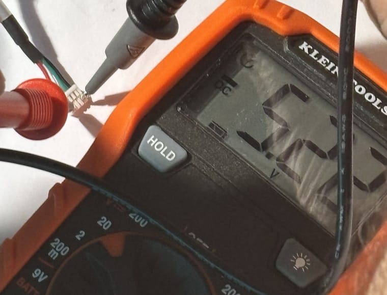

I just tested my cable and it is the same issue that caused mine to melt. I sent my board for RMA so I'll respond to that email thread.
FYI it is possible to pull the pins out and swap them, but it weakens the little plastic retaining piece so it is not as solid anymore ... and it makes it confusing since the red is now ground.
When you all are testing, can you also confirm that the two USB wires are not swapped. Thanks!

I submitted the RMA, sent back the FC2 and got a replacement, along with two MCBL-10 cables. Before attempting to flash it with QGC I checked the voltage as lo and behold both cables showed -5.22 volts. Picture attached. Glad I did the test first or I would have fried the replacement FC2
