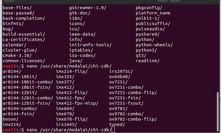

        @Alex-Kushleyev the chi-cdk directory does not exist. here is the content of the /etc/modalai/ directory:
        voxl2-mini:/etc/modalai$ ls
        extrinsics.conf voxl-camera-server.conf voxl-px4-hitl-set-default-parameters.config
        extrinsics.conf.thermal voxl-cpu-monitor.conf voxl-px4.conf
        lost+found voxl-dfs-server.conf voxl-streamer.conf
        network_interface_preferences.txt voxl-elrs.conf voxl-tag-detector.conf
        tag_locations.conf voxl-imu-server.conf voxl-tflite-server.conf
        vio_cams.conf voxl-mavlink-server.conf voxl-uvc-server.conf
        vio_cams.conf.boson voxl-modem.conf voxl-vision-hub.conf
        vio_cams.conf.seek voxl-px4-fake-imu-calibration.config voxl-vtx.conf
        T 1 Reply Last reply

          @Alex-Kushleyev I have now found the correct file in the /usr/share/modalai/chi-cdk directory. Now everything works as it should. Many thanks for your support!

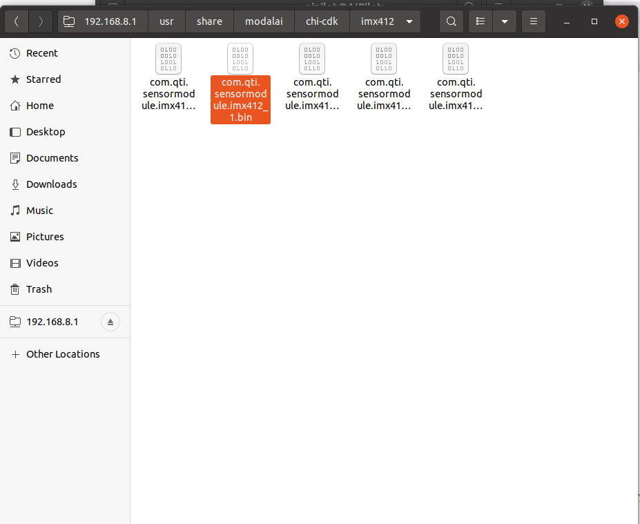

                  These are the files available
                  IMX412 has four options IMX412 , IMX412-flip , IMX412-fpv, IMX412-fpv-flip
                  IMX412-fpv is the only folder which contained option for camera 1 , other folders there was no option for camera number 1, so i created it by copy a file from that folder and renaming it for camera 1, I would like to know whether it was the right approach.
                  The highlighted option in the following images are the files I created.
                  IMX412

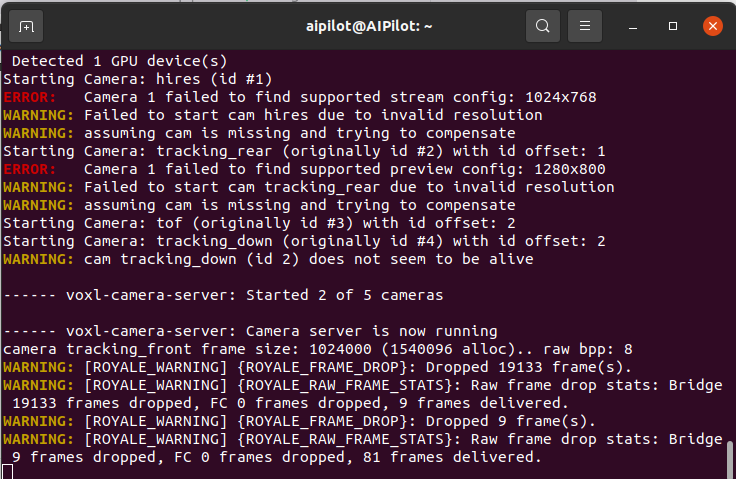

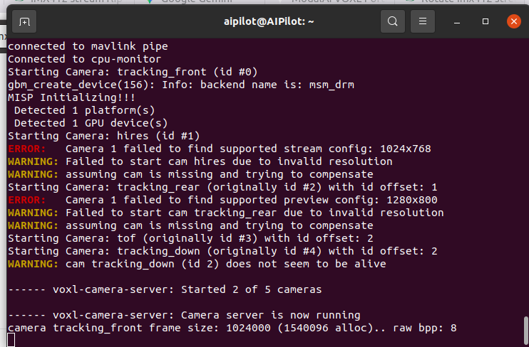

                  While running with with file form any of the three other options other than the imx412-fpv the camera was not detected .

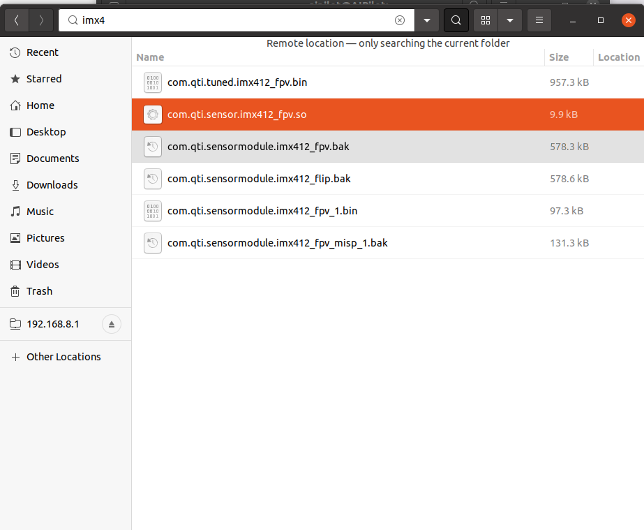

                  I copied the file from the /usr/share/chi-cdk/imx412 *** to the /usr/lib/camera/ folder, after while I try to run the camera server, only the tracking and TOF is recognised, I don't know what is the error.
                  I am using the configuration 27 for camera setup, but I am only using 1 tracking, 1 hires and 1 TOF.
                  Hires is the camera 1

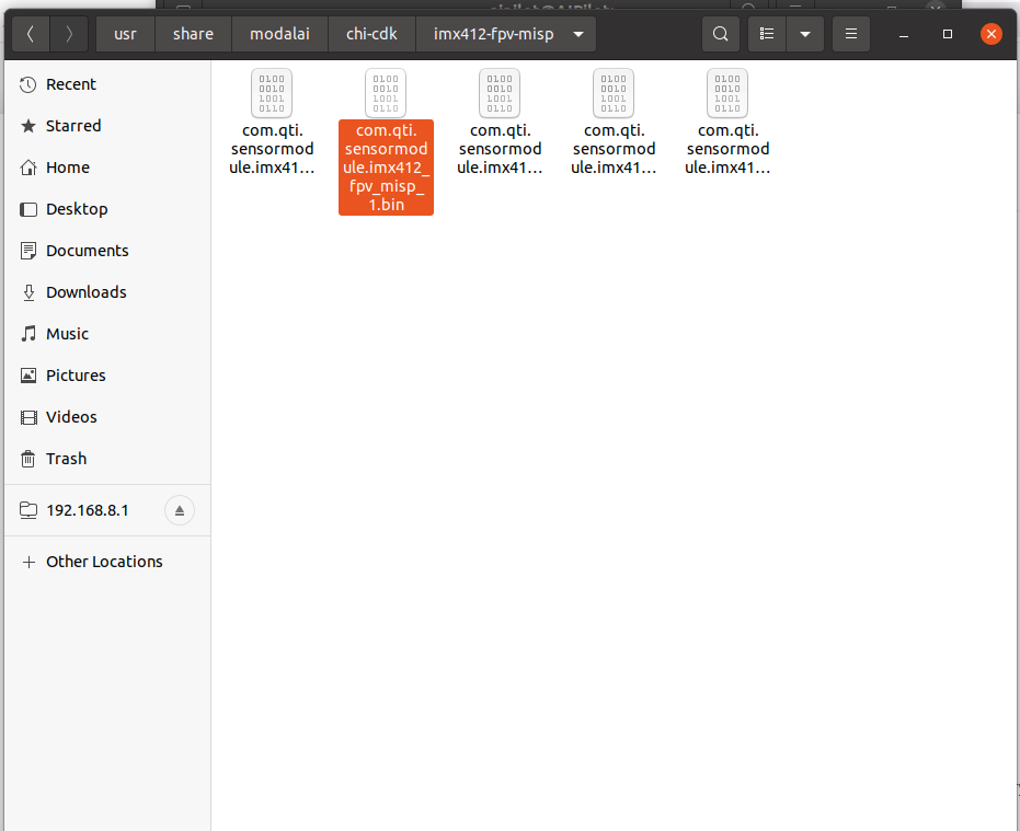

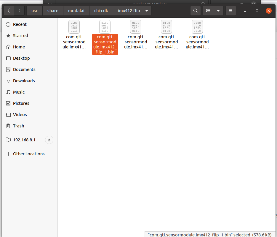

                    IMX412
                    IMX412-flip
                    IMX412-fpv-misp

                    #14
                    @Jetson-Nano , I just posted the latest drivers for IMX412 in the following location, which includes the normal and rotated drivers : https://storage.googleapis.com/modalai_public/temp/imx412_test_bins/20250919/imx412_fpv_eis_20250919_drivers.zip
                    Please note that if you are using MISP, the rotated drivers will have the reversed bayer order (BGGR and not RGGB), so you will need to let MISP know about that by using the following parameter in voxl-camera-server.conf (otherwise your red and blue colors will be flipped):
                    "bayer_type" : "bggr"
                    If the bayer type parameter does not fix the color order, then you will need to update voxl-camera-server, so that it includes the following commit : https://gitlab.com/voxl-public/voxl-sdk/services/voxl-camera-server/-/commit/a58128d3da61c3aea19d6db6c22e7176a04ae1db
                    If you are using the ISP output, then it will know the bayer pattern type directly from the sensormodule file, so you do not need to add the bayer_type parameter.
                    To answer your question about renaming sensormodules - changing the name does not change its functionality. The slot IDs are part of the sensormodule, not the name, so you cannot create a new sensormodule by just renaming the file to switch the camera slot ID.
                    Please try the new drivers and if you are still having issues, please do the following:
                    • disable all the cameras except for your imx412 (in camera config)
                    • share your camera config section for the IMX412 camera
                    • share the output of the camera server when you run it
                    Jetson NanoJ 1 Reply Last reply

                        #16
                        @Alex-Kushleyev Thank you for sharing the files and the support, I was able to flip the video by using the flip file for camera 1. Now it is working fine.
