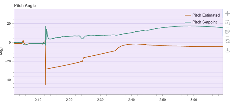

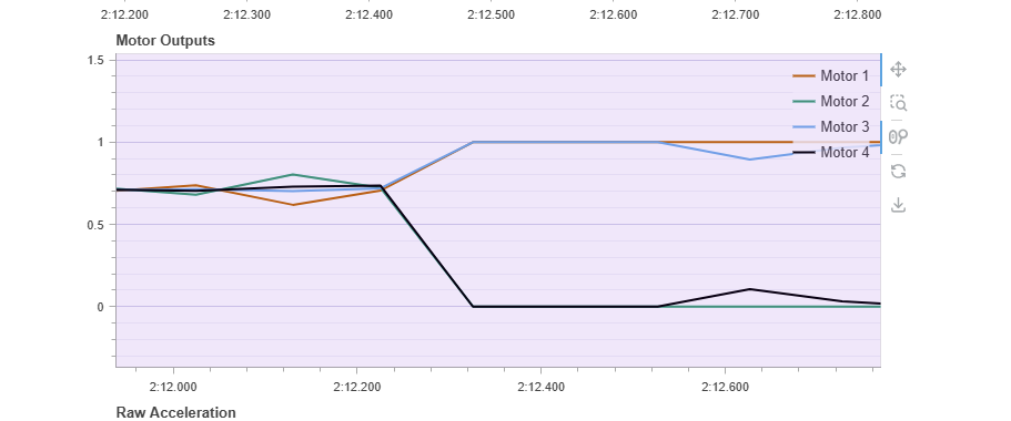

      Here is the PX4 flight log, which shows interesting actuator behavior:
      https://review.px4.io/plot_app?log=518ccf49-36ed-4509-b928-da3dda44c7fd
      The motor output diverges significantly around 2:12

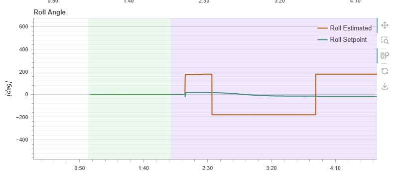

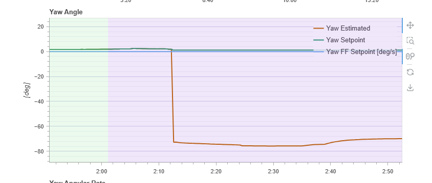

      At this time, the roll angle, pitch angle, and yaw angle executed deviated significantly from the commanded values:

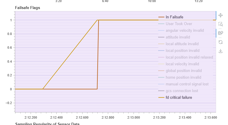

      Lastly, there were no failsafe flags indicating a loss of sensor input (e.g., EKF divergence, GPS loss, etc)....
      [Only non-zero streams have been selected in the image below]
      Could this be an issue with the actuation commands coming from the VOXL2?

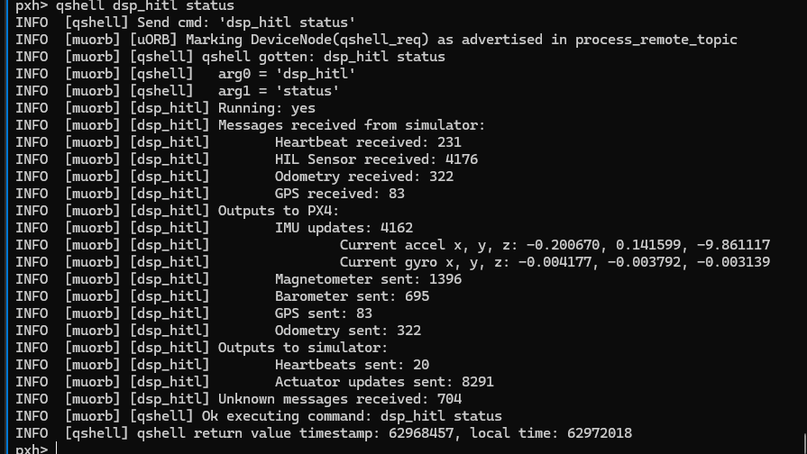

      • S Offline
        S Offline
        shawn_ricardo
        Here is a readout of the qshell dsp_hitl status command, just to validate the connection:
        • S shawn_ricardo

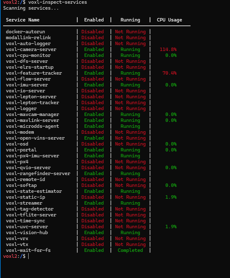

            As far as the sensor positioning input, I'm assuming that I'm using GPS because I followed this instruction to turn off qvio:
            NOTE: Ensure that voxl-qvio-server is disabled. If it is enabled, it will confuse gazebo due to gazebo sending fake sensor data to the qvio algorithm and causing poor flight dynamics in HITL. This can be done with the systemctl disable voxl-qvio-server command.
            Here are the services running via voxl-inspect-services. Note that voxl-px4 is not running because the sim is not running:

                  @shawn_ricardo I just tried it and it worked fine. But I had all services disabled except for voxl-wait-for-fs, voxl-mavlink-server, and voxl-cpu-monitor. So maybe try that.
