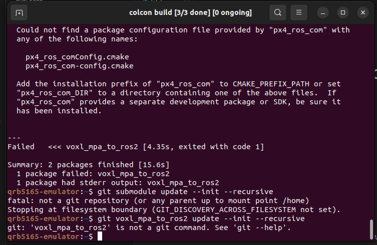

                @GlennTee Hello again. I attempted to run all of these commands, but I ran into an error on Step 5, which is shown below:
                I tried cloning the px4_ros_com package, but that did not help anything. I just also realized I never ran "voxl-configure-mpa-to-ros2" when setting up the SDK v1.4.1, could that be the reason why I'm experiencing so many problems and had to manually install packages I didn't have right off the bat such as Colcon, Eigen3, Netiface, and more? My last question is that do you know when the next SDK release will be out? Thanks again for all your help.

                    Hi @GlennTee you need to do a git submodule update --init --recursive on the voxl mpa ros2 code base to pull in px4 ros msgs

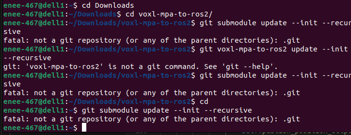

                          @tom Hello, when you mean docker do you mean the emulator? I'm not using a docker of any sorts (as far as I know of), but I did try running the command before the emulator and this is what I got:
                          • tomT
                            tom admin @GlennTee
                            @GlennTee yes that's what I meant. You'll have to git clone the repo instead of just downloading it in order for that to work
                            G 2 Replies Last reply Reply Quote 0

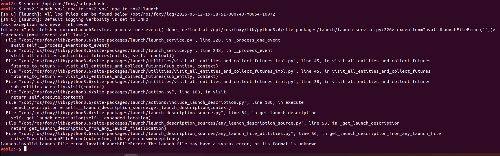

                                @tom @Zachary-Lowell-0 Hello again. It looks like I got the build to work. I tried cloning voxl-mpa-to-ros2 and that seemed to have worked in generating the build. I also ran "git submodule update --init --recursive" to pull in the px4 messages. I tried running "ros2 launch voxl_mpa_to_ros2 voxl_mpa_to_ros2.launch" but I received the following errors as shown below.

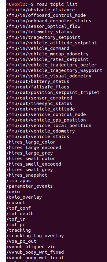

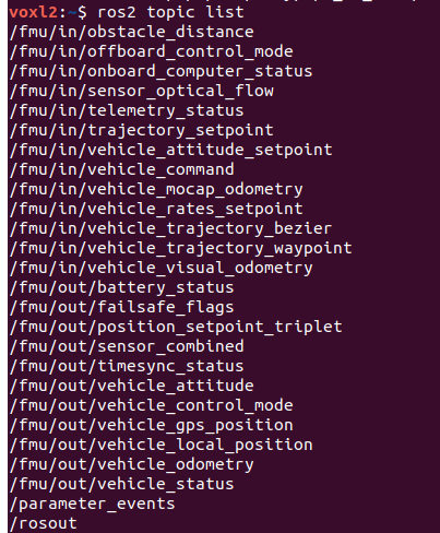

                                These are the ros2 topics that show up for me as well.
                                Is there something I'm missing that I need in order to see the ros2 topic for AprilTag detection?

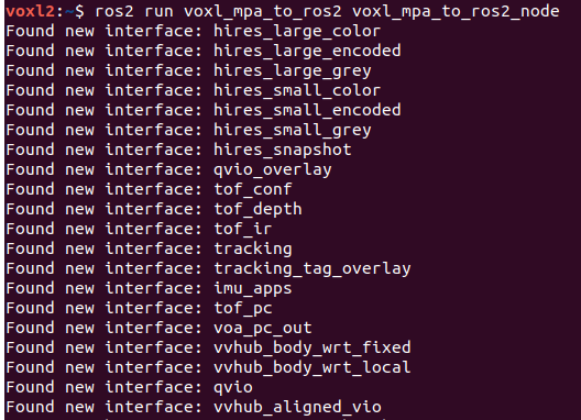

                                  GlennTee @GlennTee
                                  @tom @Zachary-Lowell-0 Looks like I got it to work, I was just running the wrong command. Is there an existing topic called "tag_detections" that should be appearing or is there another repository I need to download in order to obtain that? Thank you.
