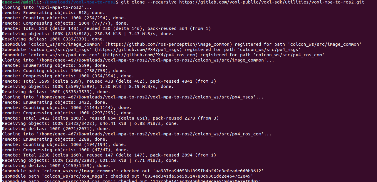

@tom @Zachary-Lowell-0 Hello again. It looks like I got the build to work. I tried cloning voxl-mpa-to-ros2 and that seemed to have worked in generating the build. I also ran "git submodule update --init --recursive" to pull in the px4 messages. I tried running "ros2 launch voxl_mpa_to_ros2 voxl_mpa_to_ros2.launch" but I received the following errors as shown below.

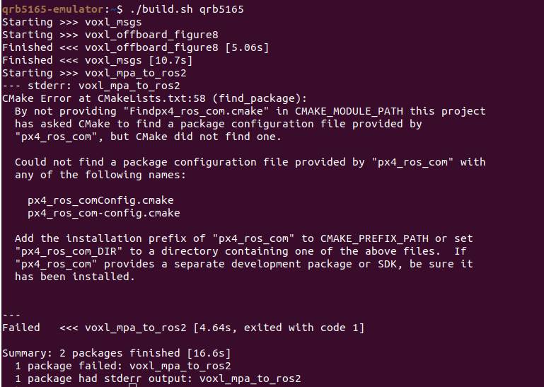

@tom Hello again. I just tried to run the command to clone the repository and I tried running ./build.sh qrb5165, but I keep getting the same error it looks like. Could you tell me the exact command I need to run in order to clone the repository? I know @Zachary Lowell 0 already outlined the commands I should follow. Thank you again.

@Zachary-Lowell-0 Hello again. I attempted to run all of these commands, but I ran into an error on Step 5, which is shown below:
I tried cloning the px4_ros_com package, but that did not help anything. I just also realized I never ran "voxl-configure-mpa-to-ros2" when setting up the SDK v1.4.1, could that be the reason why I'm experiencing so many problems and had to manually install packages I didn't have right off the bat such as Colcon, Eigen3, Netiface, and more? My last question is that do you know when the next SDK release will be out? Thanks again for all your help. -

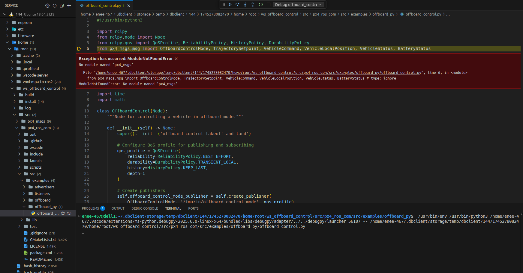

@Zachary-Lowell-0 Yes I installed voxl-ros2-foxy. This time I just tried "source /opt/ros/foxy/mpa_to_ros2/install/setup.bash" and that was accepted. However, looking now px4_msgs is still not recognized within my program.

@Zachary-Lowell-0 I tried "source /opt/ros/foxy/setup.bash" and "source install/local_setup.bash," but this was for trying to run my program. I just tried running "source /opt/ros/foxy/mpa_to_ros/install/setup.bash" and this is what I got:

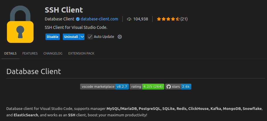

I'm using remote ssh in order to access the files on the drone.
