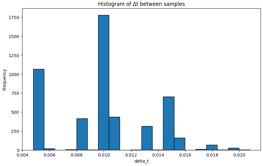

    I'm using an IMU with PX4 firmware. I attempted to change the stream rate of the IMU data to at least 50Hz, instead of the default 10Hz. However, when I use rosservice /mavros/set_stream_rate or rosservice /mavros/set_message_interval, there is no change.
    Could this be related to MPA, PX4, or another factor?
    Thanks in advance.

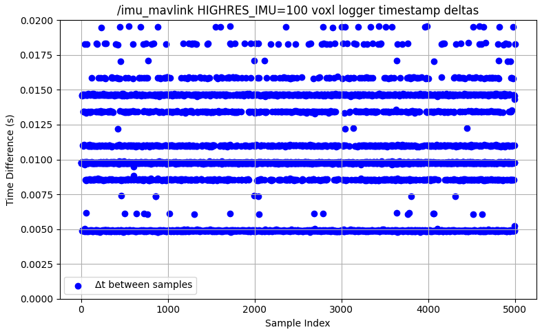

            @Eric-Katzfey hoping you can share some more insights here.
            I have edited the HIGHRES_IMU line in /usr/bin/voxl-px4-start to set the rate at 500 but the /imu_mavlink rostopic from voxl-mpa-to-ros shows a publish rate of ~137hz. Collected data with voxl logger shows the timing issue is not related to ROS -- do you know what may be causing the dropped imu messages in the mpa pipe?

            • K KLindgren
              voxl-version
              system-image: 1.8.04-M0104-14.1a-perf

              @KLindgren Why do you think there are dropped messages? That is just the rate that the data is being produced within PX4. The Mavlink HIGHRES_IMU message is constructed based on the internal vehicle_imu topic which publishes at that rate. It is slower than the rate that IMU samples are being generated by the IMU driver.
              • Eric KatzfeyE Eric Katzfey
                Just FYI, It is possible that messages are also getting dropped on the ROS side as well due to the fact that the publisher only has a queue size of 1 : https://gitlab.com/voxl-public/voxl-sdk/utilities/voxl-mpa-to-ros/-/blob/master/catkin_ws/src/src/interfaces/imu_interface.cpp?ref_type=heads#L74.
                This has been an issue before (other users reported), but we never updated this. The fix for that should be to increase the queue size (to 10 or so).
                @KLindgren , I know you said that the issue seems to be present in the output of voxl-logger, but there could be another issue with the ROS publisher queue size.
                From the plot, it looks like the base rate of the IMU messages is 200hz (5ms dt), but there are a lot of drops, resulting in dt's > 5ms. I am not sure why, just an observation based on the plot. @Eric-Katzfey , perhaps that's due to limited buffer / bandwidth sending data from the DSP?

                  @Alex-Kushleyev If I log the vehicle_imu topic within PX4 at full rate I see exactly the same distribution of timestamps.
                  K 1 Reply Last reply
                    K Offline
                    K Offline
                    KLindgren
                    @Alex-Kushleyev, we thankfully came across the ROS publisher queue size limit when debugging IMU1 timing and have since increased the queue size to 25.
                    @Eric-Katzfey, is it possible to get a clean ~200 Hz sampling of data from the px4 imu/imu_mavlink? Even setting HIGHRES_IMU to the low value of 100 produces the distribution of timestamp deltas below.
                    • K KLindgren

                      #10
                      @KLindgren The problem is that px4 does not generate that data at a constant rate. You can see the code here: https://github.com/modalai/px4-firmware/blob/8147a6476d78a4745058a002857aae8f1fd3b7ef/src/modules/sensors/vehicle_imu/VehicleIMU.cpp#L237. Our fork is based off of an older version of PX4. The latest PX4 code has changed in this area so it's possible it no longer does this.
                        K Offline
                        K Offline
                        KLindgren
                        #11
                        @Eric-Katzfey got it, thank you for the info.
