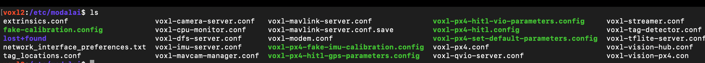

      @Emon_dey Can you post the output of ls /etc/modalai? Are you trying to arm in manual mode? There is a parameter named COM_ARM_WO_GPS. Is that set to 1?

        @Eric-Katzfey I have uploaded the screenshot with output of ls /etc/modalai command Screenshot 2024-06-05 at 7.30.11 PM.png

          @Emon_dey The file voxl-px4.conf is in that screenshot.
