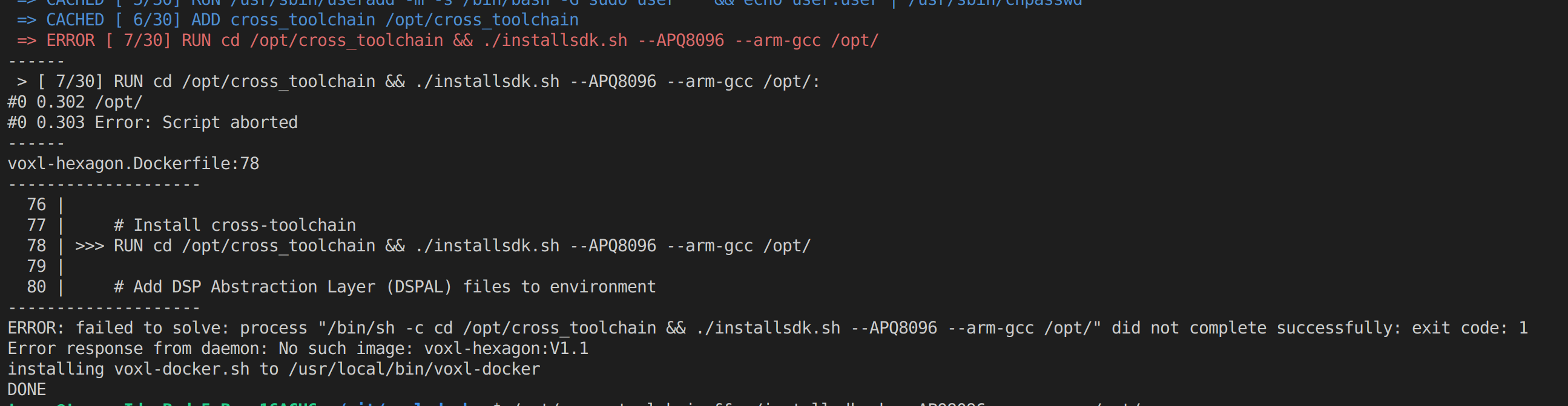

    voxl-hexagon: unable to install cross_toolchain
    8
    1358
    • SHofmeesterS
      SHofmeester
      I was trying to install voxl-hexagon on Ubuntu 22.04, when I got this message: 7174be92-114f-4934-b387-6dc31ca0bcee-image.png
      When I tried to run ./installsdk.sh --APQ8096 --arm-gcc /opt/ manually, I got the following message: e0cd17d3-a1bf-4303-a5b9-a6f8faf34cdc-image.png
      Can you help me with this?
      • SHofmeesterS
        SHofmeester
        I tried it on Ubuntu 20.04 as well, but it gave the same message as in Ubuntu 22.04. I also tried it with an older commit from the voxl-docker repository, but that also gave the same message. Does it have to do with the files that need to be downloaded and put in `cross_toolchain/downloads? Do I need to install something else?

            • Eric KatzfeyE
              Eric Katzfey ModalAI Team @SHofmeester
              @SHofmeester What do you get with docker images? Does it show any version of voxl-hexagon available?
              • SHofmeesterS
                SHofmeester
                Hi @Eric-Katzfey,
                This is the result when I run docker images:
                I feel like I am forgetting something, because I was able to install it before.
                I set up voxl-docker (voxl-docker -l and voxl-cross work), downloaded the 2 files and put them in cross_toolchain/downloads and then ran ./install-hexagon-docker.sh. Am I missing anything?
                • Eric KatzfeyE
                  @SHofmeester The installsdk.sh script is run as part of the Docker build process and is meant to be installed inside the Docker image, not on your local machine so it's understandable that that command failed. I just tried doing all the steps on my Ubuntu 20.04 machine and there were no issues. Can you show the entire output of the process starting with the invocation of the ./install-hexagon-docker.sh command? And also, you can just download the voxl-hexagon docker image directly from our downloads site so that you don't have to build it.
                  • SHofmeesterS
                    SHofmeester
                    Thank you for your help! I was able to download it directly and it works now. On my other device I was only able to build it, but on this device downloading it directly works.
