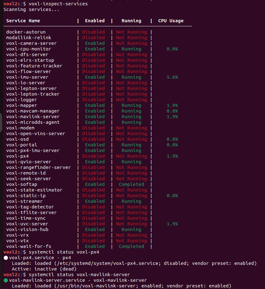

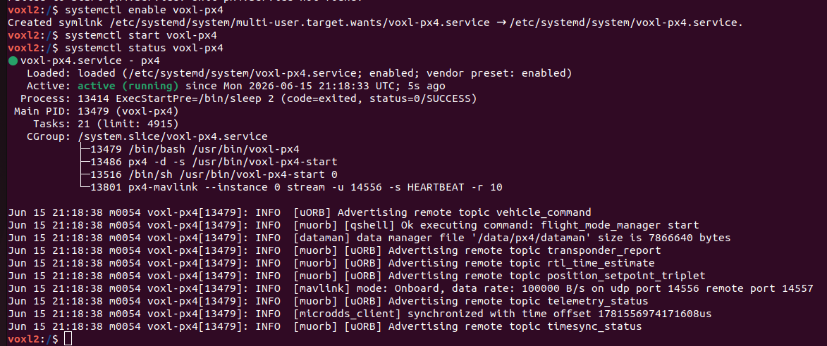

    @Eric-Katzfey The desicion to use systemctl start voxl-px4 was because from what i understand it is that the system boots and services necessary to flight should be enabled and running once a preflight has passed. Our preflight was showing pass but the systems never enabled even though the preset is enabled.
    So I am trying to force it to start.

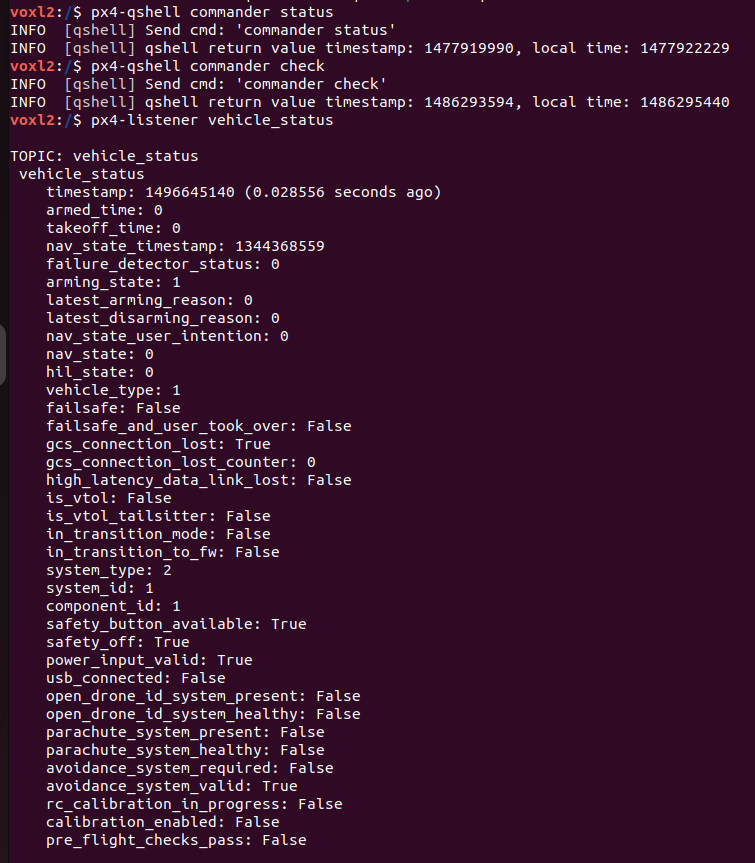

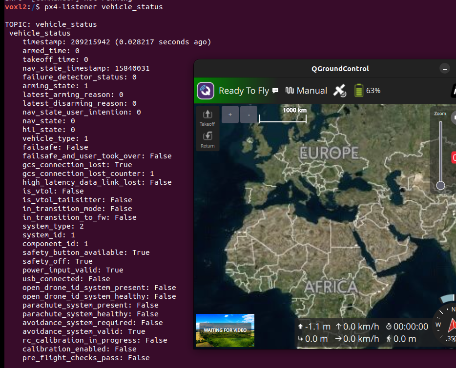

    When I force it to start I can run the following commands to verify that my preflight has failed in the px4.
    Now the system is up and running
    Now to check the preflight status:
    Here the preflight has failed but in QGround Control its stating a pass and that we are ready to fly.

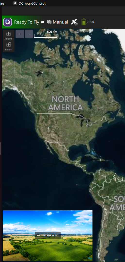

        @daniellee said in Issues with controller and drone:
        What do you mean that the systems never enabled? What systems? How are you trying to enable them? What is the preset you are talking about? Looking at the QGC screen it looks like it is ready to arm. Can you arm it via QGC?

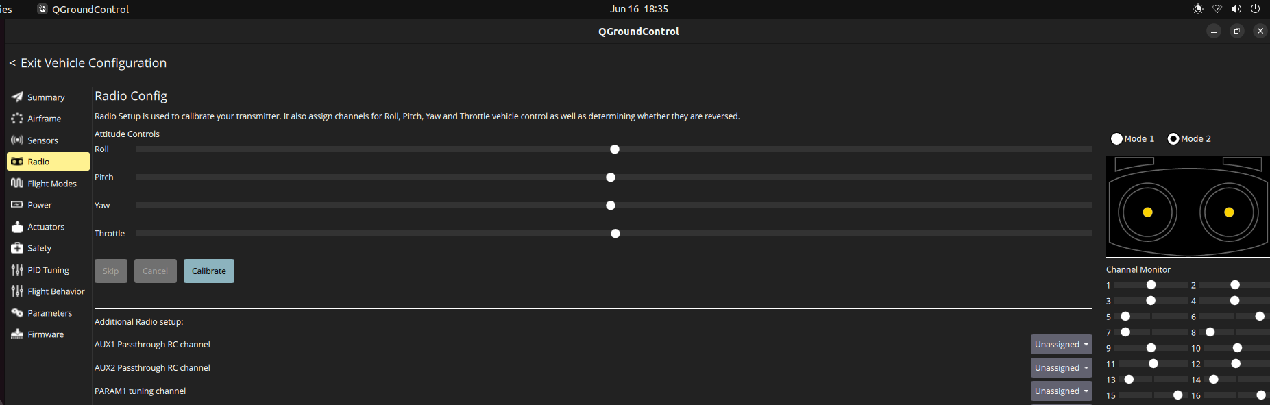

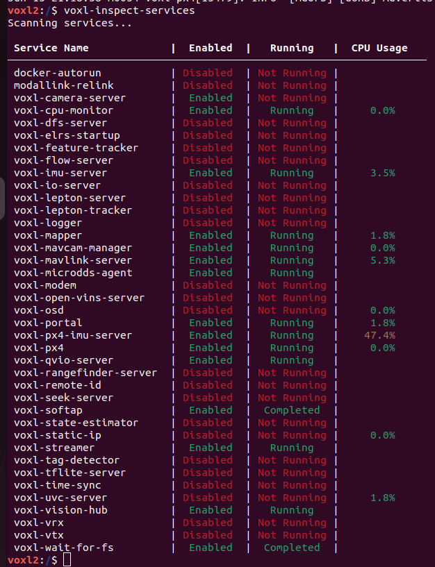

          @Eric-Katzfey That is the problem. Every time I power cycle the system, it does not keep the services necessary for flight enabled. I will power cycle the drone to show that it does not stay enabled. After power cycling I enabled the px4 service because it was not enable on start up so that I can view the vehicle status.
          The preflight failed in the adb shell. But is passing in QGC.
          I can see the radio RC transmitter moving the joysticks in QGC but the drone does NOT take off. So movement commands sent via the controller are being seen but not used by the drone. Screenshot from 2026-06-16 18-36-07.png Screenshot from 2026-06-16 18-36-45.png
          This is what I mean by the joystick inputs not working. These photos show that the controller is connected and the inputs are being read. However, the drone is not using them.

            @daniellee So when you power cycle the drone and then adb in and do voxl-inspect-services which services are not enabled and running that you think should be? In your earlier screen shot voxl-px4, and voxl-mavlink-server were both enabled and running. What other services do you think you need for flight? That's all that should be required for manual flight mode.

                @daniellee I don't know what that means. If you can see the RC sticks / switches at QGC then PX4 has to be seeing them. What happens when you try to arm the drone from QGC?
                D 1 Reply Last reply

                  daniellee
                  @Eric-Katzfey It gets armed but the drone does not fly/respond to the controller inputs.

                              @Eric-Katzfey said in Issues with controller and drone:
                              Just to be clear, that image you are referencing was the second photo related to the voxl-inspect-services after I enabled and started the px4 service. The first photo shows it not enabled and not running.
                              Upon power cycling, I have to enable it every time we attempt to fly.
