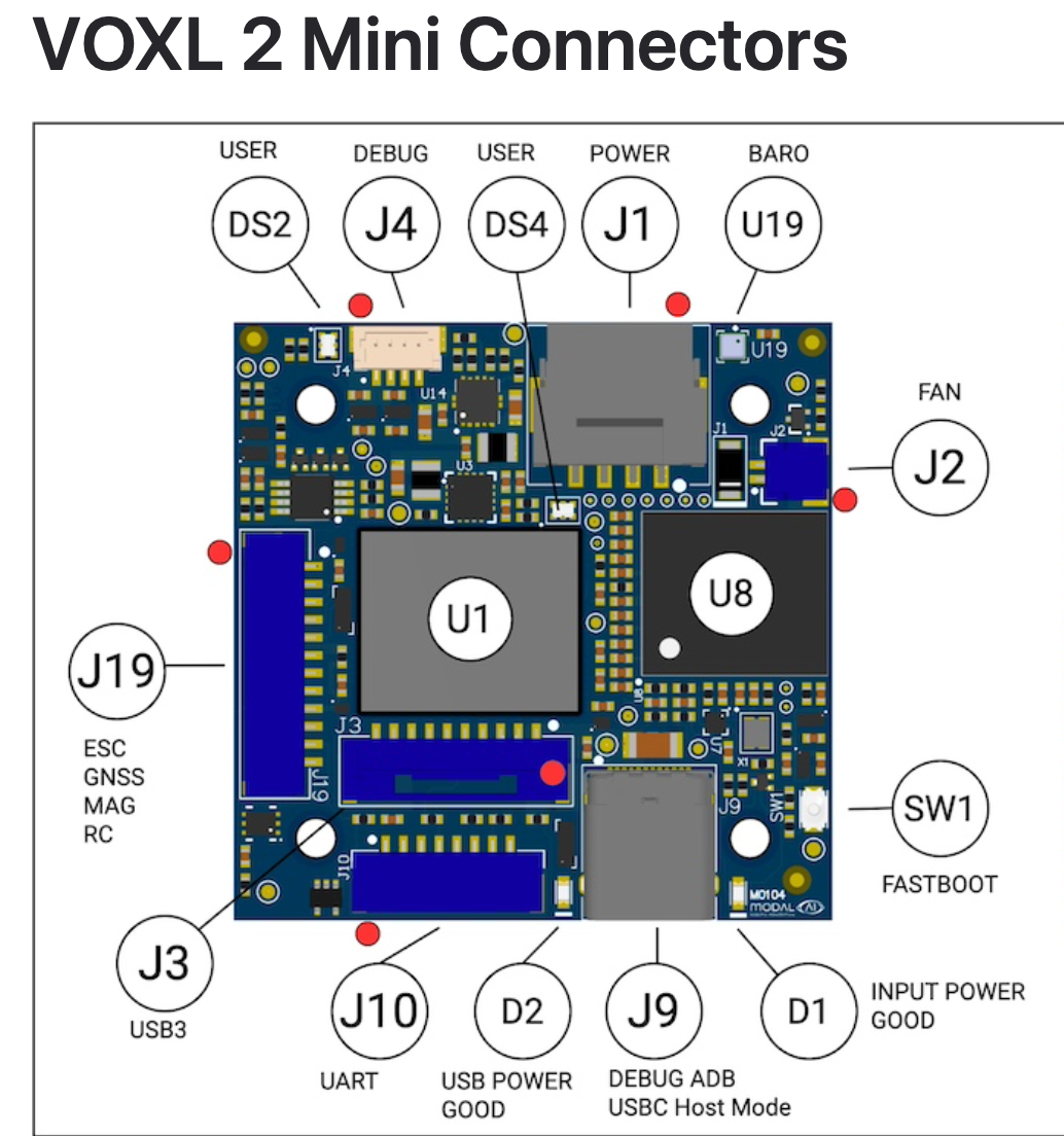

                Is J9 USB-C connector shown in the following screen capture?
                Mustafa

                  @Mustafa_Cayci Yes, J9 is shown. That is for an adb connection. What were you intending to use it for?
