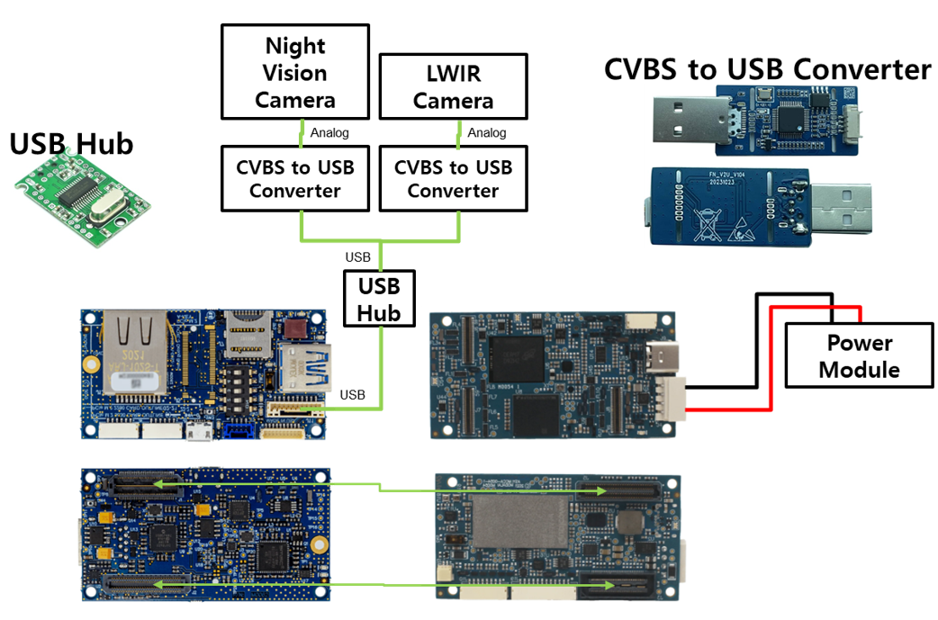

          I connected it as shown in the attached file.
          The camera was purchased from AliExpress. The Night Vision Camera has a current consumption of 0.2 A, and the LWIR camera’s current consumption is unknown (but it is expected to be low).
          Even when testing with only the Night Vision Camera connected, the same issue occurred.

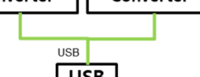

            Lastly, just to clarify, are your USB connections unique? Your drawing looks like they are the same USBD+/D- wires connecting to one port of the Hub. 2d802362-4330-4853-bb36-9836fb6516cd-image.png

              Unfortunately, I need to connect two cameras to the J11 port. I’m planning to connect other sensors to the J10 and J12 ports.
              I will first test by connecting one camera to the J11 port, and then try using a USB hub with a 1A capacity.
              Although it appears as a single line in the hardware architecture diagram, the connections to the USB hub were made individually!
              VinnyV 1 Reply Last reply Reply Quote 0
