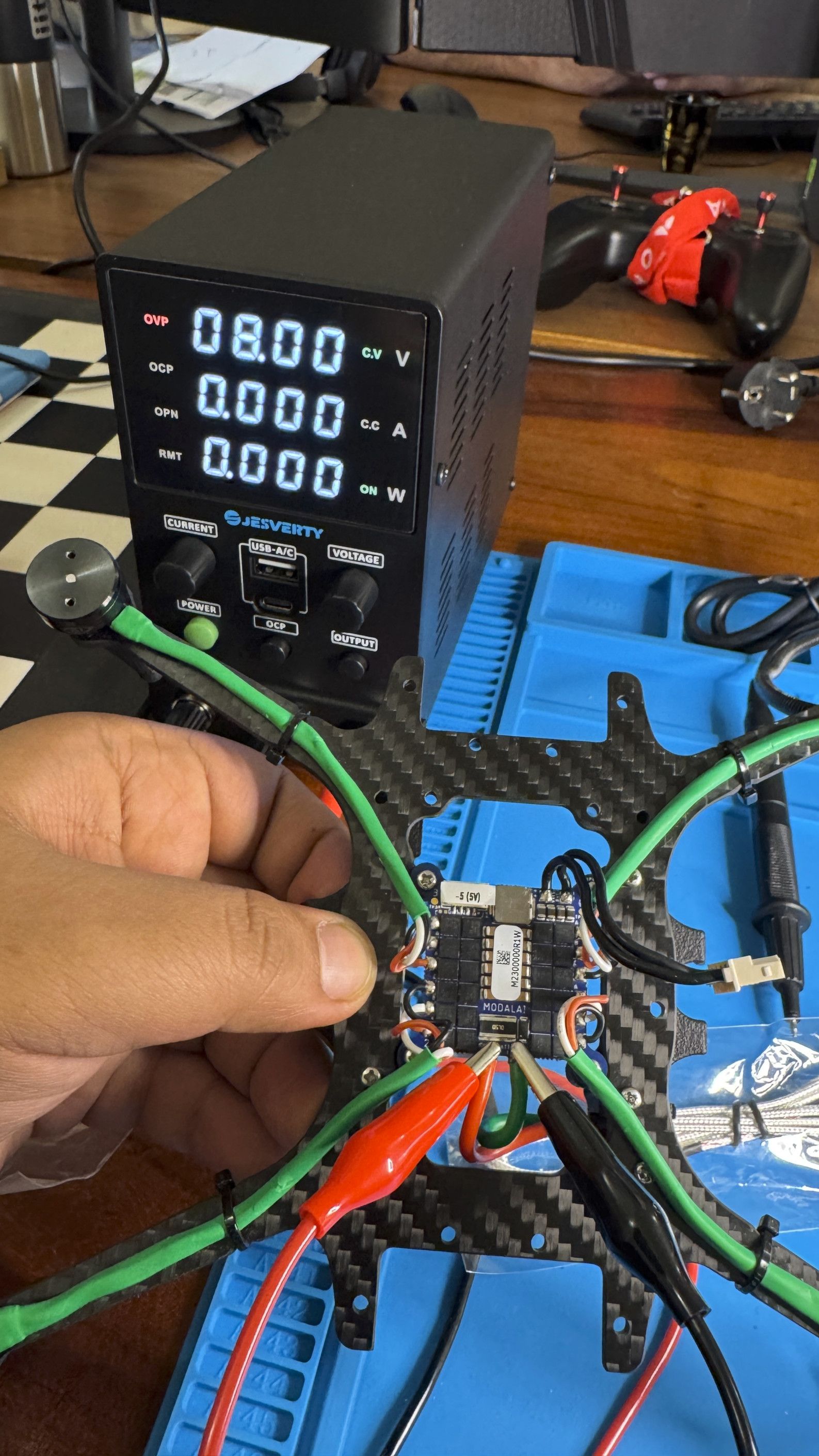

        @Alex-Kushleyev Hi Alex,
        Thanks for your response.
        To answer your question - the ESC does not appear to be booting at all.
        I tested the ESC independently:
        • Connected battery directly to ESC (no VOXL connected)
        • There are no motor tones and no visible LED activity
        Additionally:
        • voxl-esc-scan.py does not detect any ESCs at any baud rate
        • UART debug shows TX packets being sent but no valid RX response
        • SLPI reports “Bus 12 not initialized”
        Since the ESC does not produce any startup tones even when powered directly, it seems the ESC MCU is not booting.
        Could this indicate a hardware failure of the ESC logic section?
        Please let me know if you would still recommend testing via USB-to-serial, or if this is sufficient to consider the ESC faulty.
        Thanks,
        Koti.

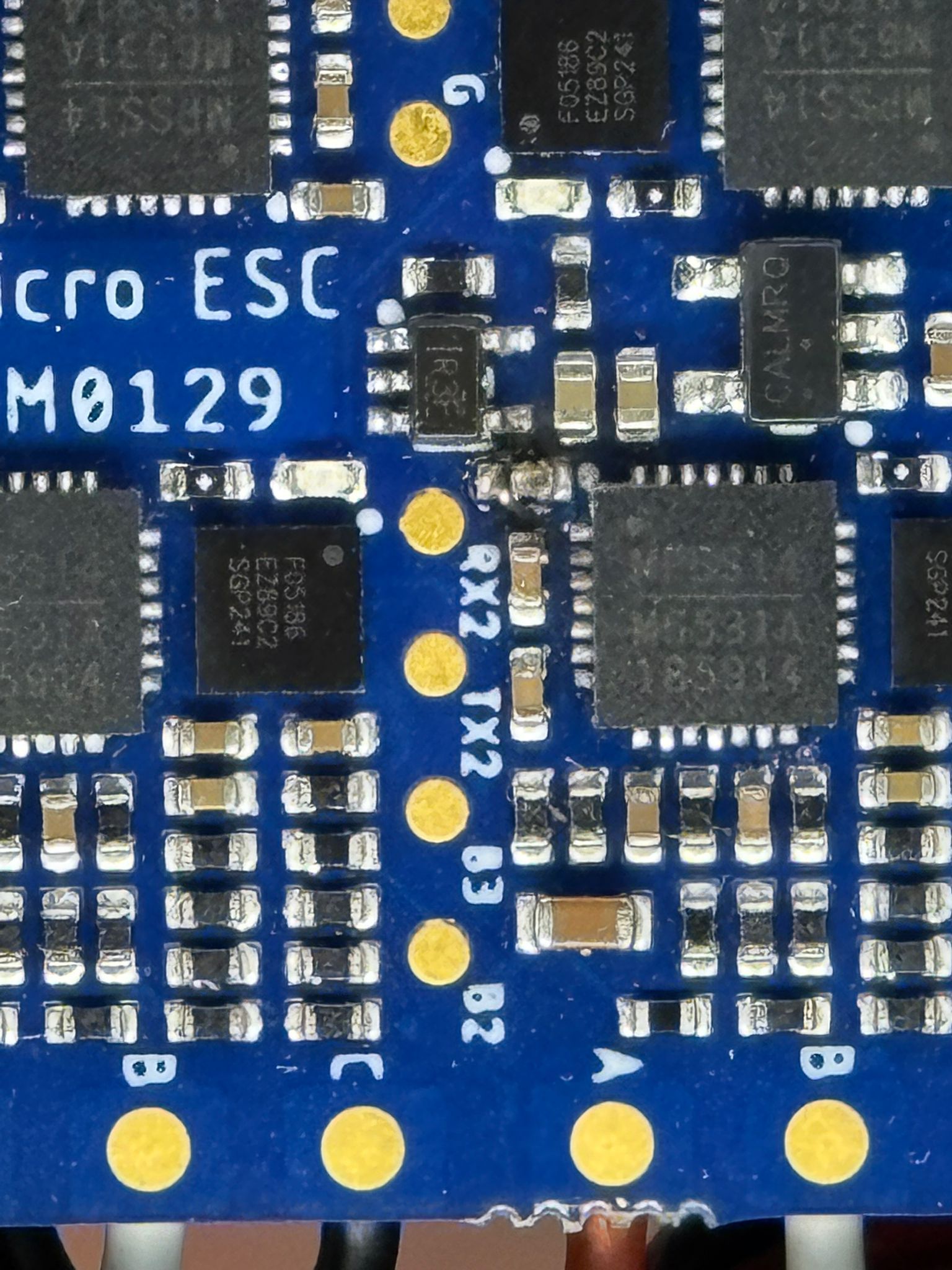

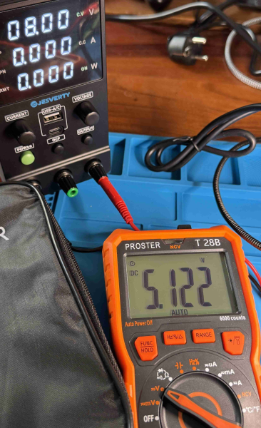

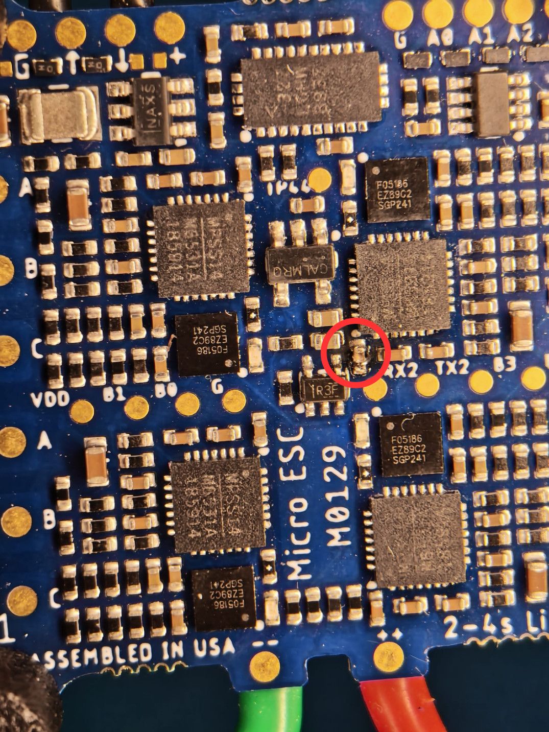

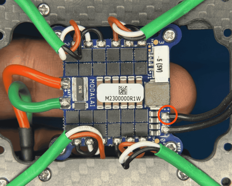

          @syamala-kotireddy ,
          If the ESC is not showing any signs of life (no blue led blink), it probably means the ESC power regulator is not working properly. However, you mentioned that VOXL2 is actually booting fine? Can you measure the voltage on the connector / pads that provide 5V power from M0129 ESC to VOXL2?
          Please see the following post, where a capacitor on the ESC next to the main voltage regulator was knocked off, resulting in ESC not starting up. https://forum.modalai.com/topic/4151/voxl-mini-4-in-1-esc-missing-capacitor/ . However, in that post, i think VOXL2 was not booting either. In your case the issue may be something different.
          It is worth carefully inspecting the ESC.
          Also, if you have a power supply that can measure current, you can set it to 8V and measure the current draw of the ESC alone, it should be very small (maybe 20-30mA) but not zero.
          syamala kotireddyS 1 Reply Last reply

            @Alex-Kushleyev Hi, thanks for your response.
            While inspecting the ESC, we noticed that one of the components (looks like a resistor) is visibly burnt/damaged (attached image). The surrounding area also shows clear signs of overheating.
            Do you think this failure could be the root cause of the ESC not powering up or being detected? From your previous message, it seems likely related to the power regulation stage.
            We will also proceed with the voltage measurement on the 5V rail and current draw test as you suggested to confirm.
            Thanks again for your guidance.

              @Alex-Kushleyev I am a colleague of @syamala-kotireddy. We measured current draw of the ESC alone which is coming out to be zero. Please find the pictures attached.
                @boron , thank you for performing the test. Were you also to check if the 5V output (that normally goes to VOXL2) has 5V on it?
                The capacitor that you circled in RED definitely appears to be damaged. This is a bypass capacitor on VBATT that is right next to the Mosfet Driver. It is possible that the capacitor was faulty and burned out, however since there is no short circuit or further overheating (based on the zero current draw from the power supply), the capacitor is probably not preventing the ESC MCUs from booting.
                I suspect that there is another issue somewhere, but it would be good to know if the 5V rail is functional (i suspect that it is not). There is no on/off power switch on the ESC, so the main 5V regulator provides 5V from VBATT (which is used for VOXL2) and then another regulator that provides 3.3V (from 5.0V) for the four MCUs.

                  @Alex-Kushleyev Thank you for the clarifications. Suprisingly, the 5v rail seems to be working. Please find the pictures attached.

                    @boron Please submit an RMA, https://modalai.com/rma and just refer to this thread. Include your shipping information and we'll send you a new one
