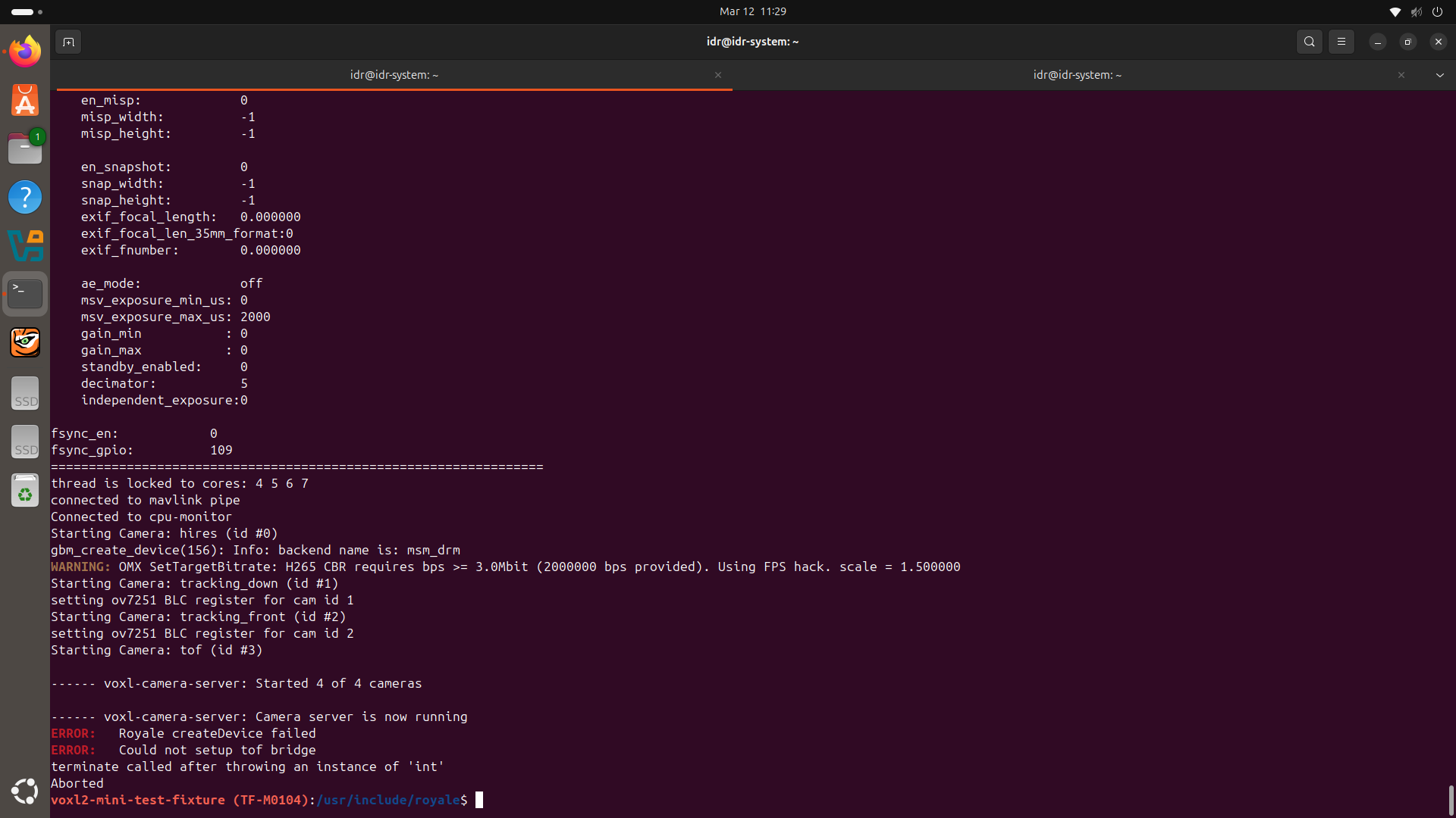

      I am working with a VOXL2 Mini test fixture (TF-M0104) and encountering an issue when starting the ToF camera.
      The voxl-camera-server starts successfully and all cameras initialize, but it crashes when the ToF bridge attempts to initialize the Royale device.
      Additional details:
      • Platform: VOXL2 Mini (TF-M0104)
      • Camera server starts all 4 cameras
      • The crash occurs right after the ToF bridge initialization.
      Could you please advise what might cause Royale createDevice to fail in this situation?
      I have attached a screenshot of the full terminal output for reference.

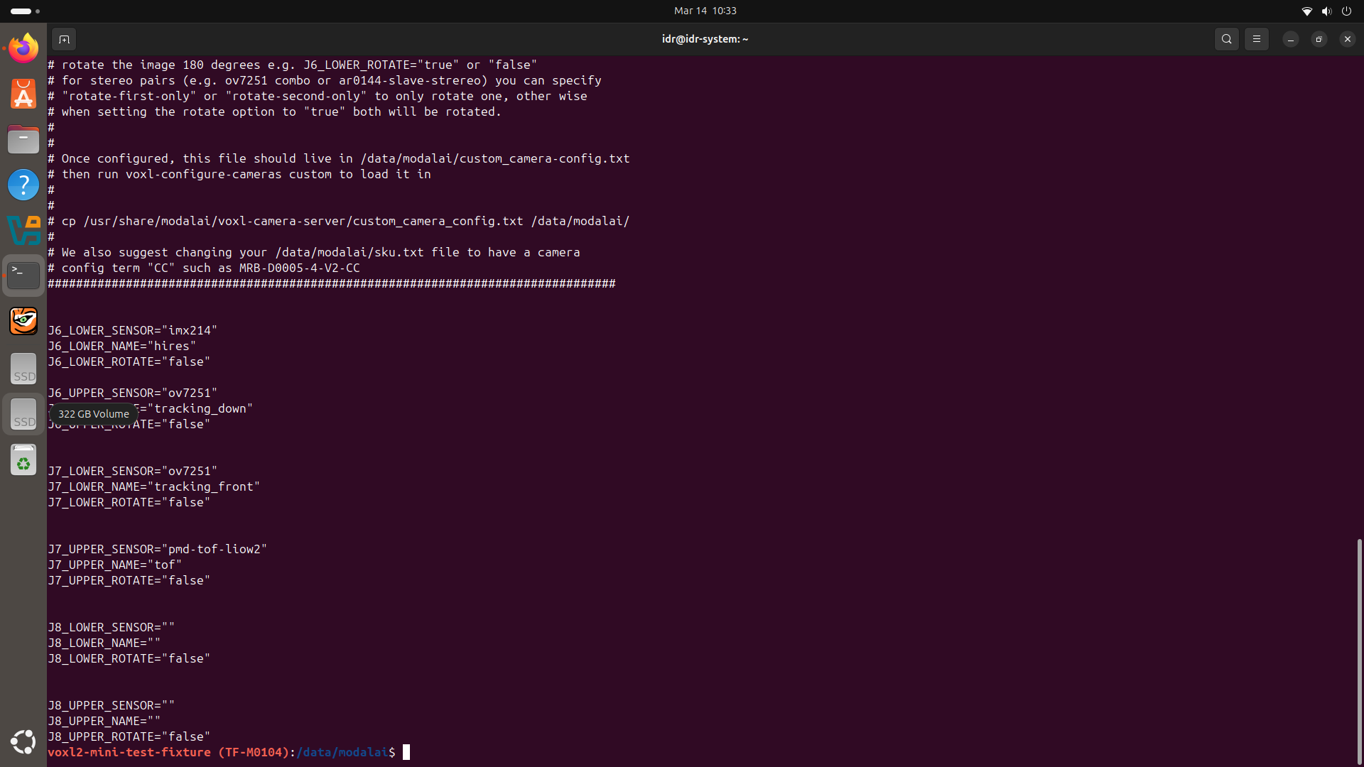

          Piyush Singh @Alex Kushleyev
          @Alex-Kushleyev I am using second one i.e. TOF V2 and defined it in custom_camera_config.txt file as given below:

            @Piyush-Singh , can you please provide more details
            • how exactly all cameras are connected to VOXL2 mini (including interposers, flexes), etc. A diagram would help a lot
            • which kernel variant are you running on your voxl2 mini (2.0.0 or 2.0.2).
            Are all the other cameras working if you disable the TOF sensor in the camera server config?
