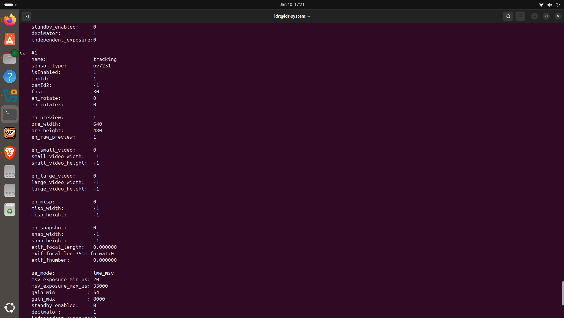

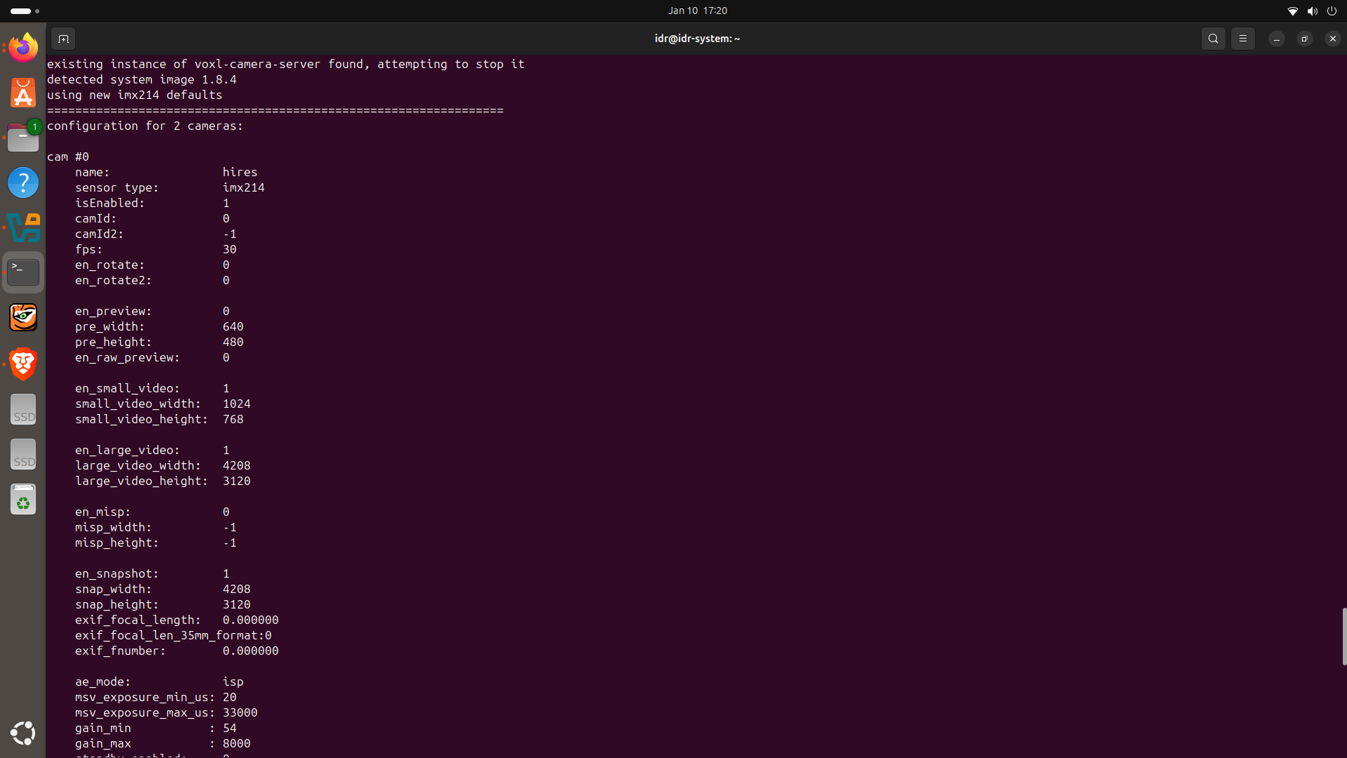

      Please help me , hires camera is not detected by camera server. I have connected hires to J6 L (using M0084) and Tracking to J7 L(M0135) .Camera server detects only tracking camera but not hires.

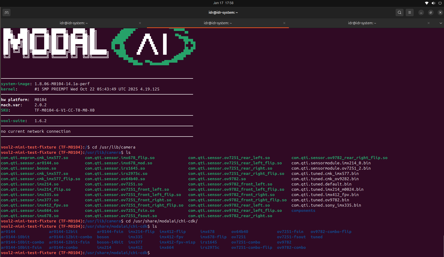

        Alex Kushleyev ModalAI Team @Piyush Singh
        @Piyush-Singh, please double check that you have the imx214 sensormodule bin for slot 0 in /usr/lib/camera/ (since you have M0084 connected to J6 and the IMX214 camera connected to the "lower" port (JL) of M0084, so the resulting connection of the IMX214 camera will be mapped to VOXL2's J6L (slot 0)).
        You can find all the sensormodule files in /usr/share/modalai/chi-cdk/

          Piyush Singh @Alex Kushleyev
          Hii, Please take a look:

            Hi @Piyush-Singh,

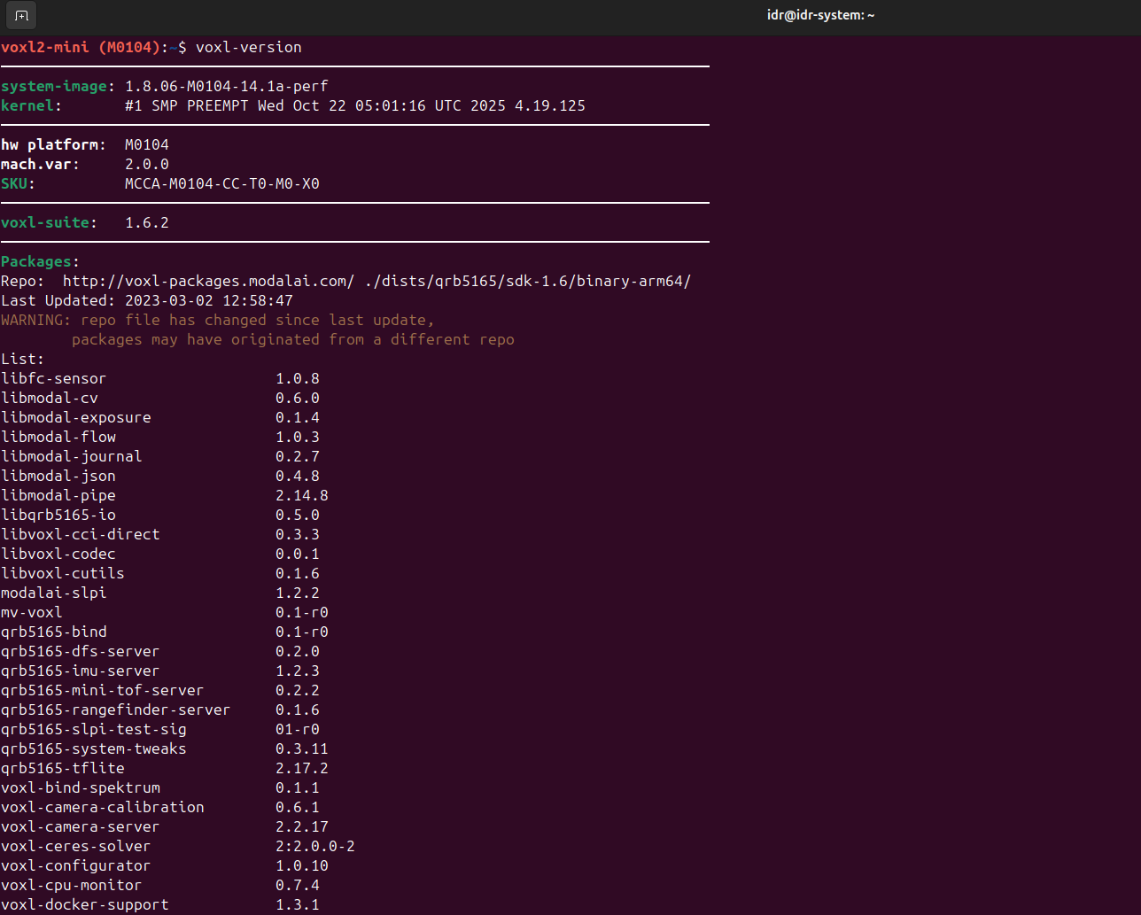

            Sorry for the delay. I believe your issue is the same as in this post : https://forum.modalai.com/topic/4975/hardware-configuration-for-2-m0014-tracking-1-m0169-pmd-tof-1-m0024-hires/ . Specifically, the kernel variant that is installed is 2.0.2 which is designed for newer camera adapters like M0188, M0195.
            Please change your kernel to the 2.0.0 variant as described in the thread above (you can test it first before overwriting).
            It looks like you do have the right sensormodules in place.

              @Alex-Kushleyev Thanks for the reply.

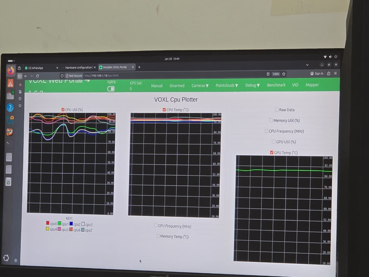

              I tested the HiRes camera with the 2.0.0 kernel variant as suggested. With this version, the HiRes camera is detected correctly, so that part seems to work as expected. However, I’m observing that the system temperature rises very quickly and crosses 80 °C+ during operation.

                  @Alex-Kushleyev ,Thanks for the response.

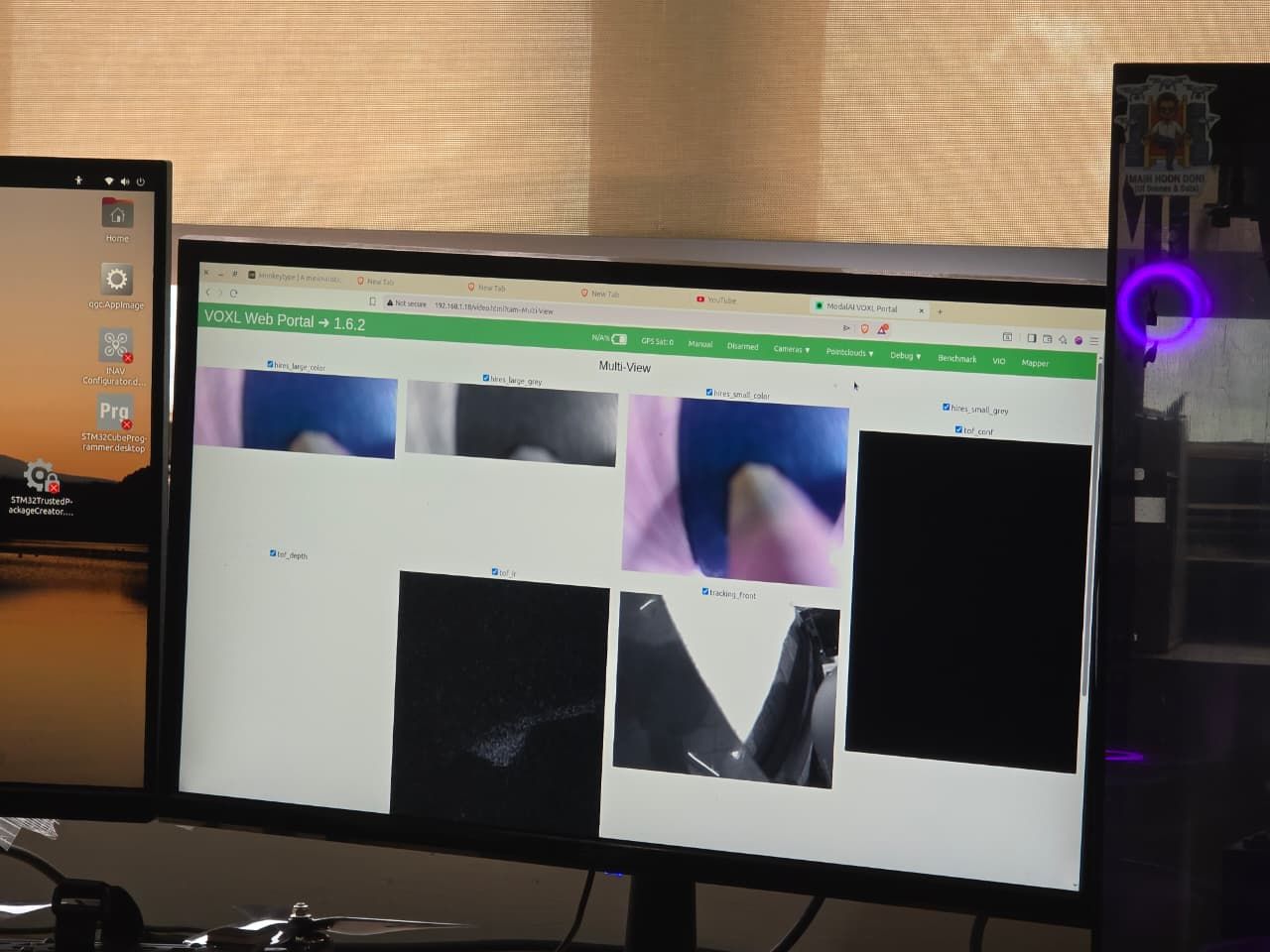

                  For testing, I am running multiple camera streams simultaneously and go to web portal to see the streaming:
                  HiRes (IMX214): 30 FPS
                  Small video: 1024×768 (H.265)
                  Large video: 4208×3120 (H.265)
                  Snapshots enabled
                  PMD ToF (M0169): 10 FPS, decimator 5, exposure_max_us: 6000
                  Tracking front (OV7251): 30 FPS, preview + raw preview enabled, preview_width and preview_height 640 and 480 respectively.
                  With this configuration, CPU/GPU temperatures rise quickly and go beyond 80 °C. After running for some time, the ToF camera stops working, and the HiRes feed becomes unstable with significant latency and frame delays, as shown in the attached screenshots.

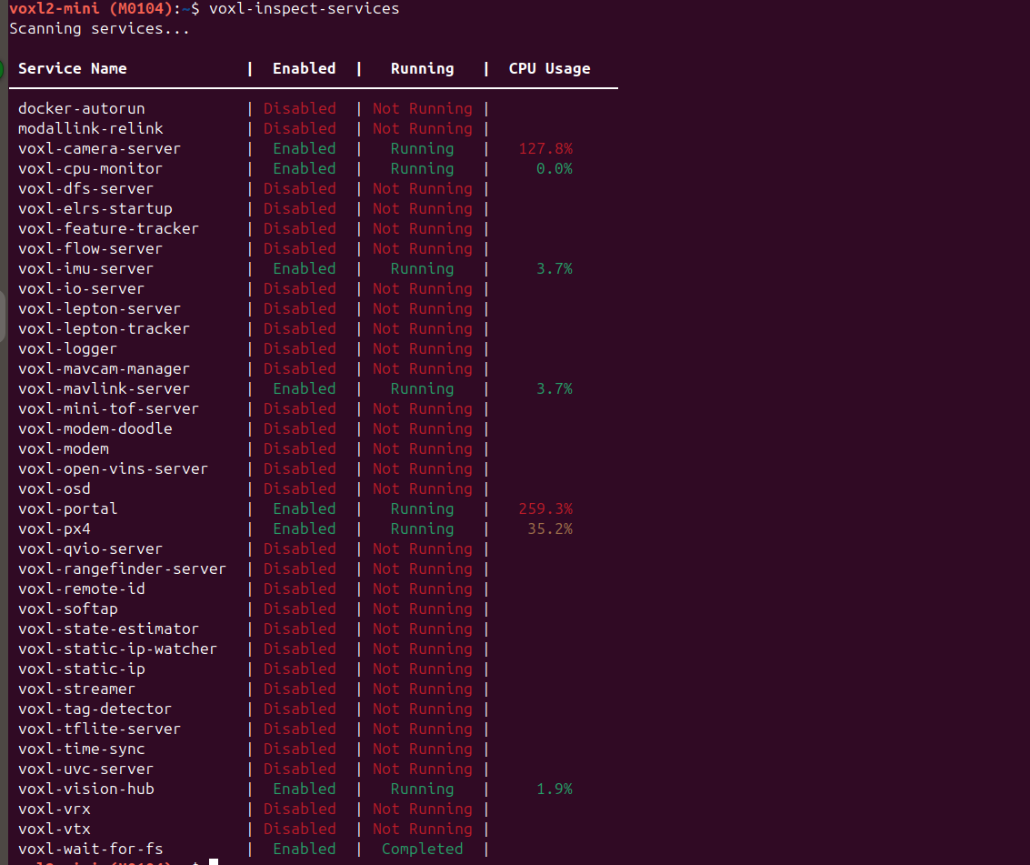

                    Piyush Singh @Piyush Singh
                    @Piyush-Singh Also take a look at CPU usage of voxl-portal and voxl-camera-server
                      @Piyush-Singh ,
                      The voxl-portal does not handle well streaming large images (including in multi-view, where the images are actually appearing small). The voxl-portal back-end uses software JPEG encoding, so one of your streams (hires_large) is 4208x3120, which takes LOT of cpu processing to encode to jpeg.
                      You can see that the voxl-portal process uses 260% cpu (2.6 full cores), which is a lot.
                      There is no practical need for streaming small and large uncompressed images to voxl-portal, so you can just enable small video stream, which is much smaller.
                      Also, if you select an individual camera stream, you can enable advanced camera controls (click on the small check box in lower left) and then you can adjust the JPEG encode quality from default 70 to something much lower in order to use less cpu. This setting will be applied to all cameras and you can go back to multi view after that. Note that the jpeg encode quality only affects voxl-portal view, not h264/h265 encoding.
                      Please try.
