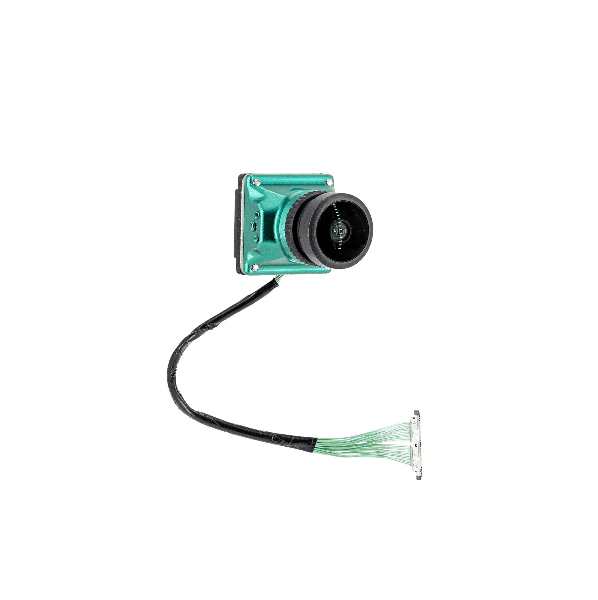

    We are designing one carrier board and wanted to use Camera module MSU-M0186-1-09.
    Could you please help me which mating connector we should use on our board to insert 26-pin the co-axial cable with our custom carrier board?

        @Alex-Kushleyev
        Dear Alex,
        I have gone through the link you have provided. Those link is not providing the specific information I required.
        We need to connect MSU-M0186-1-09 camera module on our custom carrier board. we do not want to use intermediate adapter boards.
        SO we need part number for 26 pin mating connector which can attach with the MSU-M0186-1-09 camera cable?
        Let me know if more details are needed.

          Hello @Richa,
          The documentation states the following: (https://docs.modalai.com/micro-coax-user-guide/)
          • ModalAI uses Hirose DF56 series micro coaxial connectors for our adapters and cables
          The part number for the coax mating connector is the following : DF56C-26S-0.3V(51).
          If you are designing a carrier board for VOXL2, you could request some help from our engineers to help review the design before you send it for manufacturing.
          I hope that helps.

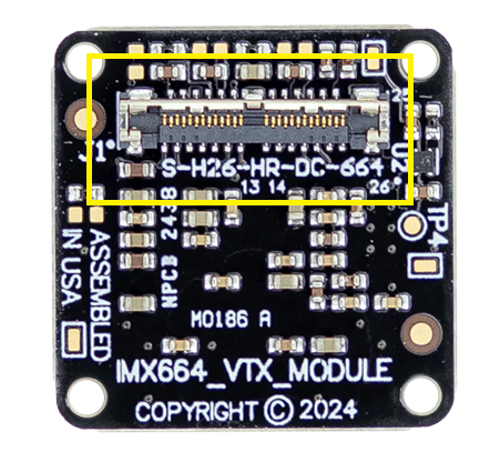

            Richa
            @Alex-Kushleyev
            We have ordered MSU-M0186-1-09 camera module and in image it shows co-axial cable attached to it.
            Refer below image for your reference.
            So in this case our custom carrier board should have the mating part on which this co-axial cable should attach.
            we are expecting that this kind of connector on our carrier board.
            Please suggest the highlighted connector part number.
              Hello @Richa,
              I hope that helps.
