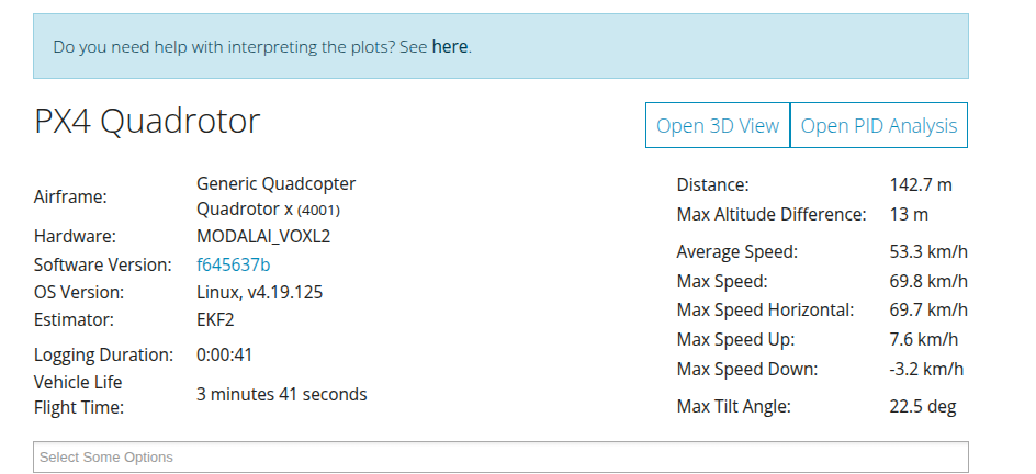

        @Eric-Katzfey HI, I have attached a flight log.

          @Eric-Katzfey this is the link https://nam02.safelinks.protection.outlook.com/?url=https%3A%2F%2Freview.px4.io%2Fplot_app%3Flog%3D279179dd-82e9-40f9-a09d-59d793ac34e0&data=05|02|thazeez2024%40fau.edu|3bfe3b5f99cc4a819a7708de21fe6020|63c3c9c1e824413fb4352f0cabb2828f|0|0|638985573747064624|Unknown|TWFpbGZsb3d8eyJFbXB0eU1hcGkiOnRydWUsIlYiOiIwLjAuMDAwMCIsIlAiOiJXaW4zMiIsIkFOIjoiTWFpbCIsIldUIjoyfQ%3D%3D|60000|||&sdata=CBUPqljeTJLLDWFBug33%2BjhanXLhKVMV0GVnCfanLF0%3D&reserved=0
