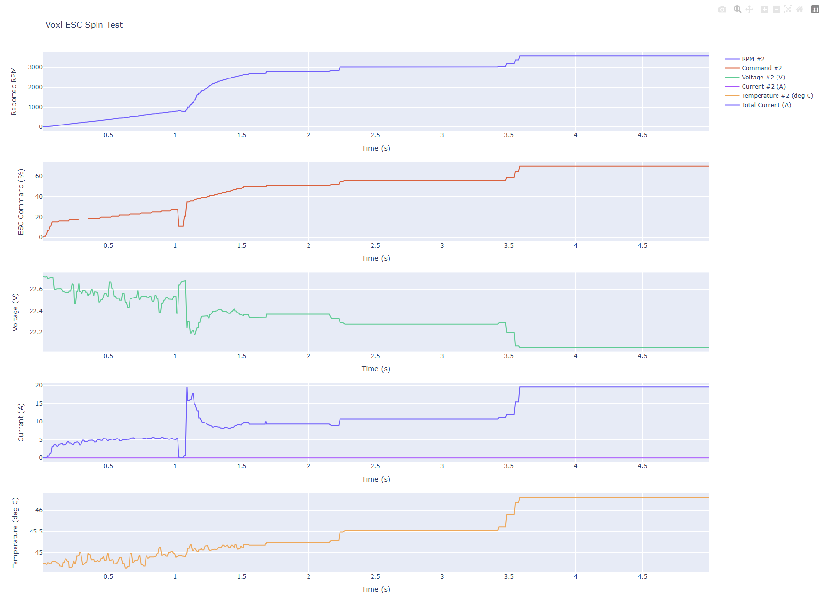

I'm calibrating the FPV Racing 4-in-1 ESC on the VOXL2 itself (not connected directly to the ESC via FTDI). When performing either the calibration (
./voxl-esc-calibrate.py --id 2 --pwm-min 10 --pwm-max 95) or the power ramp test (./voxl-esc-spin.py --id 2 --power 100 --ramp-time 3.0 --timeout 5.0 --enable-plot 1 --cmd-rate 250), there are several instances were the y-values do not change for secondsThe behavior is more readily seen in the power ramp test, since commanded values are continuous, whereas in the calibration test, a specific value is commanded for a given time period. Still, you can see in the calibration results that y value doesn't change any for far longer than the default step duration of 0.5 seconds
Looking at the calibrate script, seems that the returned values from:
esc.get_current()esc.get_power()esc.get_rpm()esc.get_voltage()esc.get_temperature()
are directly print to terminal, and not some other variable hanging around that maybe doesn't update.
@Alex-Kushleyev has this behavior been seen? Any recommendations? It is difficult to tune commutation when values are not updated. The interesting pattern showing itself through repeated runs of the script is that the "duration unresponsiveness" increases as commanded power increases

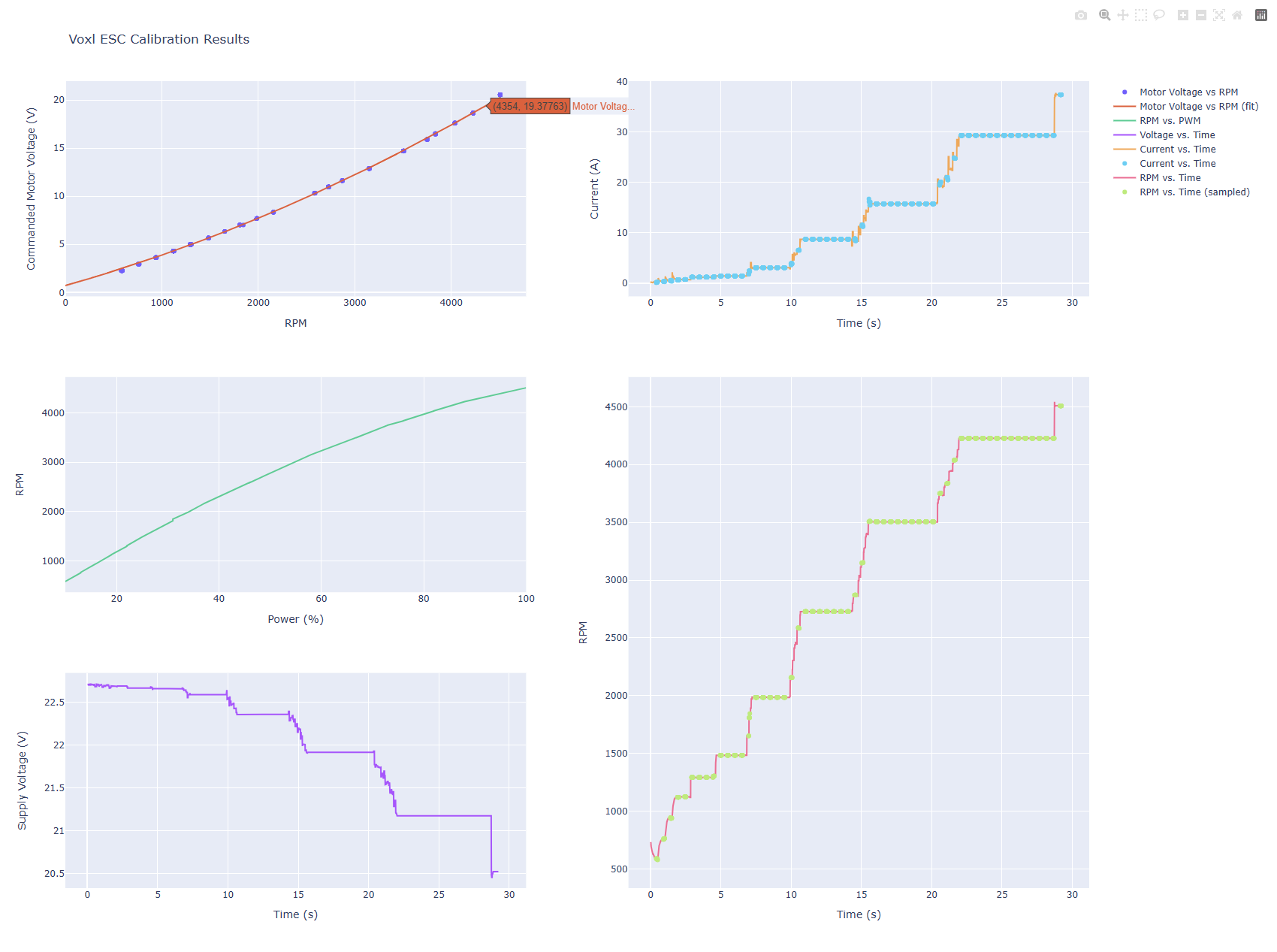

For the ramp test, the motor doesn't get stuck. I hear a smooth transition up to 95% power and the motor maintains that power for the timeout duration. Same for the calibration script. I hear the motor change speeds at the default duration of 0.5 seconds.
Regarding the post's comment:
"We calibrate from 10% - 95% per the instructions, but no matter the ESC/motor, the calibration process maxes out at around 60 - 70% power (11k - 13k RPM)."This happens because the loop in the script is tracking a variable that is set / updated only from within the script itself, rather than from
esc.get_power(). When I updated the script to set the current power variable to the value returned byesc.get_power(), the loop actually goes to the max power specified. The downside here is that, given my current setup, although the command power seems to be accepted and implemented by the ESC, the returned value fromesc.get_power()is not correctly reflected -- so the physical motor is spinning faster than the ESC is reporting and the loop continues to command the user definedMAX_POWERfor a long time until the ESC catches up. I suppose one could update the loop to only increase commanded values once the returned value is verified, but for debugging purposes, the above is sufficient.I believe I did have the voxl in perf mode, but will try setting testing it again. As well as on a linux PC (i'll be using the same WSL as in the linked post, so maybe i could just try a container on the voxl with updated python)

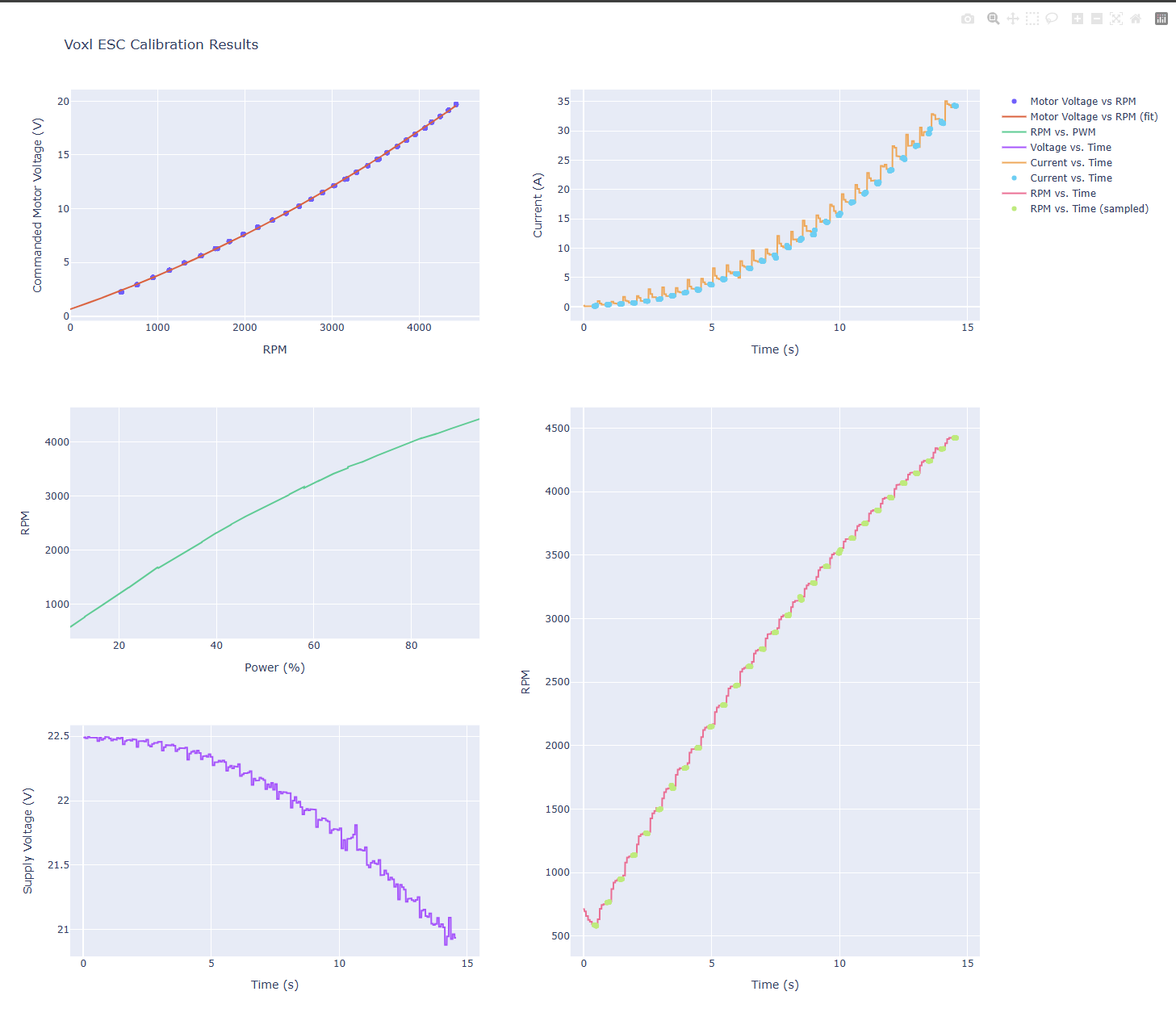

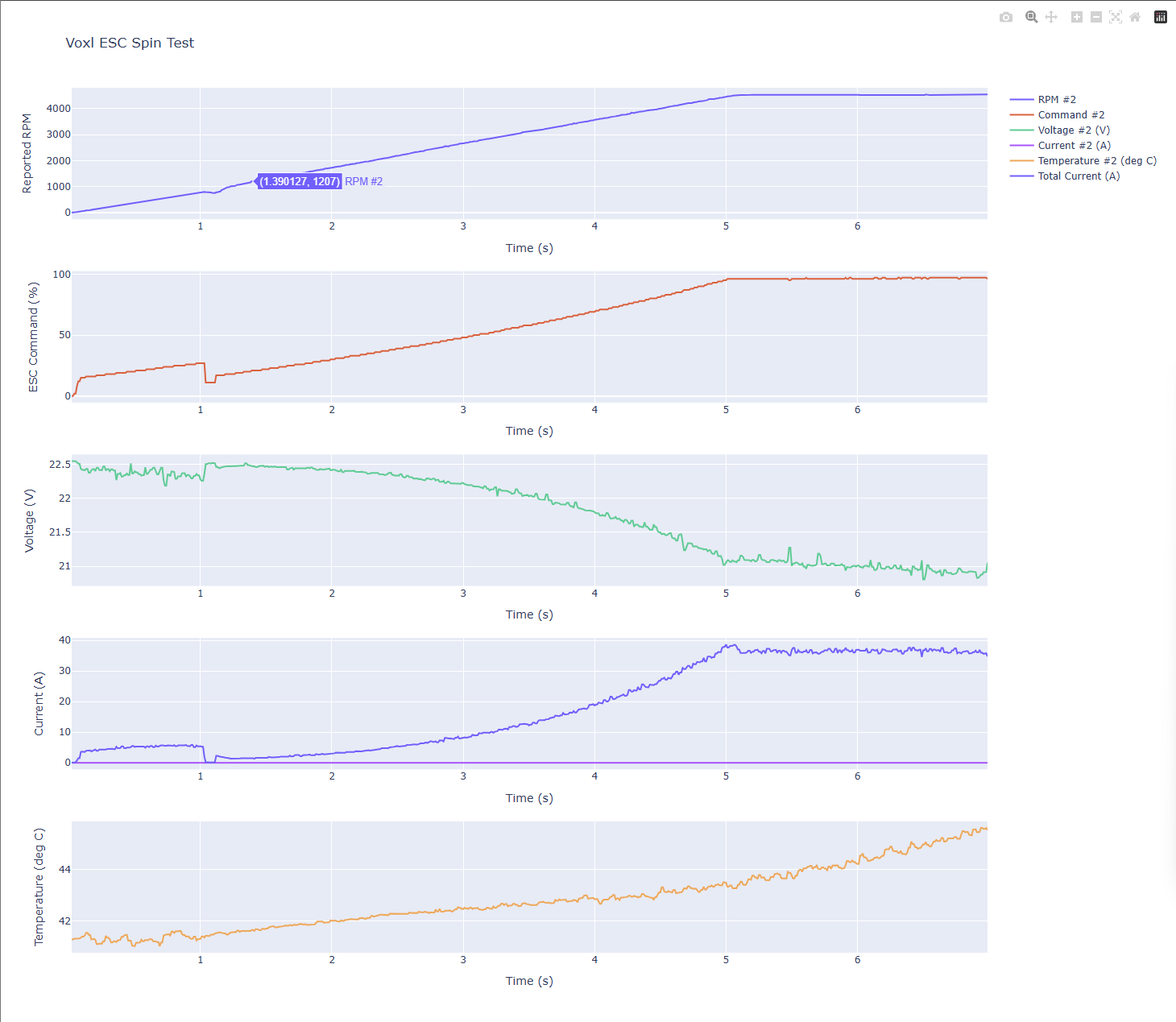

Using the FTDI cable on a linux PC did make a difference, however. I was able to tune!

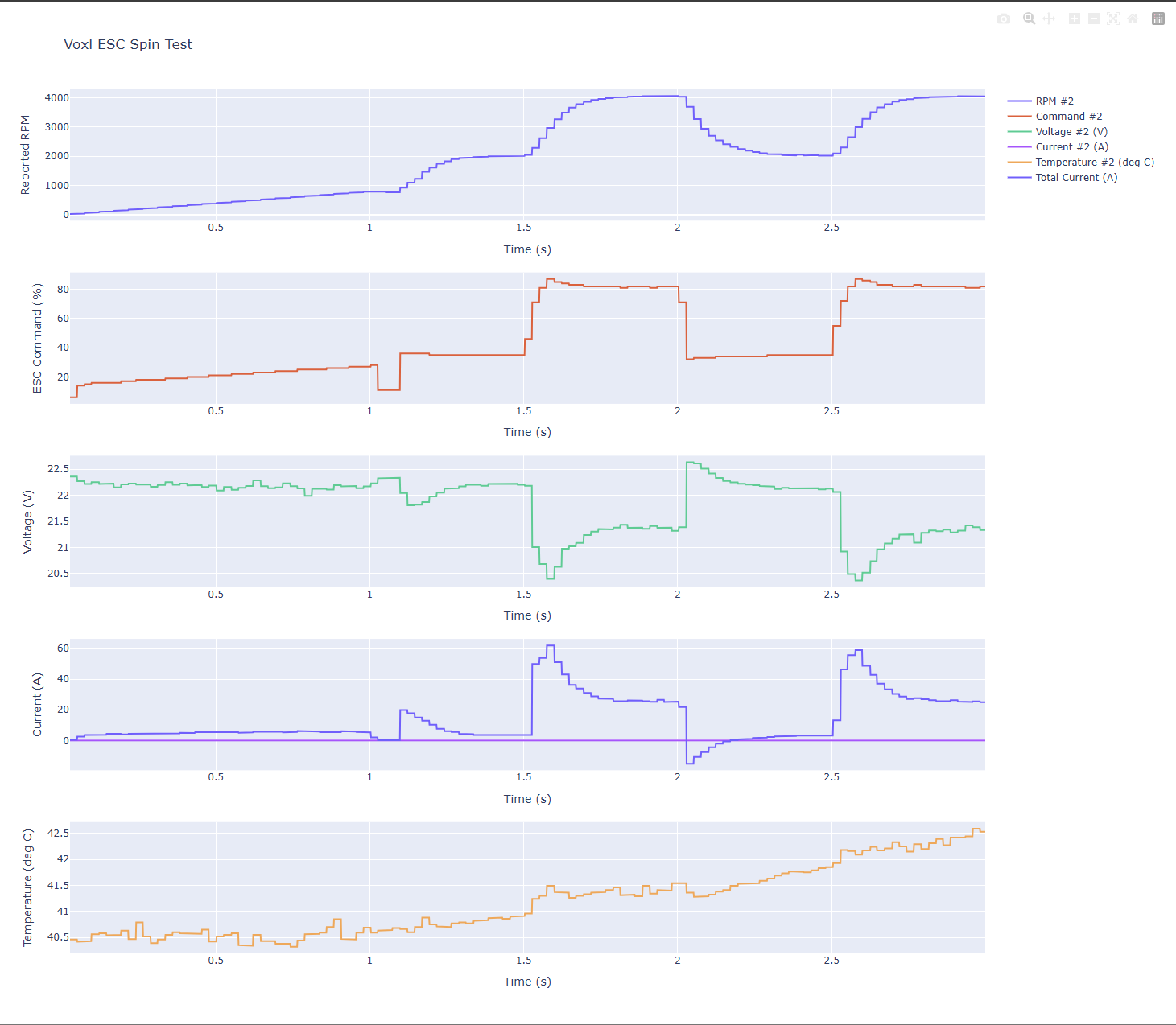

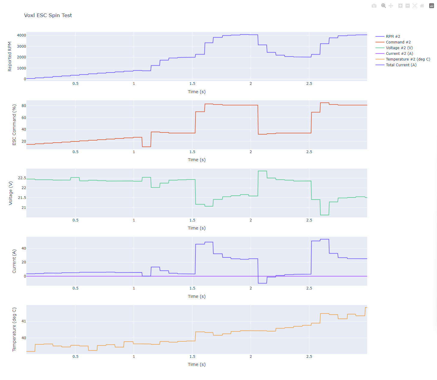

Interestingly, calibration and power ramp test both track the plots referenced in the documentation. that is, continuous curves were obtained. These images are:
However, the power step test and RPM step tests deviate significantly from reference in that they are not continuous.
I am running command provided from documentation, and obtain similar results for power/rpm
./voxl-esc-spin-step.py --id 3 --power 20 --step-delay 1.5 --step-frequency 2 --timeout 3 --enable-plot 1 --cmd-rate 250 --step-amplitude 30 -
./voxl-esc-spin-step.py --id 3 --rpm 2000 --step-delay 1.5 --step-frequency 1 --timeout 3.0 --enable-plot 1 --cmd-rate 250 --step-amplitude 2000

ShawnI raised the cmd-rate to 800 and noticed that curve sort of smooths out because the sample rate increased, which indirectly effects the plot granularity.
At this point, the graph resembles that of the reference graph in documentation. Would you agree with this or recommend further tuning?

Shawn@shawn_ricardo , just to close the loop on the original issue.. the delay in the calibration procedure was caused by UART data or processing of the ESC feedback backing up. The fix is to just slow down the command rate, seen in this commit : https://gitlab.com/voxl-public/voxl-sdk/utilities/voxl-esc/-/commit/b512f9e3d5e695868775de3d40eedb2ad15cf6d9 . Additionally, using command line argument
--cmd-rate 100when you run the calibration script on VOXL2 will fix the issue.Regarding the issue in the step response where the feedback data appears not smooth, i believe it is related to FTID's buffer / delay. FTDI adapters have this parameter
latency_timerwhich is 16ms by default, which amount of time the FTDI board holds the RX'ed data before passing forwarding it to the PC (and vice versa, i believe). You can set that value to 1:You can check this value:
cat /sys/bus/usb-serial/devices/ttyUSB0/latency_timerAnd set it:
sudo su echo 1 > /sys/bus/usb-serial/devices/ttyUSB0/latency_timerYou would need to do this every time you unplug / plug the FTDI device back in.
(note that this applies only to Linux PC, not VOXL2).
Besides this, i think the plots look good. It looks like you have set the kp pretty low, which keeps the response softer (less chance of de-sync).
